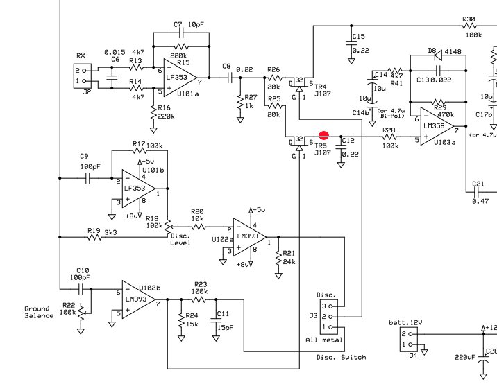

                            If you do not have a scope then try this ->
                            1. Set the ground balance pot to its middle position.
                            2. Set the discriminate pot to minimum.
                            3. Connect the multimeter to the source pin of J107 (as shown by the red dot in the image below) and measure the DC voltage.
                            4. Adjust the coils to give 0V DC at that position.
                            Get as close as you can by positioning the coils, as you will still be able to adjust this with the ground balance pot.
