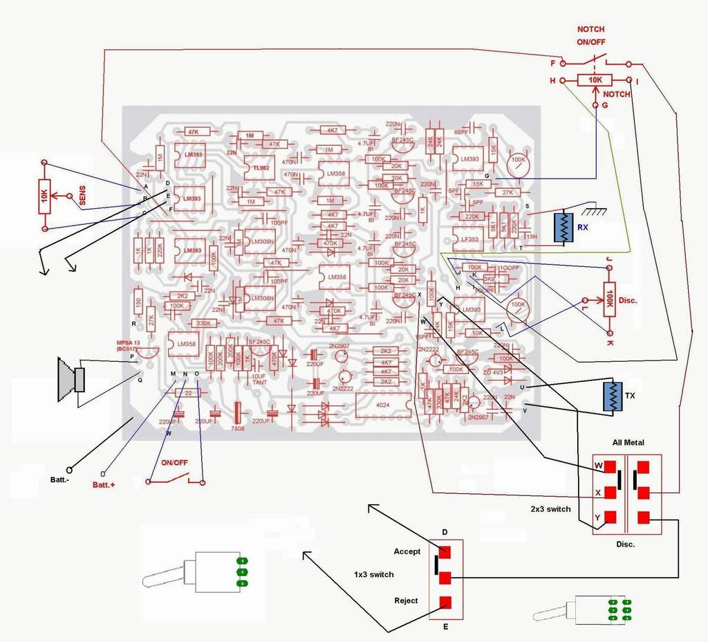

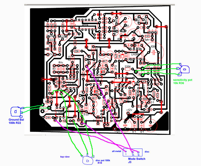

                  • hi guys
                    can anybody help me and draw a connectings of pots and switch? i would be very hapy...best regards to all

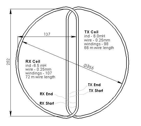

                      • TGSL DD Coil - 10 Inch Model (Complete Winding Details)
                        @pip3c has kindly redrawn a Printable Mold Pattern with AutoCAD according to @Ivconic's Tutorial in PDF-Format (Scale 1:1).
                        Originally posted by pip3c View Post
                        See Original Post --->
                        Note:
                        I have only slightly Edited this PDF-File by Deleting two unnecessary Pages; One Blank Page, and one Page with Creation Data from PDFCreator Version 0.9.5. The Printable Mold Pattern (Scale 1:1) has been left unmodified.
                        @galaksi has supplied a JPG-File with the 10 Inch DD Coils Winding Data.
                        Both Files have been added as Attachment into a single RAR-File.
                        Robert
                        TGSL DD Coil - 10 Inch Model (Complete Winding Details).rar
                        Contains the following two Files:
                        TGSL DD Coil - 10 Inch Model - Mold Pattern (1-1 Scale).pdf

                            • Originally posted by lunamay View Post
                              hi guys
                              Maybe this helps. Others can correct it if wrong.
                              If you don't like the direction the pots turn, just reverse the two outer connections.
                              This is for TGSFinal PCB.
                              -SB
                              P.S. It would be good to add a better drawn similar diagram (with coils, speaker, power supply added) to Qiaozhi's TGSL Complete Details thread.
                                hi guys
                                And this one in case you're building the TGS version
                                regards ,
                                Dennis the Mennis
