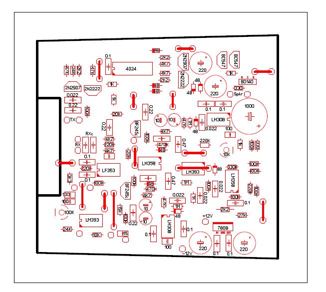

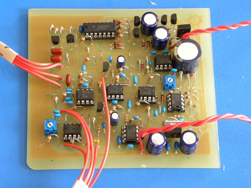

  • Hello, I'm trying to build the detector tgsl and I have some doubts.
    In the image a look of some transistor to one side and two in the picture look the other way.
    In that image the position of the transistors is correct?

        I always check components before installing them with a multimeter. If you do not have a multimeter look at the case type of the transistors you are installing against the spec sheets and compare that with the schematic.
        Even if I'm sure that I am installing things the right way, it's nice to know that the components that you are installing are working beforehand..

          Always try to read the data sheets of the components.
          I'm making as in the first image. Why the second transistors are placed in a different position?
          Too many versions that although the model and see if I can not be trusted. Have contradictions.
          Do any of the two images is valid or not valid any?

            2n2907 and BC547 have collector/emitter on opposite sides according to datasheets. So probably correct if you use those exact parts to be opposite.
            May depend on whether made in Europe or US too.
            Wait, now I see what you mean. 2n2907 and 2n2222 are drawn backwards on the layout drawing for US parts. (However, may be correct for European, I'm not familiar with those.) So I think the photo (bottom image) is correct (for US parts).
            But check schematic, don't rely on shape of parts.
            It would be good to add c,b,e labels on transistors in layout silkscreen side.
            -SB

                  Handy, thanks. And PCB needs e,c,b labels to match.
                  -SB

                    Finally I think I know the pins of the transistors if I'm not confused. I looked at the schedule for hours. When building the test coil and hope it works.
                    I am from Europe and America may change the pins in some transistors on the Europeans.
                    If anyone is encouraged to investigate different types of transistors in parts of the world and put it in this forum would be very useful for beginners in electronics.
                    Greetings

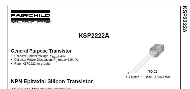

                    • dfbowers [quote =; 111294] .. Caso TO92 Tiene Aquí. [/ Quote]
                      El transistor utilizado para mí es esto y parece que el transistor 2N2222A.
                      ¿Tendré problemas con el transistor KSP2222A?
                      • Use this.
                        Grt Nakky
                        http://english.electronica-pt.com/db...ef=BFR&page=10

                          I have it installed.
                          Not worth the ksp2222a transistor instead of the 2N2222A transistor?

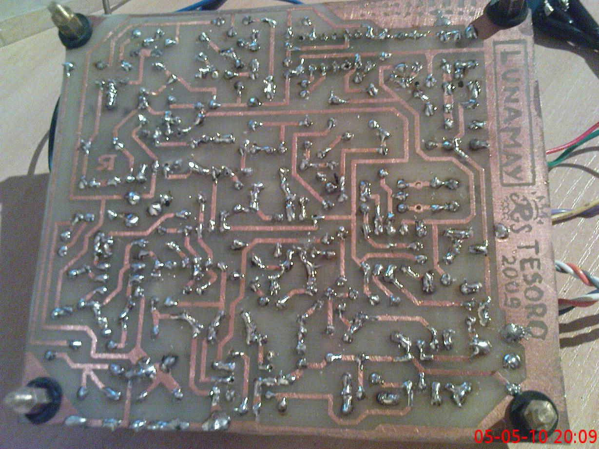

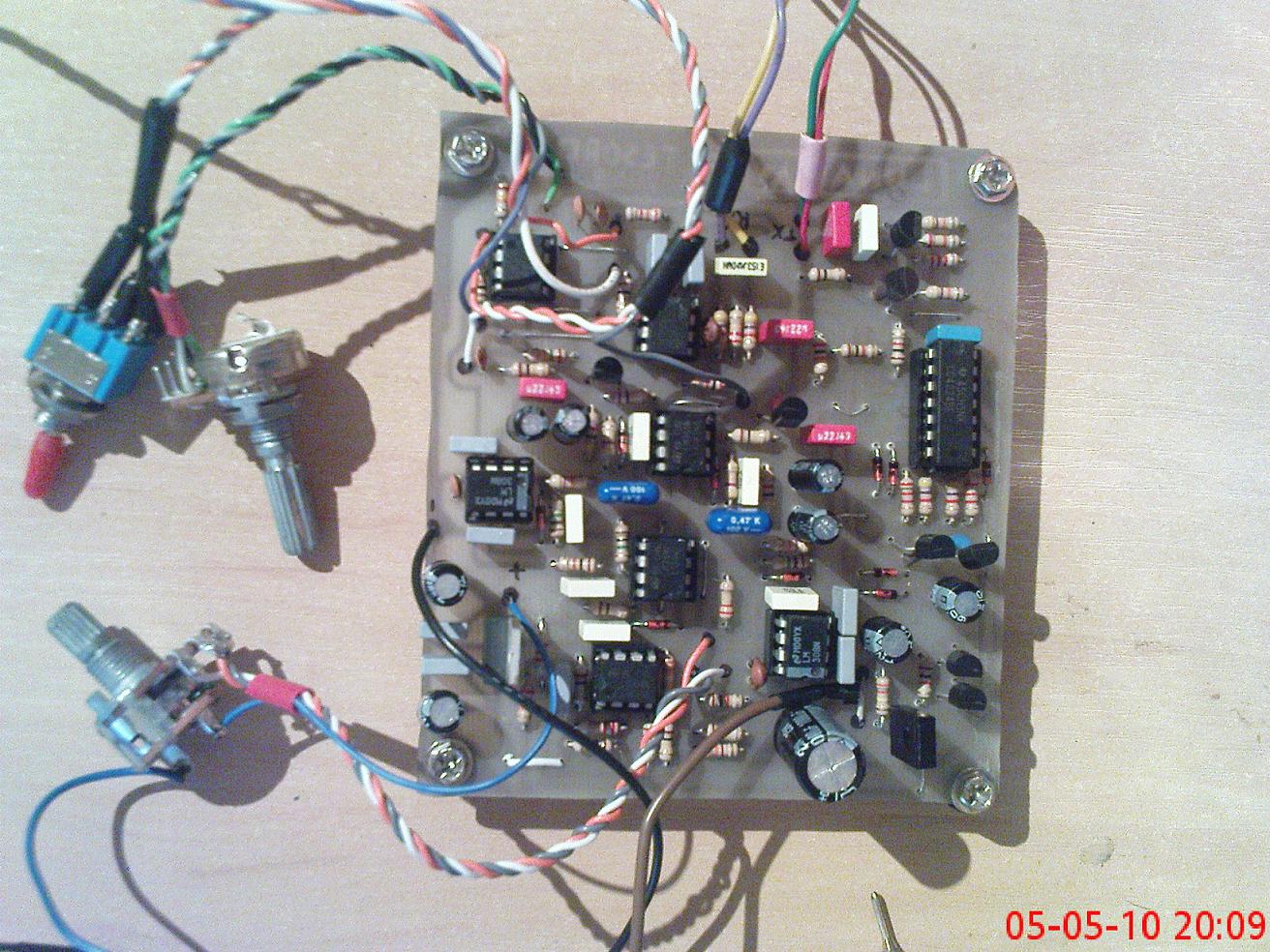

                          • finaly some photos
                            with special thx for simonbaker

                              • Originally posted by lunamay View Post
                                finaly some photos
                                It looks very nice. I congratulate anyone who finishes one of these babies, including myself on the rare occasion. Looks like you put the GB pot on the outside, I'm usually lazy and use a trimmer on the PCB and don't adjust it much later.
                                I think you made the TGSL Final version, correct?
                                TGSL Tuning & troubleshooting thread is another good one to continue with any detailed questions and problems. Keep us informed how it works and any progress.
