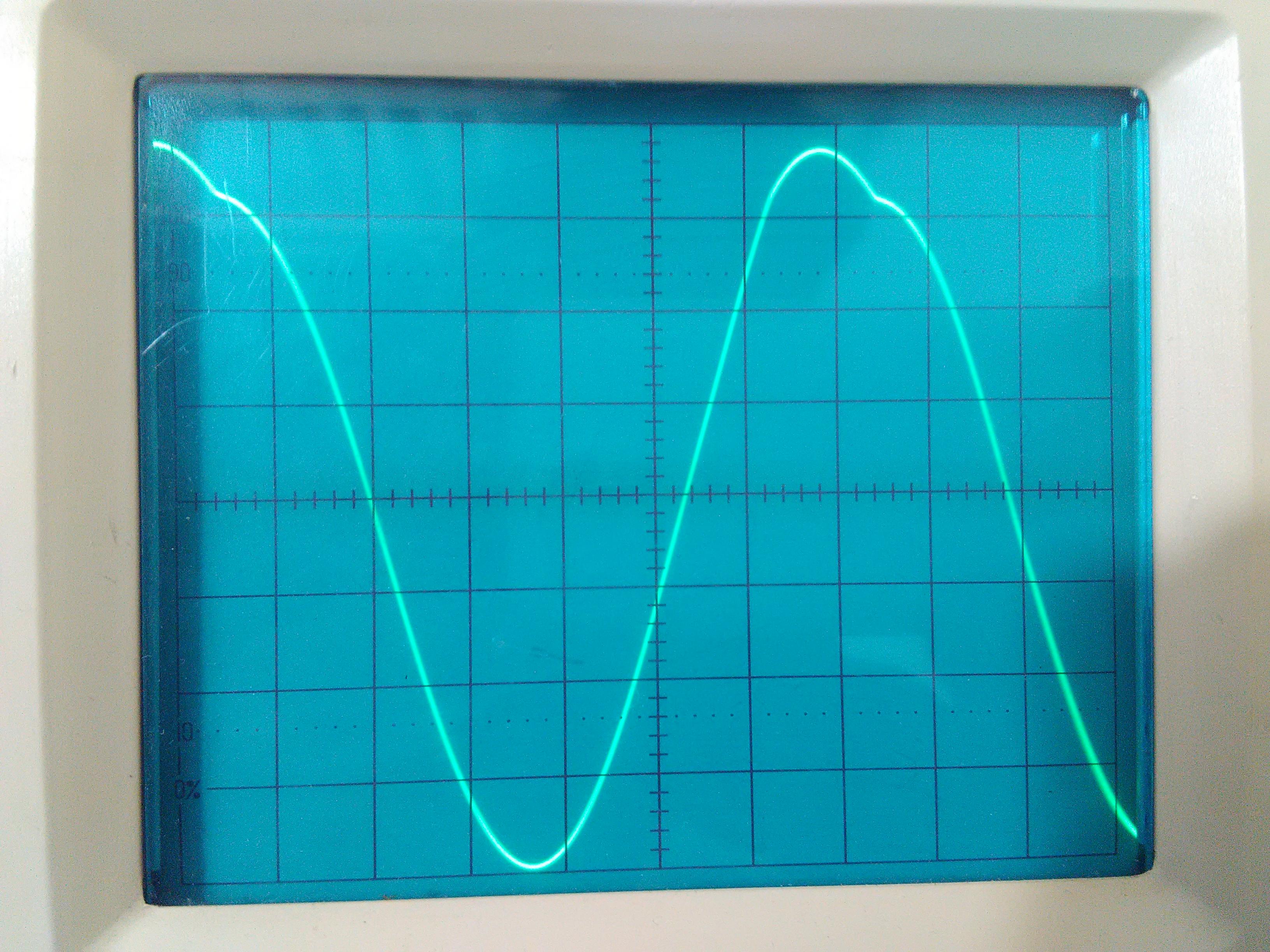

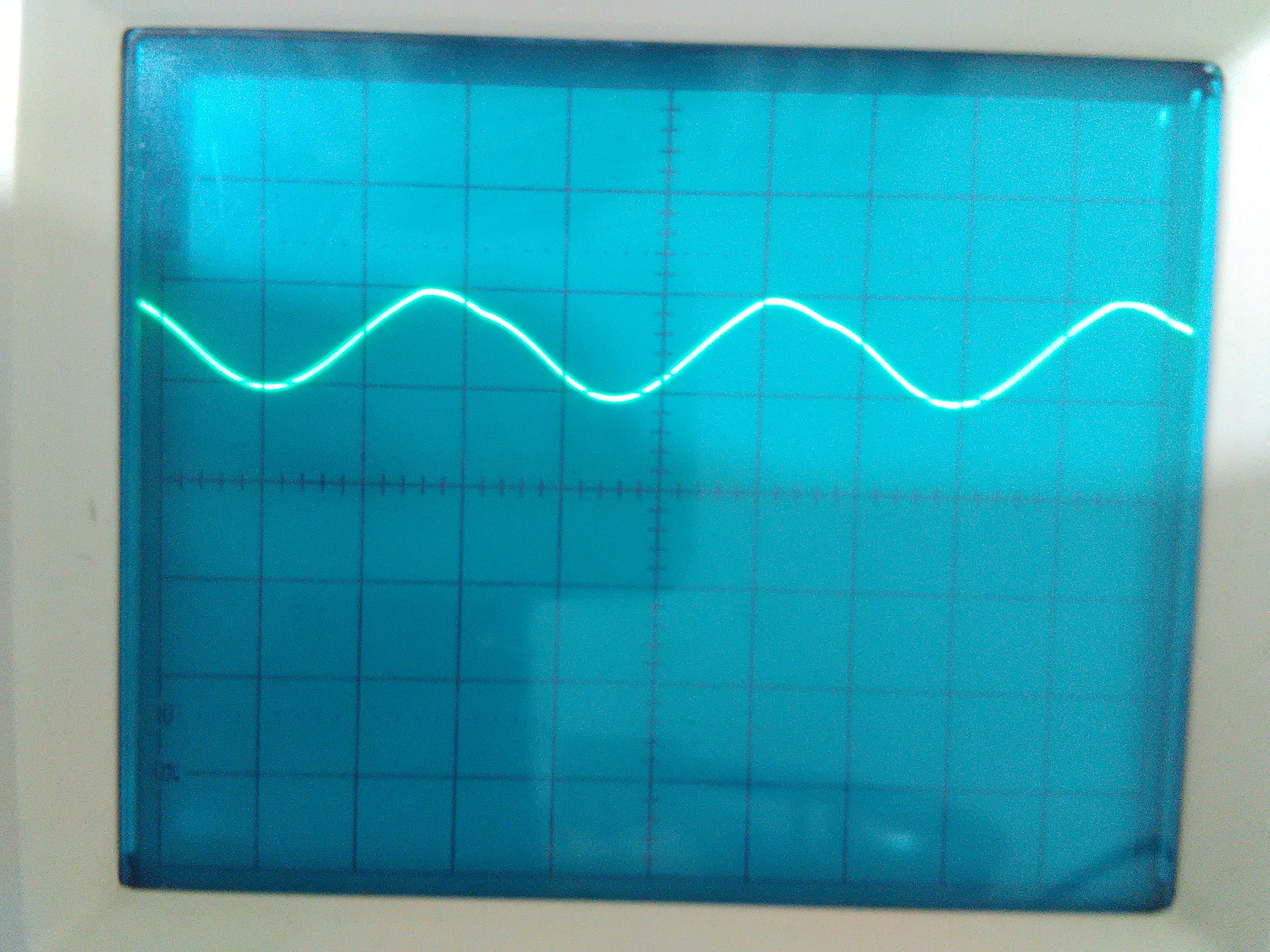

                i think i discovered the problem somewhere
                take a look at these pictures:
                all signals reference is at the middle X axis of the scope screen.
                disc pot and GB pot connected but disc switch is not connected
                1- TX signal (2v/div , 10us t/dev)

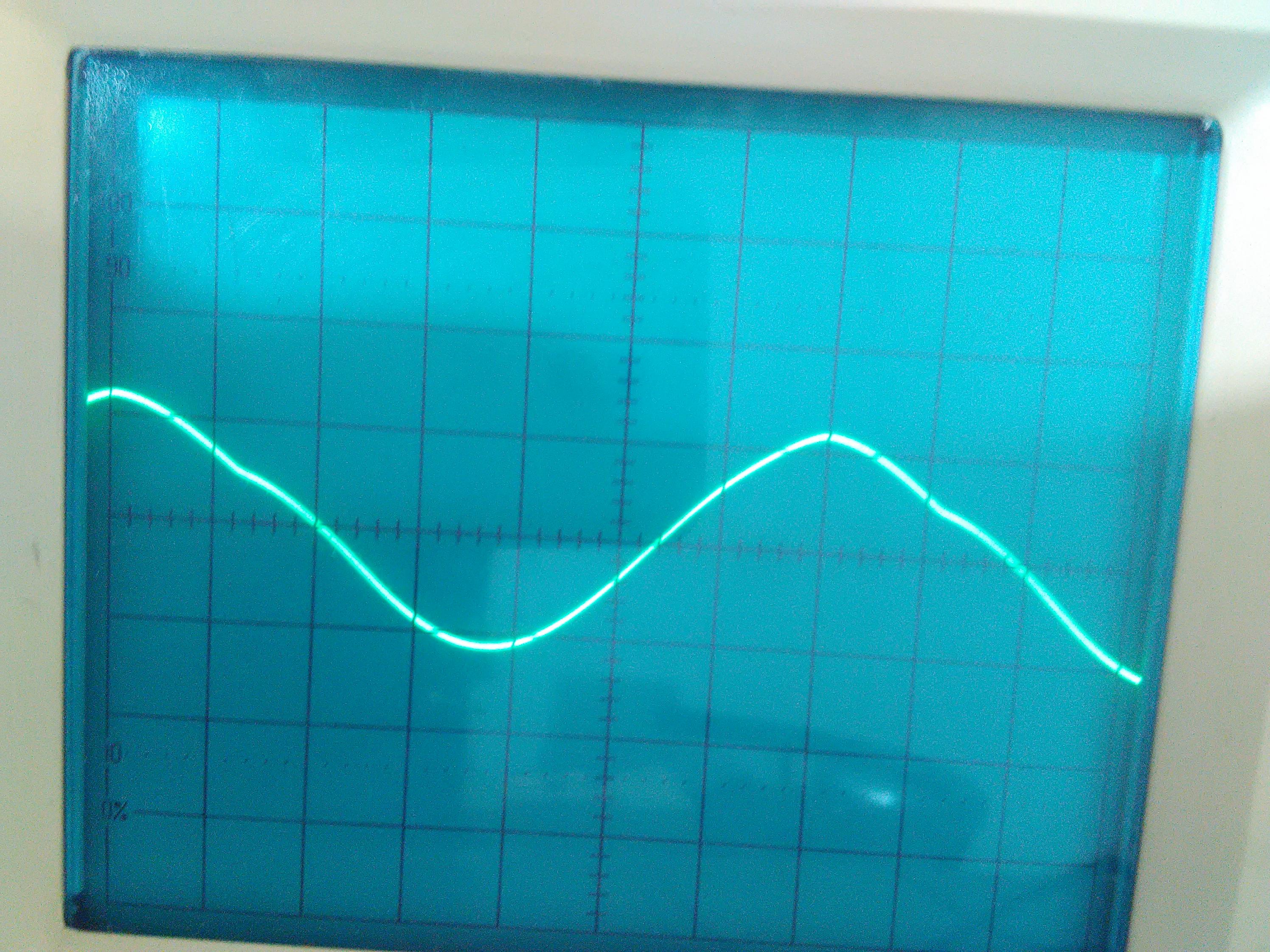

                2- U102(LM393) pin 6 which is inverting input , GB pot at mid range (2v/div , 10us t/dev)
                output of GB section is clean square wave for the Jfet(TR5) , no problem

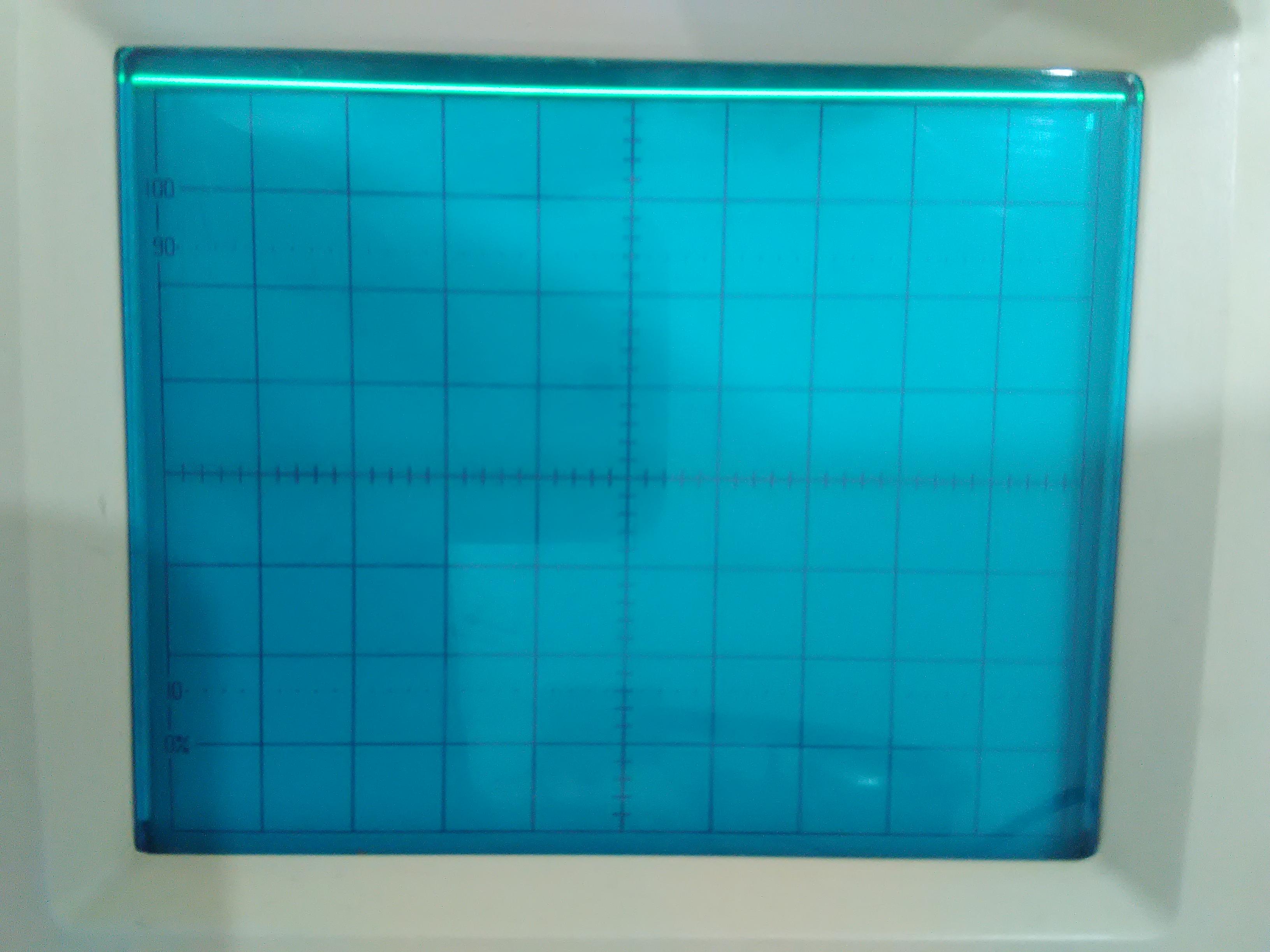

                3- U101(LF353) pin 6 , the problem (5v/div , 20us t/dev)
                actually i accidentally switched the first op_amp of LF353 with second one when i was designing the PCB, my bad but it doesn't effect anything, does it??

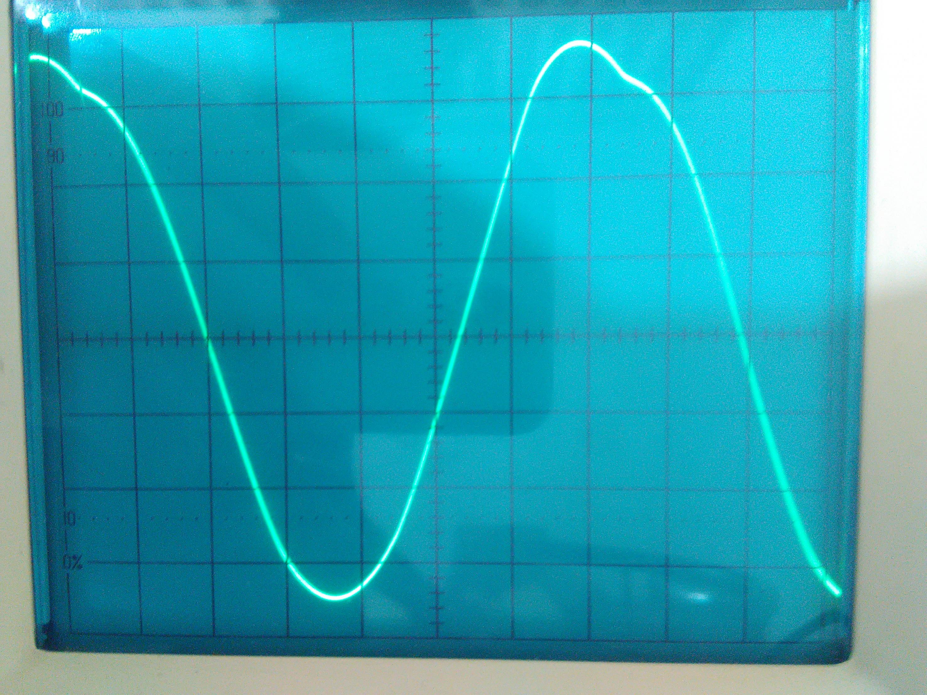

                4- middle pin of 100k disc pot, at min (2v/div , 10us t/dev)
                it's simply the TX signal from that 3.3k resistor

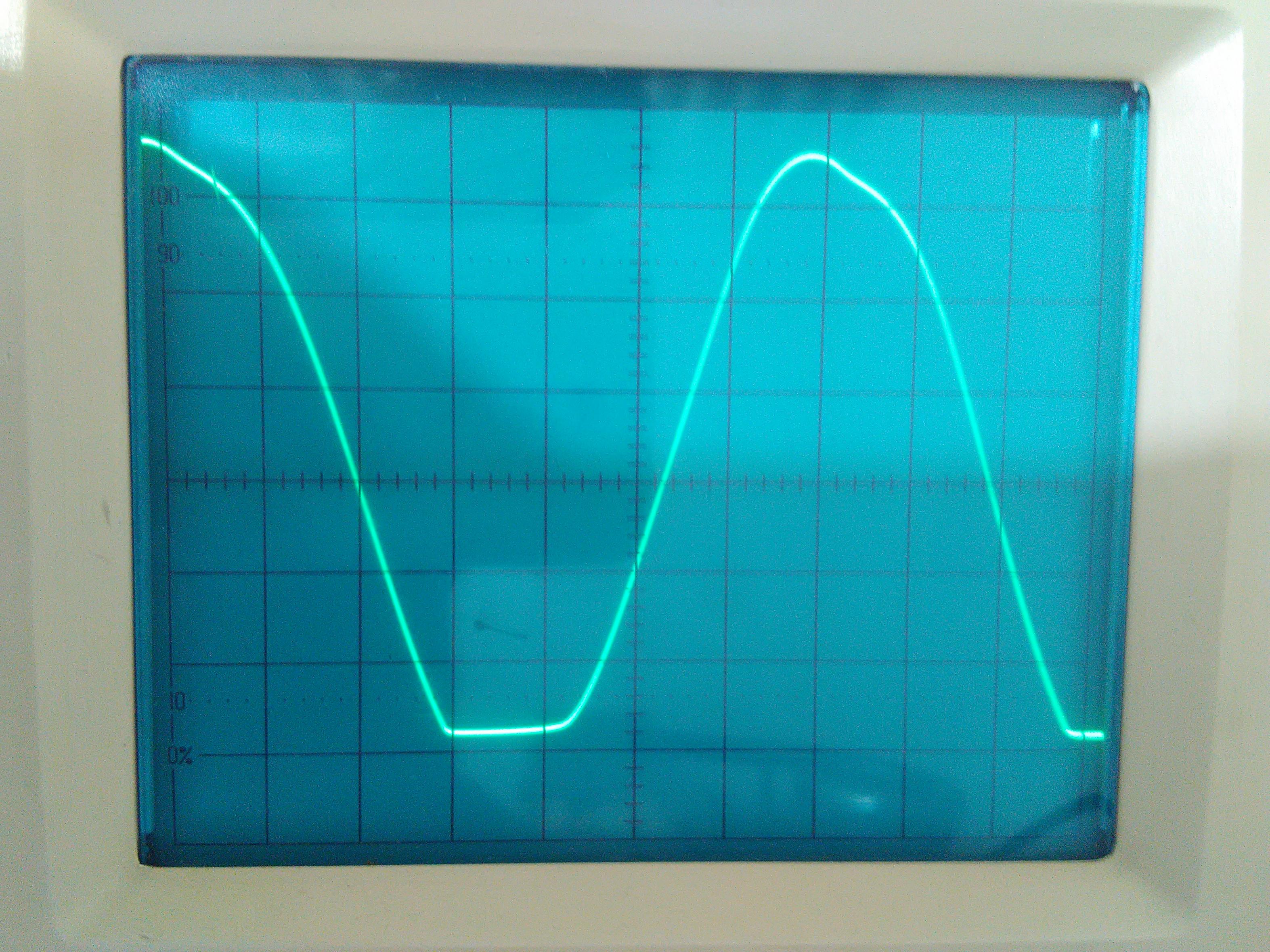

                5- U102 pin 2 which is the inverting input of comparator (2v/div , 10us t/dev)

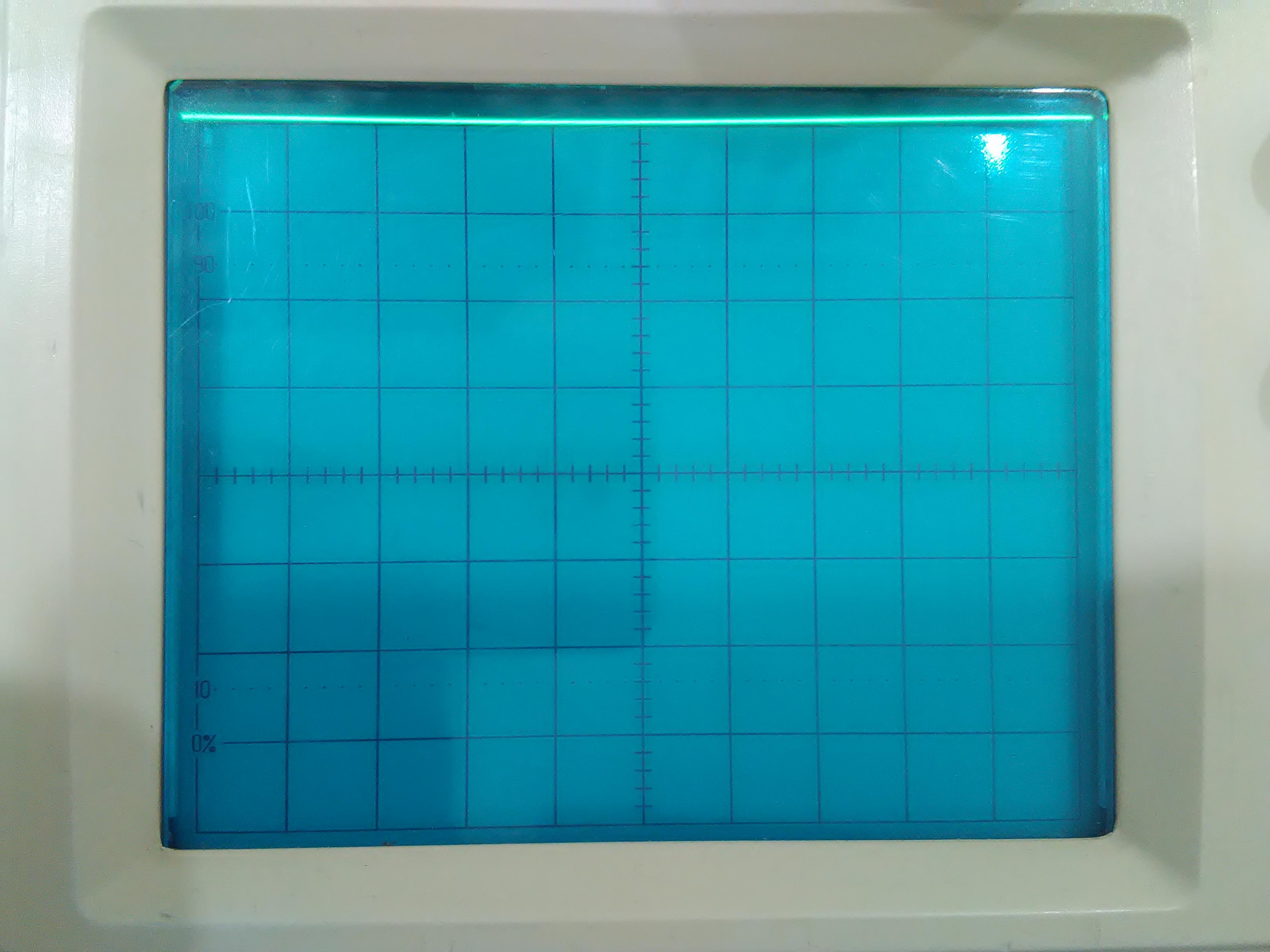

                6- U101 pin 7 , this is the problem for that flat DC voltage (2v/div , 10us t/dev)
                7- middle pin of disc pot, at max , obviously it feeds that DC signal form U101 into next stage(comparator) when i turn the disc pot to MAX and cause the problem (2v/div , 10us t/dev)
                and to notice i used PN4391 instead of J107 , at that time i only found this FET and didn't know about BF245 so maybe i would change it in advance

                        no problem accept can confuse us if you only state U101-7
                        [ATTACH]49466[/ATTACH]
                        This is a problem and why Disc pulse changes level.
                        Check for bad soldering, shorts and layout. Does this chip have -6V on pin 4?
                        The PN4391 should work and is not the current problem.
                        • Taddaaaa I finally got it
                          when i was checking the U101 input and output , i realized that the pin 7(the original pin 1) and pin 8 are shorted!!!
                          i noticed the chip(LF353) is getting too hot , but i thought it is normal(yes i'm being dumb sometimes)
                          after refreshing all the solder joints i carefully followed the traces around inputs and output and find out that the stupid PCB manufacturer has joint the pin 7 and 8 !!!
                          because these two traces are a bit close to each other but not out of spec of the manufacturer, they told me they can etch down to 0.25mm at minimum , and my design was about 0.5mm !
                          the joint was extremely thin and somewhere very unreachable...
                          i ruined my 100k pot when i was trying to change it, it's a bit touchy but i saw the correct waveform for a second and i'm sure it's okay now, but couldn't capture it
                          i'll buy a new one tomorrow and test everything, hopefully it'll be fully functional, i'm pretty confident
                          so yeah fortunately it fixed, well thanks to you great people , i've learned a lot here just within a few days
                          truly you guys are some of the must helpful and useful people on earth, thank you very much for lessons
