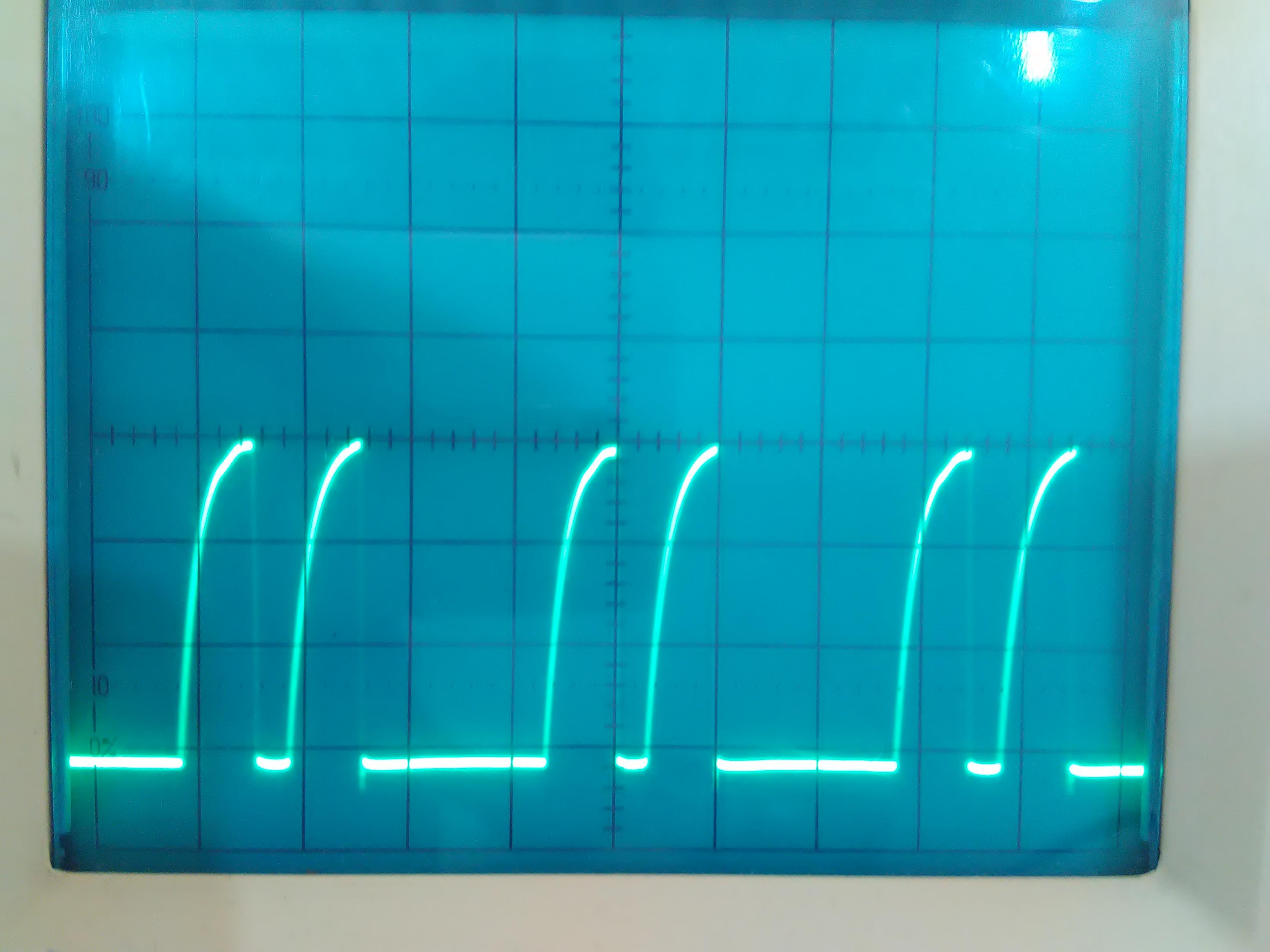

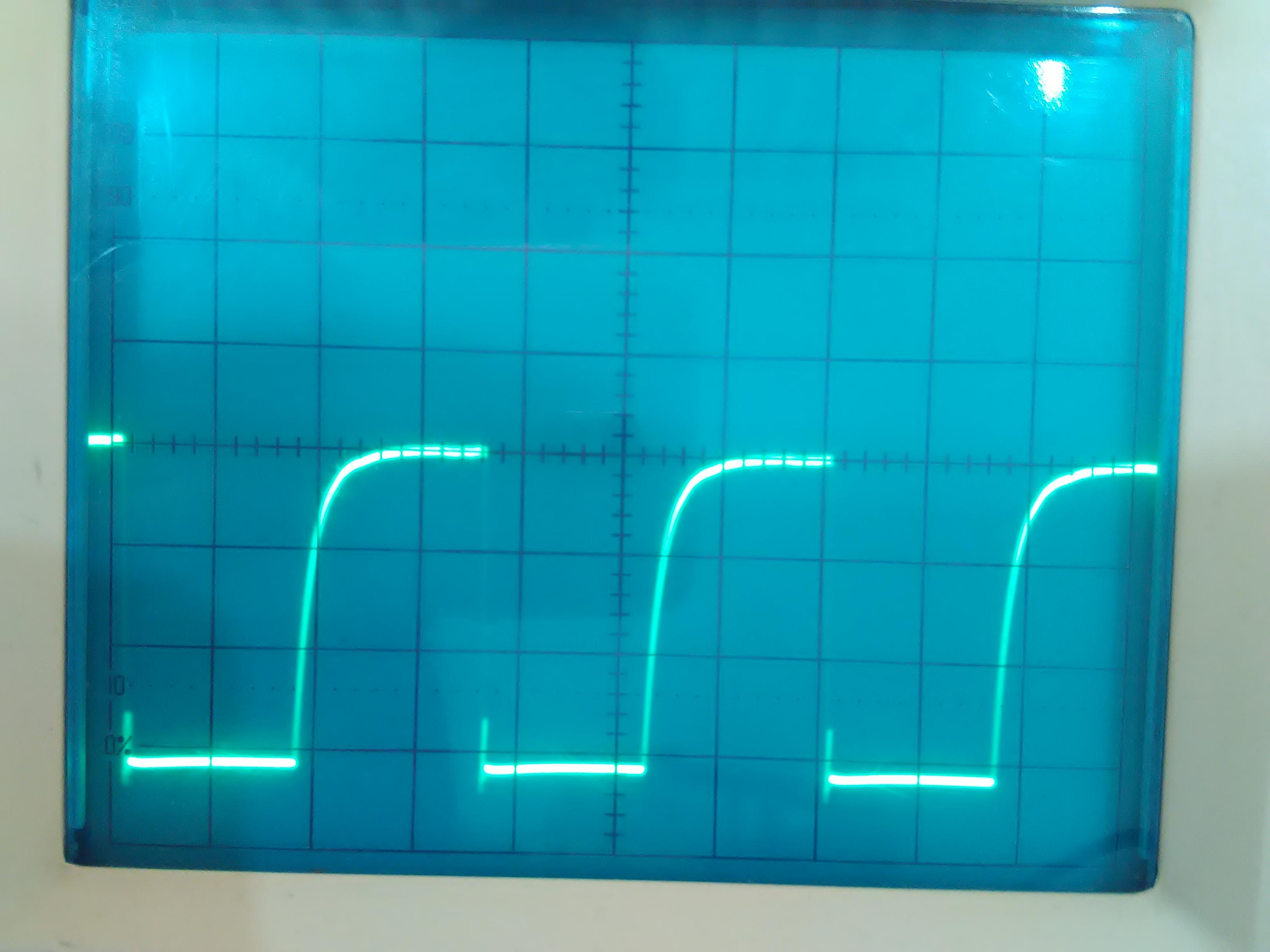

    • hello friends
      i'm back again ,sorry
      i can't reject ferrite with my tgsl
      i've done whatever i know that could be effective
      everything just looks perfect
      take a look at these
      scope set up for all pics: 2v/div , 20us t/div
      1- pin 7 U102(gate of tr5) , GB pot min

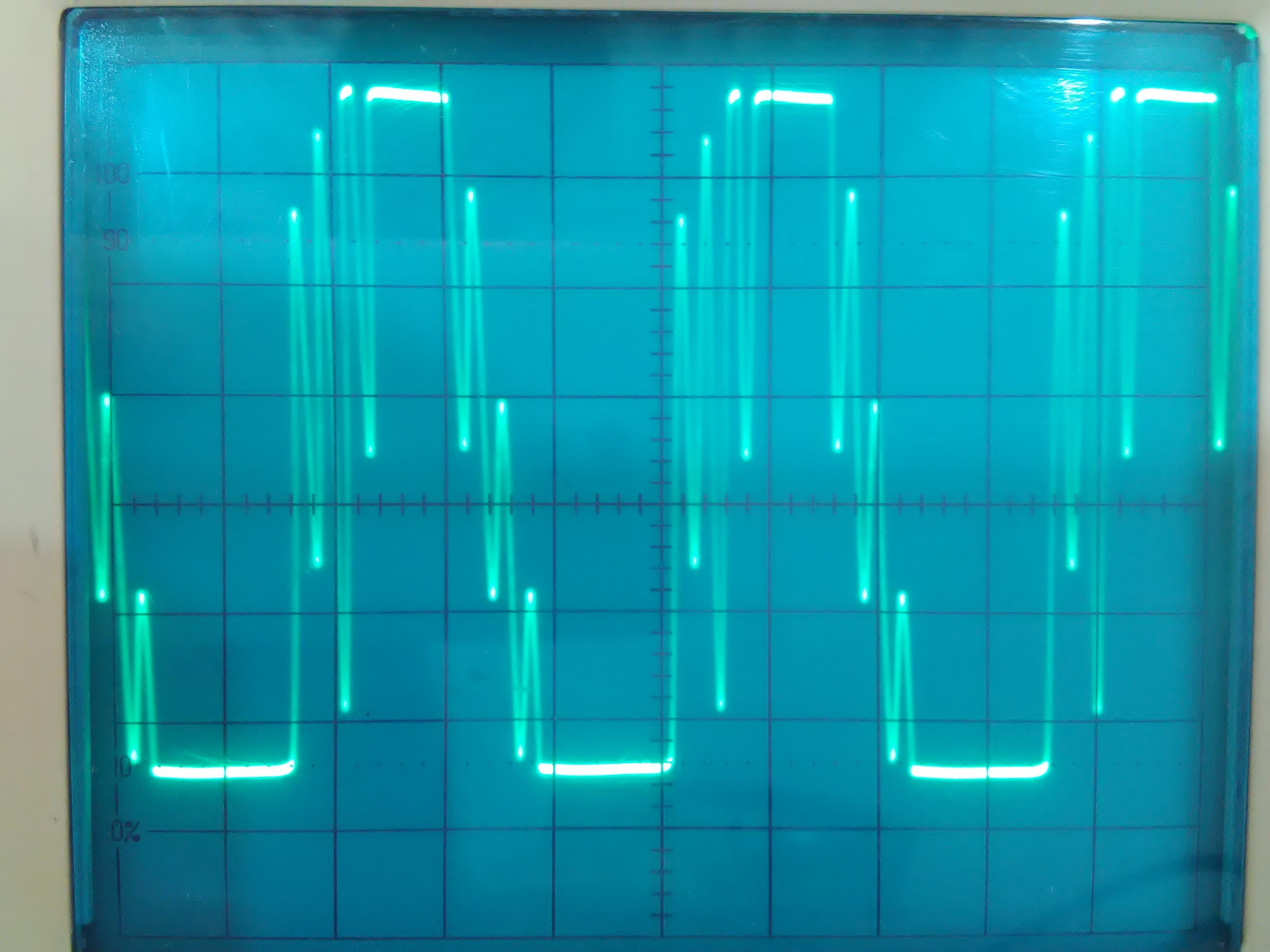

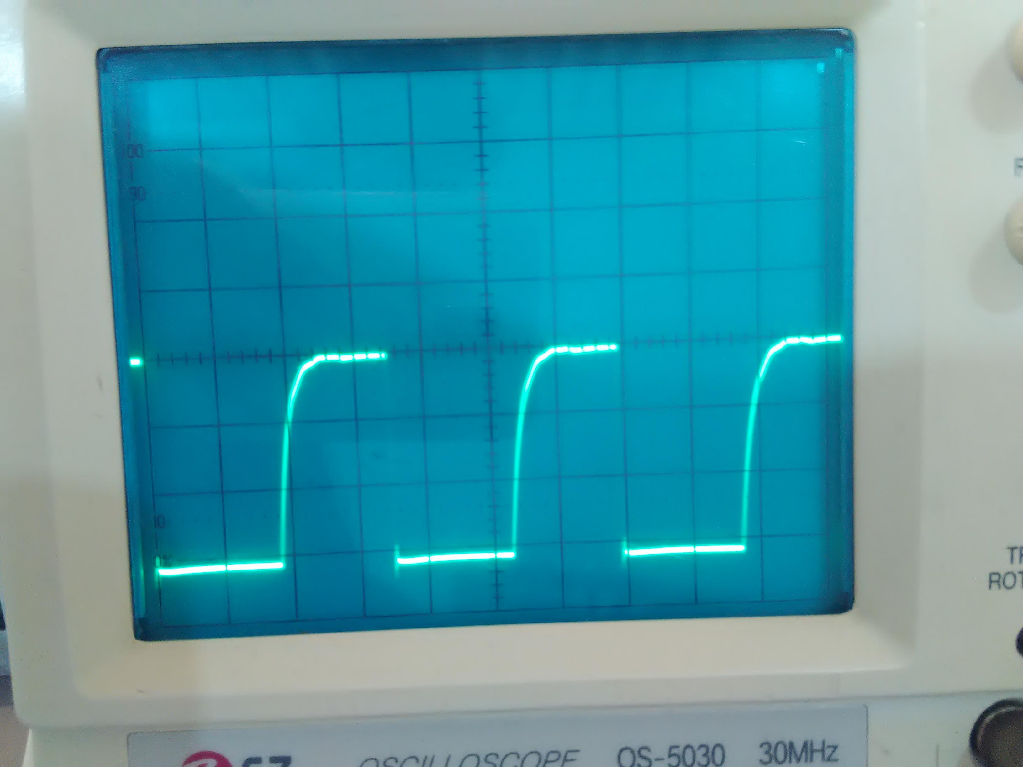

      2- pin 7 U102(gate of tr5) , GB pot max

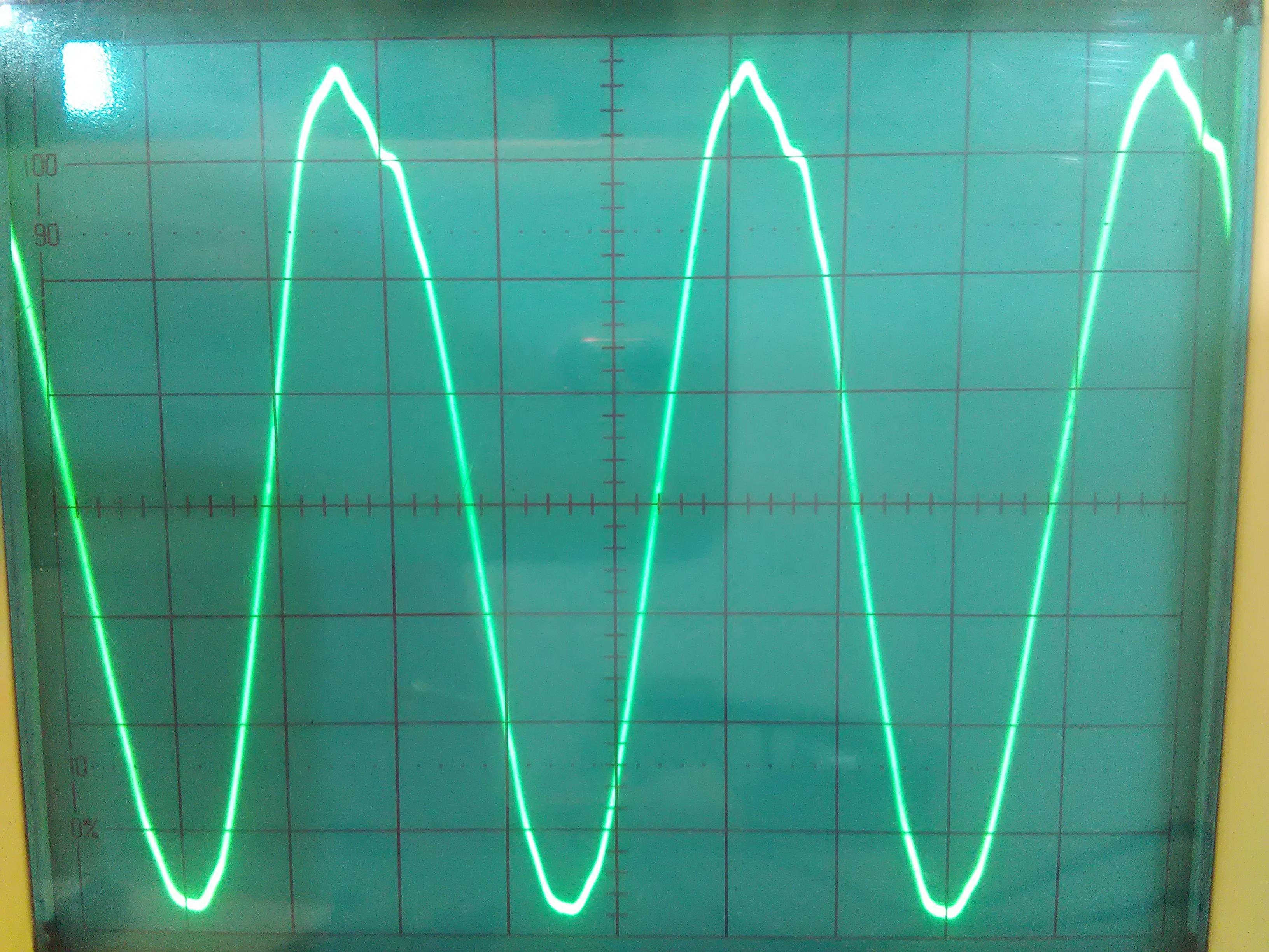

      3- mid leg of disc pot(min)

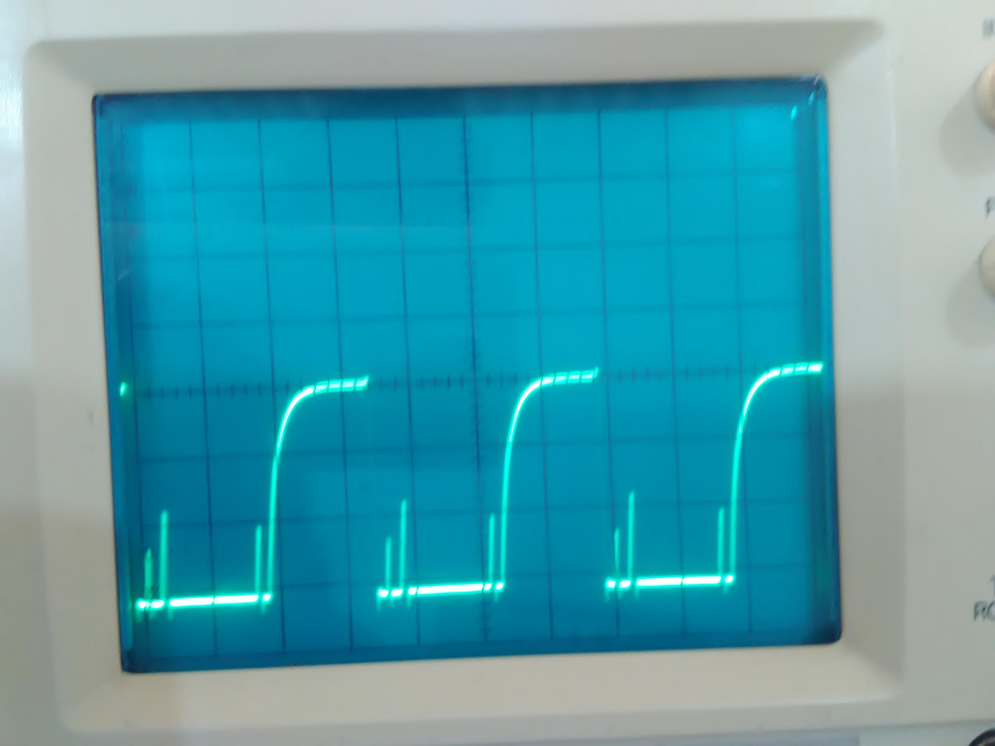

      4- mid leg of disc pot(max)

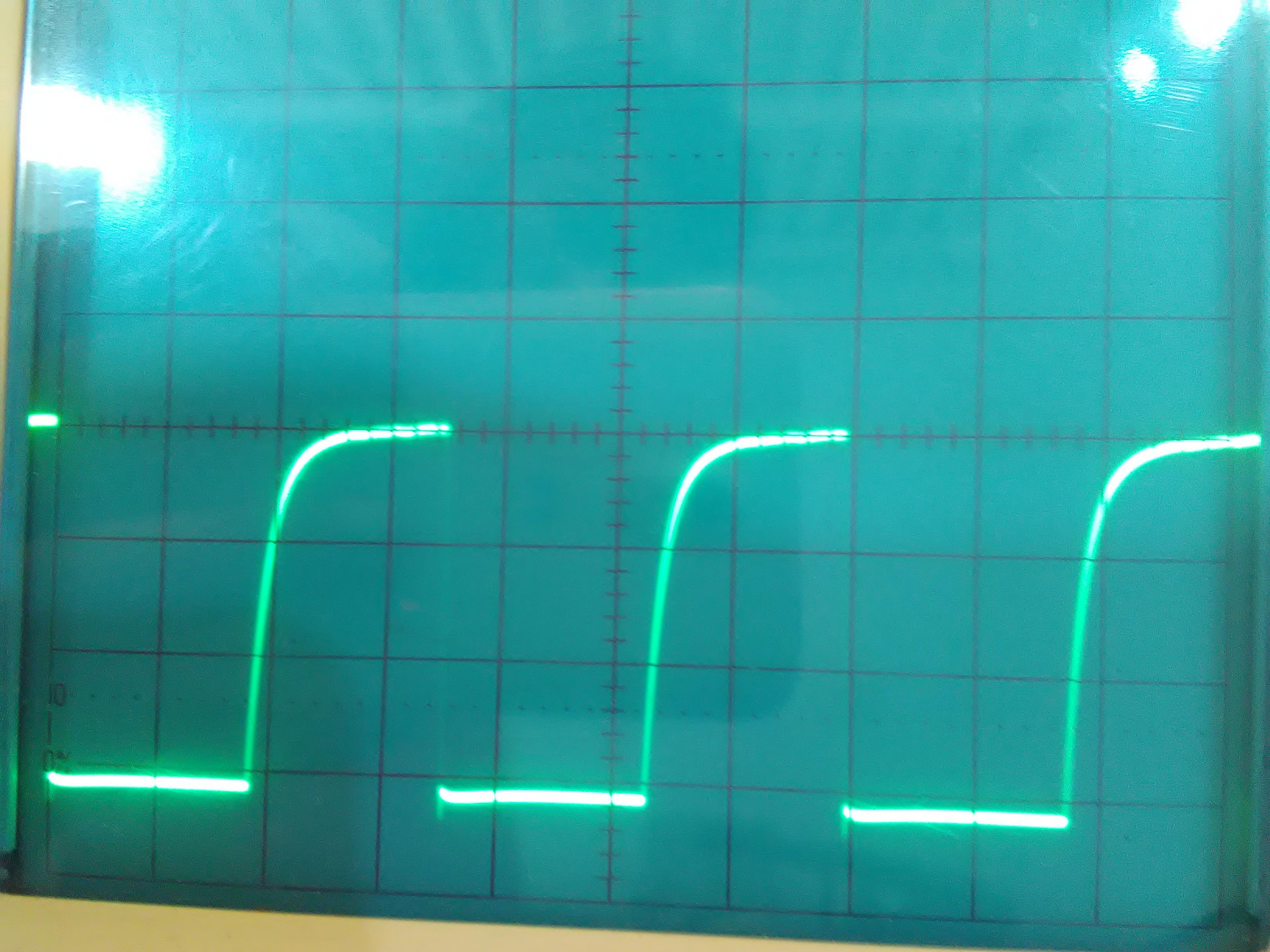

      5- Gate TR4 disc set at min

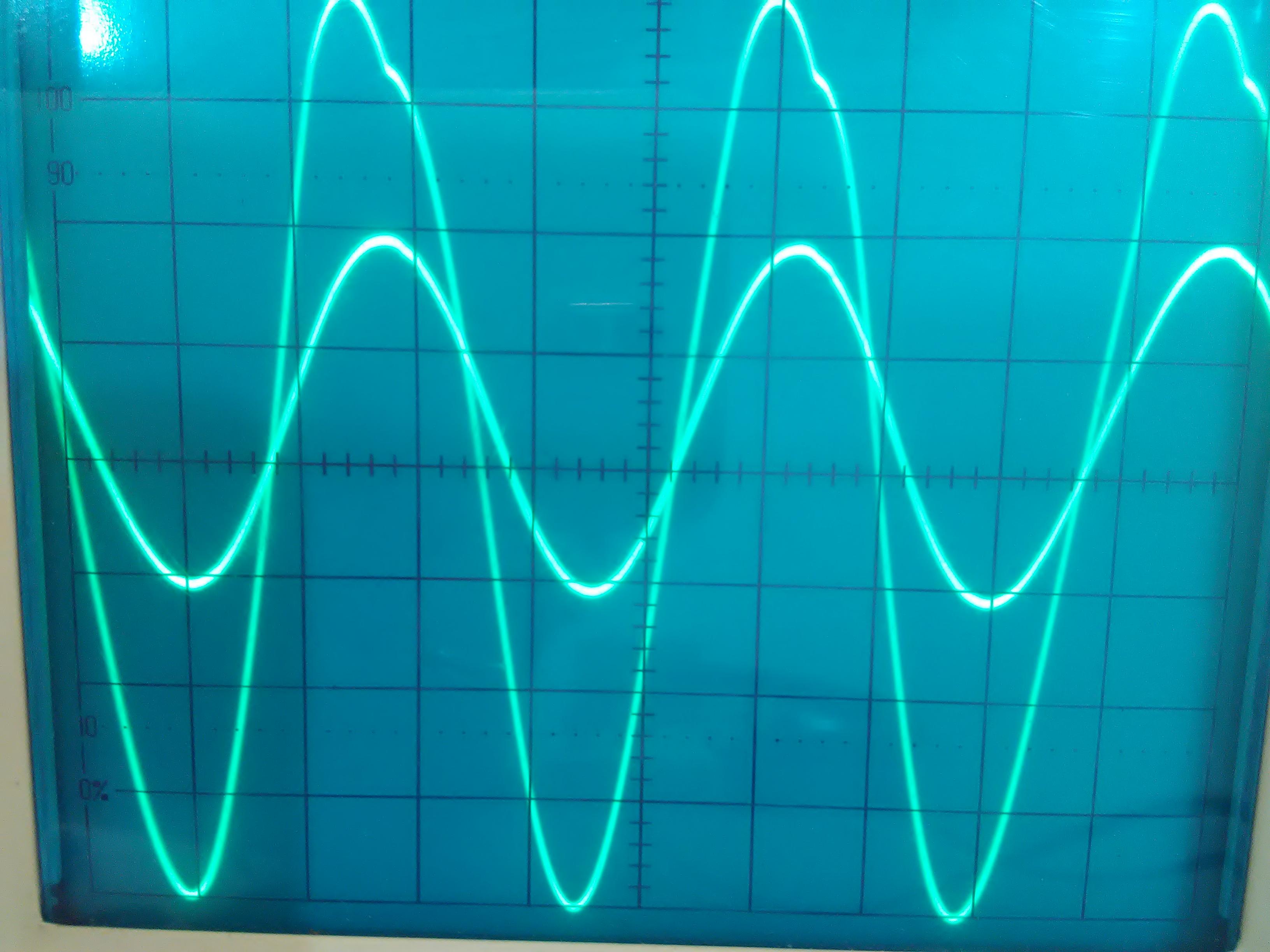

      8- TX vs RX(output of pre-amp U101)
      TX 2v/div and RX 0.5v/div
      as you can see nothing is wrong here, i don't know where is the problem... i've tried many different null positions for coils, but nothing
      the project looks at my eyes, smiles and says "that's not gonna happen buddy"
      • Scope waveform look ok but best if two scope traces are used. First on TX and then the other.
        This is because ALL are relative to the TX signal and why it is called "synchronous detection'.
        What are you using as the Ferrite sample??? There are Many different kinds and sizes of ferrite and not all can be used.
        I use small thread cores from RF coil salvaged from very old radios. Some of the larger ferrite I have is never rejected.
        Also, the adjustment of the GB pot is very, very sensitive. The tiniest movement can be too much.
        What does the Coil RX Null look like?? We need to see RX at output of Pre-amp relative to TX to judge Phase shift and amplitude.
        Look at Dbower's TGSL 101.pdf Scope pictures for examples.

          i use toroid ferrites , new ones for power supply coils ,28mm
          the tx vs rx was spouse to be the last pic sir , i forgot to share
          here it is
          the trigger source in scope is VERT not CH1(TX signal) , is that ok?
          • Add 1nF in plus for the Rx circuit and it will shift a bit the Rx. Theoretically the Geb phase shifter can do 45deg of phase shift, maybe your Rx signal is not in the range of that. No component is perfect so it could have only 40deg phase shift that could be a reason, it worked for me.
