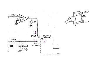

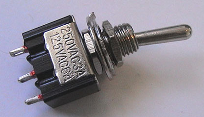

    this's the part i talking about,because i want to know what i say to the seller when i buy it,and how connect it to the circuit (a detailed drawing),plz help
    Hello Hazem
    what you see is a switch, point 2 selects point 1 or point 3 ...
    • Originally posted by hazem View Post
      ApBurg has beat me to it. (Doh I get slow after I've taken 10mg of my favorite sleeping pill.)
      The schematic artist has represented a switch with the symbol for a connector.
      By the way, you will also see some drawings where potentiometers are also represented with a connector symbol. That can be confusing also.
      To explain the switch I refer you to section of an older specimen of the TGS schematic. I added numbers to correspond to the pins in your drawing.

        • Just go into the shop and ask for a single pole 2 way toggle switch to the phisical size of your requirements.

                                No apology necessary. It's your doggone creation and you can draw it any way you have to. Ummh by the way, a big thanks to you for the project. A major success.
