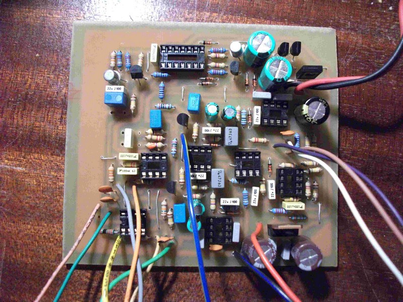

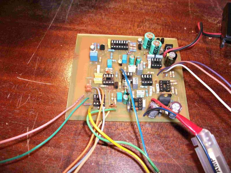

  • COMPLETA tgsl. Falta y reel Construir en breve la Falta de Circuitos Integrados. Espero Que funcione de Cuando Usted Toma la BaterĂ­a.

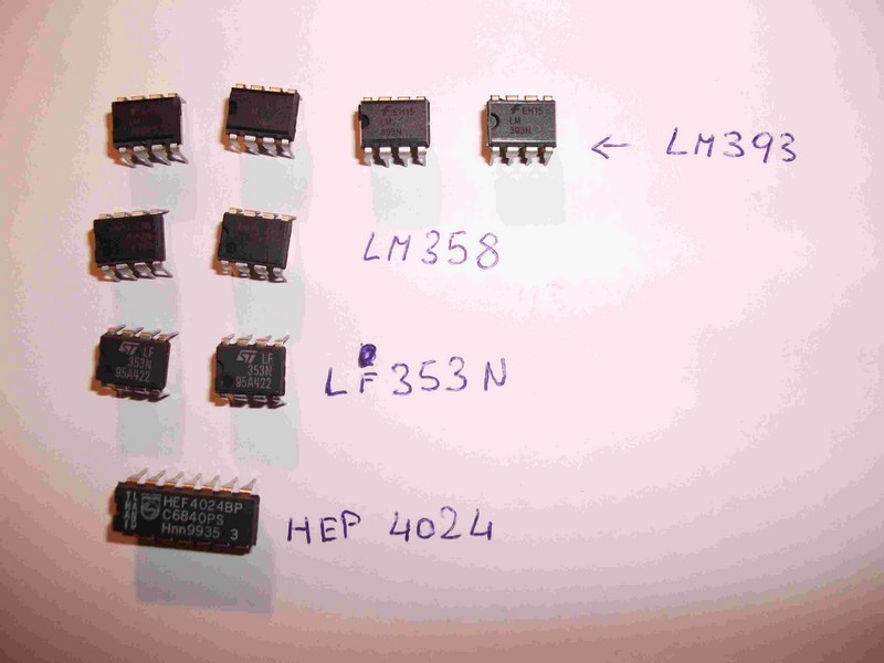

      You may try Mouser Electronics; www.mouser.com for the Chips, but they may still not have the LM308 in stock.
      LM308 on eBay for US $1.00:
      http://cgi.ebay.com/NEW-ICS-LM308N-L...-/350302027307
      or here:
      http://shop.ebay.com/?_from=R40&_trksid=m570&_nkw=lm308
      Interesting how many people seem to want to use a fuse as protection device. In this kind of low current applications, a fuse will always be too late. A DIODE in series with the battery (lowers the voltage with about 0.65 V), although giving rise to a slight loss, gives far more protection. Especially in Metal Detectors with interchangeable Batteries. People often make battery polarity mistakes when swapping new batteries. Even a fuse will prove to be worthless in such a cases, and far to slow to protect those sensitive semiconductor components. Preventing a fire from starting, may be considered to be the main motivator for the use of a fuse. Like in your computer and magnetron oven. Electronic components nowadays have a relatively long fire retardancy time, and a "slow" fuse will in most cases work out just fine then. Have you ever heard of a Metal Detector setting the place on fire, for I have not. And using a Metal Detector in a with Methane Gas infested mine, probably won't make much difference too. For a person who lives his or her life with this kind of stupidity, will most probably already have been killed on the way to the mine in the first place.
      What will it be, ... Fuse, Diode, Fuse, Diode, Fuse, Diode, ... what the hell, ... then just use them both if it makes you sleep better.

        I am not a great expert in electronics, only I defend myself. Thank you for the information of placing a diode to protect the circuit.
        The circuits integrated already I have them. They are these.

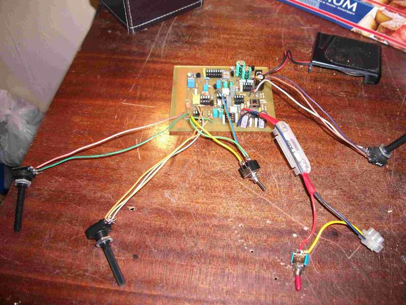

                      • I have proved my tgsl and it works. The bobbin that I have constructed is very bad. I detect tin of refreshments to 6 inches and a currency of Euro to 1 inch.
                        In addition I have tried with two bobbins of another detector that I have (gary touches 2) and it detects a tin of refreshments to 10 inches and a currency of Euro to 2 inches.
                        With thread of so thin copper it is very difficult to make a bobbin good.
                        Where they sell the original bobbin of the tgsl?

                          Hi @Orbit,
                          I think you have your coil shielding all wrong, or it may not be connected properly. A properly shielded coil should not behave like this from what I have read, and seen on YouTube. Please take a look at this YouTube Video:
                          How to Repair Faulty Metal Detector Coils (5m42s):
                          http://www.youtube.com/watch?v=0Owrk...eature=related
                          I hope this will help you @Orbit, for your problem dose not sound TGSL circuit related at all to me?
                          Robert

                            • Thanks Robert. You were right I am a coil, the probe took one second when I opened the Faraday cage at th was not connected.
