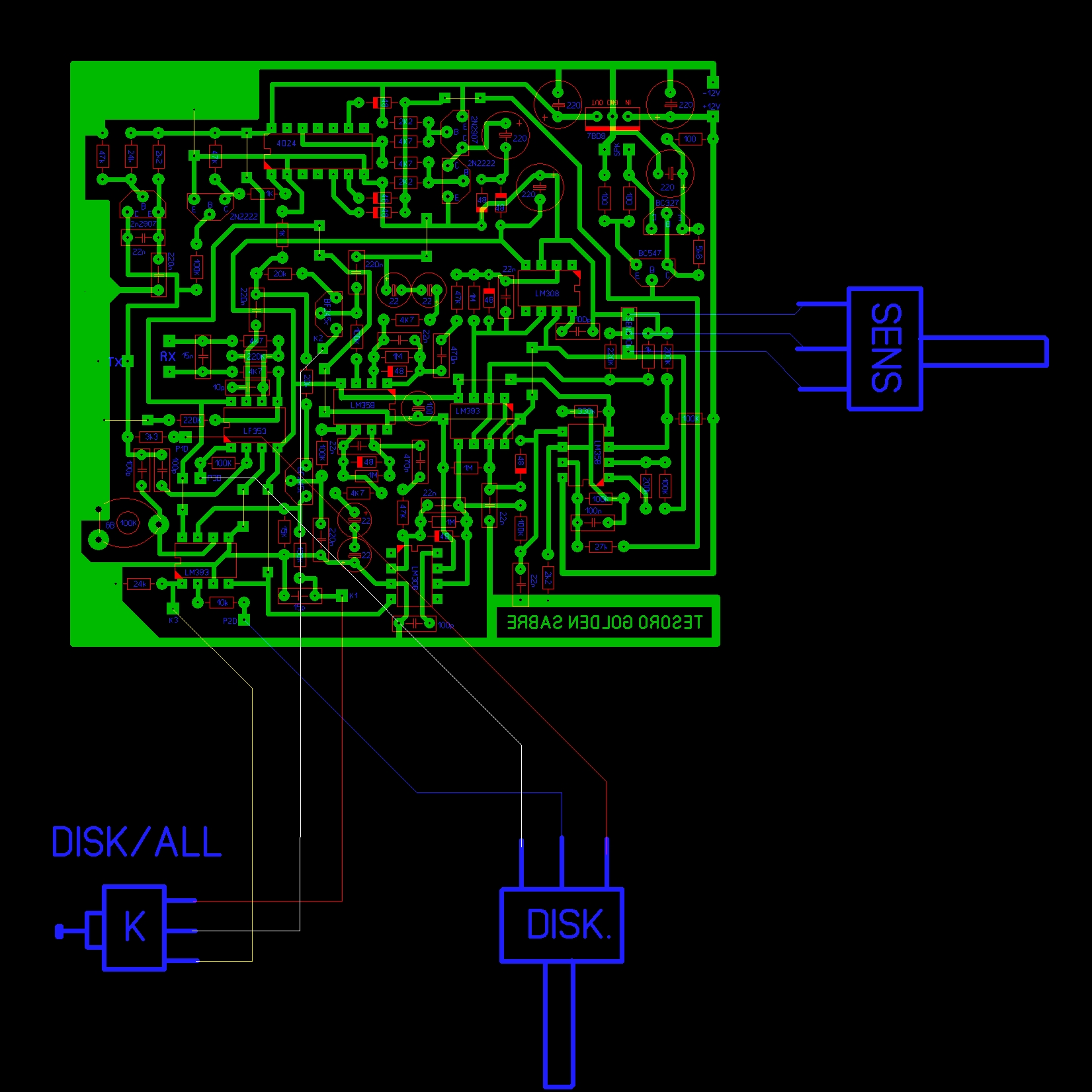

      Good morning
      I am new and i have invested in a tgsl eduardo1979, but I don't know how to link cables k1.2.3 on the pot and which value for this one
      Same things for p10.20.30 and for the sensibilitée .
      Thank you for your help.
      • Tgsl Edu conexion

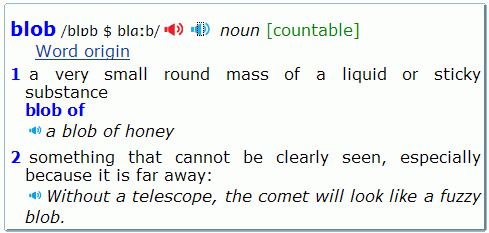

                    Is the following your meaning of term "blob"?

                            Simon, the shield generates an eddy current signal.
                            I think the one with honey sounds rather nice...
