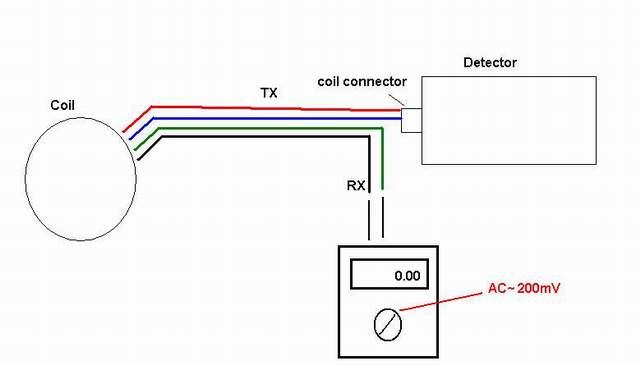

                      • Ok...metaldetector107;
                        here is what i want you to do!
                        Disconnect ONLY RX wires from your detector and connect those on digital multimeter. Switch multimeter to AC~200mV range. Switch ON detector. And measure residual voltage. Than post here.
                        See on posted sketch bellow, it is how should be done.
                        Post what you measured here and we will see what to do... OK?

                            • TGSL
                              Dear Ivconic
                              i know what you mean actually i put digital meter on 200m
                              and it read 00.6 i can make it lower to zero even but zero is not very good
