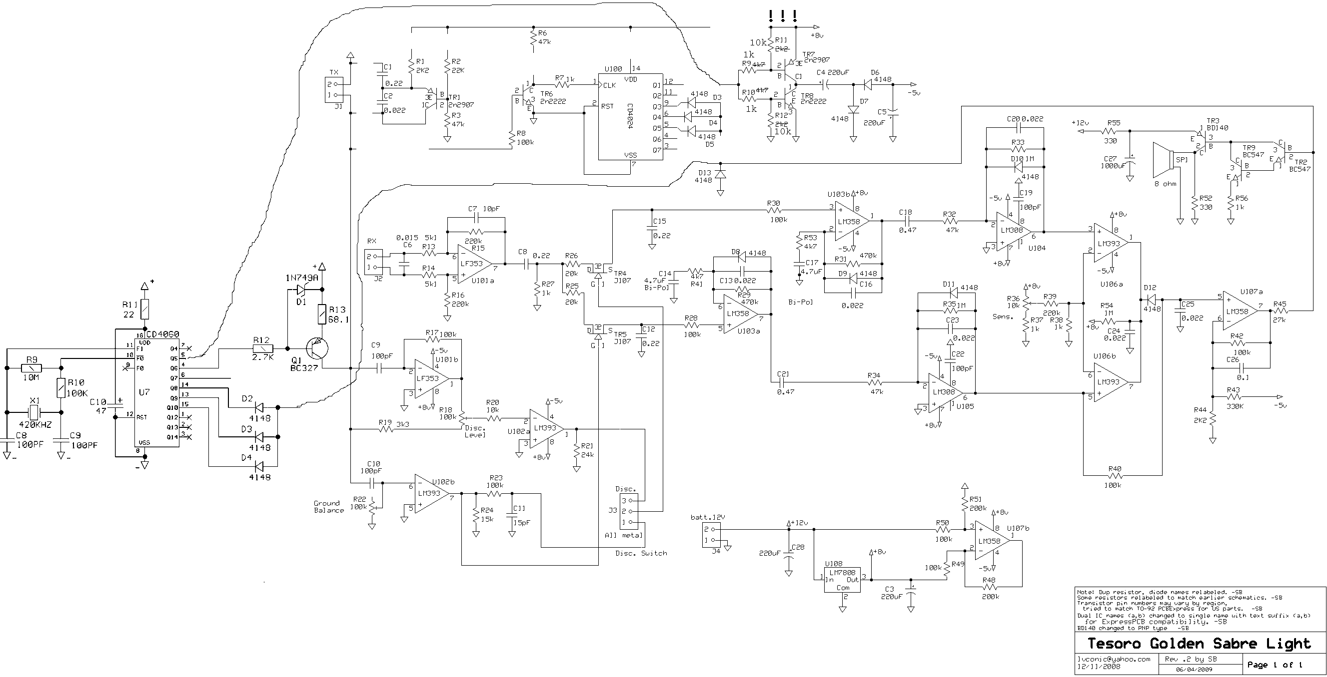

          I am making Ivconic's TGSL Final PCB, but hand-wiring.
          I have a problem at output of U101b (LF353 disc signal).
          The output has jagged spikes on top of sine wave.
          I tried reducing amplitude of TX oscillator (by putting 7k resistor in place of R6 24k resistor). That made the "jaggies" go away - smooth sine output.
          So I simulated the circuit and adjusted the TX oscillator amplitude to grow slowly, and at a certain value I see the "jaggies" appear just before the LF353 inputs become saturated.
          Conclusion: the disc signal from LF353 can be distorted by large TX oscillator signal. That may be one reason for the JFet feedback in oscillator, to keep it from saturating the LF353 inputs.
          Do other people see this problem?
          I attached LTSpice images and circuit.

          1. use longer simulation time... 5ms is not enough
          2. change c3 value up and down and notice the difference...
          3. what's going on ???

            2. Which is C3? So many schematics.
            1. If input is pure sine wave, yes the "jaggies" will go away with time after initial start. But if input has "bump" or other sharp change, it causes oscillations again.

              the 100pf one... connected to LF353... it's also c3 in your simulation.
              Kind regards,
              Max

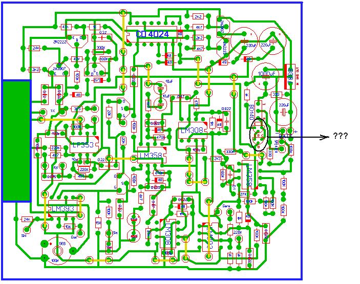

                • Hi...
                  What are these transistors name? anybody built it?
                  • TRANSISTORS
                    BOTH BC 547

                          • Hi all.
                            So will better.
                              simonbaker, could you to simulate up-dated one?
                              I hope it will good.
                              YOURS
