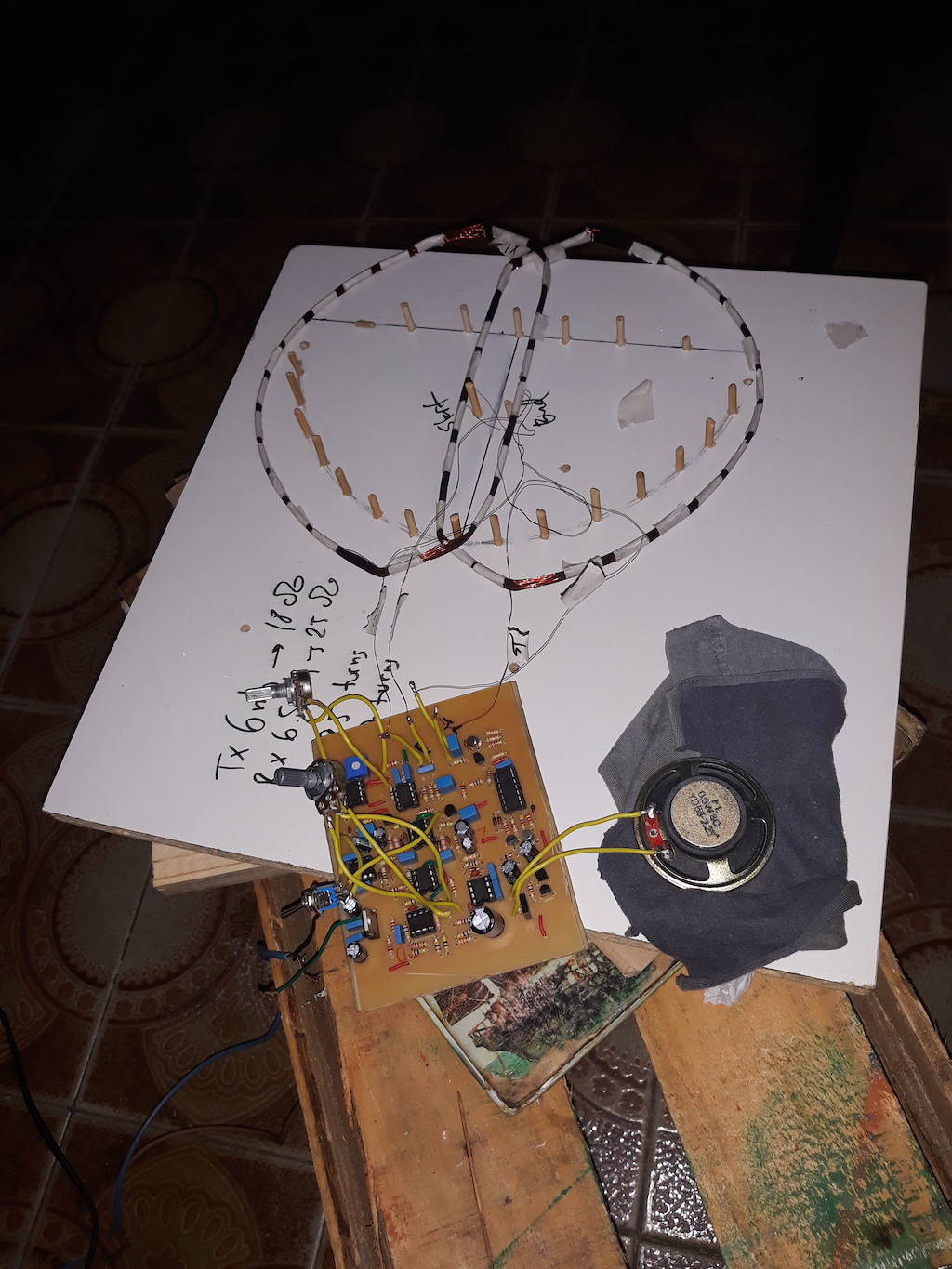

  • I connected the coil to the second TGSL board. The signal is clear. This means that either the LF is bad, or minus is weak. I decided to postpone the project until better times.I'd rather do something else

                    I did this with a multimeter, move the RX on the TX slowly and reach zero millivolts in AC mode !!!!
                    Of course, in this method, the angle between RX and TX is not observed, so the amount of sense is slightly reduced!!!!!!!!!!!!!!!!!

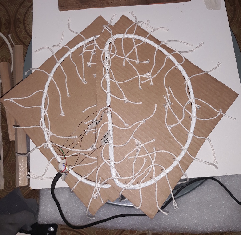

                            • After building new coils, now I have better results, although, not perfect yet.
                              My inductance meter (gm328a) sometimes measures the inductance, sometimes not (I think I need to buy a better one) and also need to buy an oscilloscope.
                              Anyway, measuring the frequencies (connected to the TX pins), I got the values of 15.6 for TX and 14.3 for RX and below is a video of some detection distances for some coins (a portuguese "20 centavos", a french 5 Francs, a quarter dollar and finally a brazilian "40 reis"), for all of them I get a distance about 20cm (more or less) so I thing is still a poor detection compared to others I have seen of detecting a coin at about 30cm.
                              Here is how I'm securing the coils in place (to prevent deformation) while testing:
                              Well, I think the next step is to buy better testing tools like a better inductance meter and an oscilloscope.
