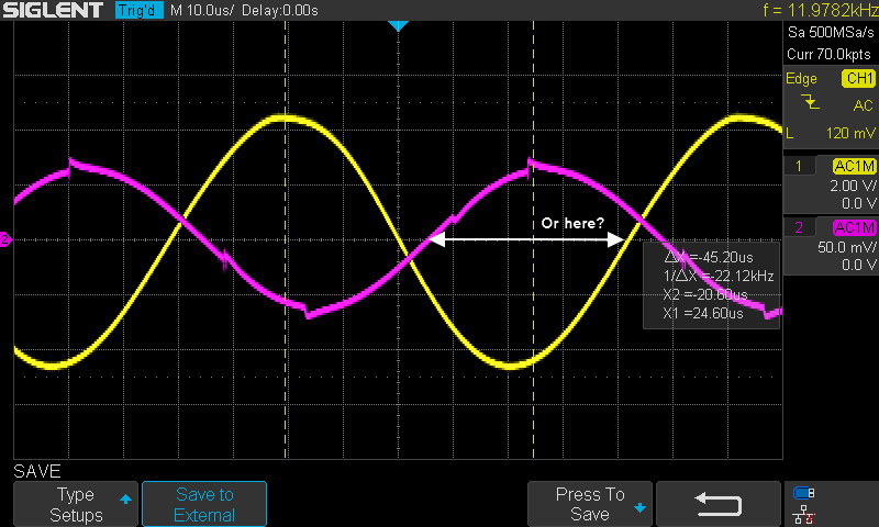

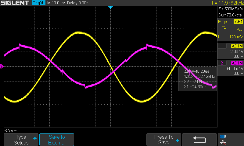

                    How can a coil like this work? And yet it works perfectly, even though it is balanced where tx is leading by app. 200 degrees. Won't the phase detectors sample at the wrong intervals? Wouldn't they be off by some 180 degrees?
                      I posted this above:
                      You need to look at the SAMPLING switch timing also. Then know that the next stages, differential circuits (I said integrators above in error), are AC coupled so only give a response to Changes.

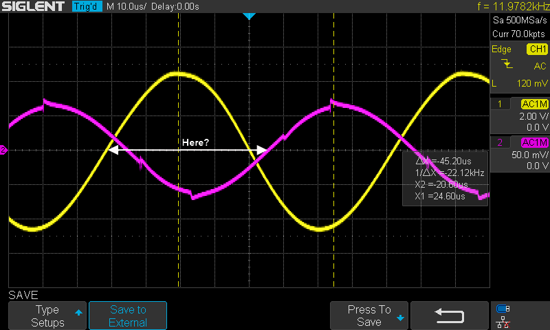

                      • So where is the correct phase to watch?

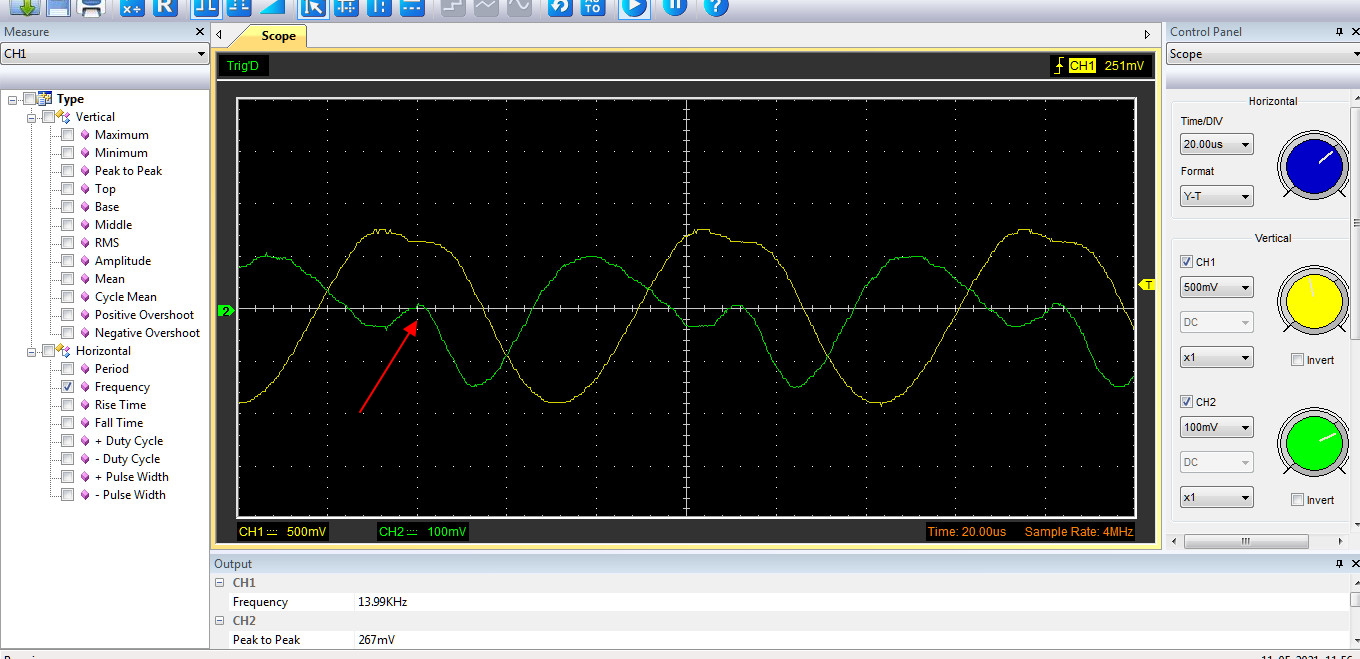

                        • And one more question. Today I nulling the concentric sensor and noticed the distortion of the lower part of the RX sinusoid on pin 1 LF353. What is the reason for this - a bad power supply minus or a step on the TX? Or poor quality op amp?
                          • Originally posted by SWL View Post
                            IF Yellow trace is the TX signal, this is the "reference" for measurements.
                            Then 1.png is the correct measurement since we know that due to the circuit the RX signal will LAG and appear later in time.
                            Therefore the phase shift is:
                            Period = 1/11.987kHz = 83.5us
                            Shift = 45.2/83.5 *360 = 194.8 degrees
                              That is odd and I really do not know why it looks like that.
                              Take a look at the input, on the RX coil, to the preamp and see if it is there.
                              Also ensure NO metal is near the coil.
                              Could be a bad opamp, swap with a new one to see. Do ensure the LF353 is NOT a fake.
                              • Exactly! I completely forgot to look at the input signal. I'll take a look in the evening. There was definitely no metal nearby
