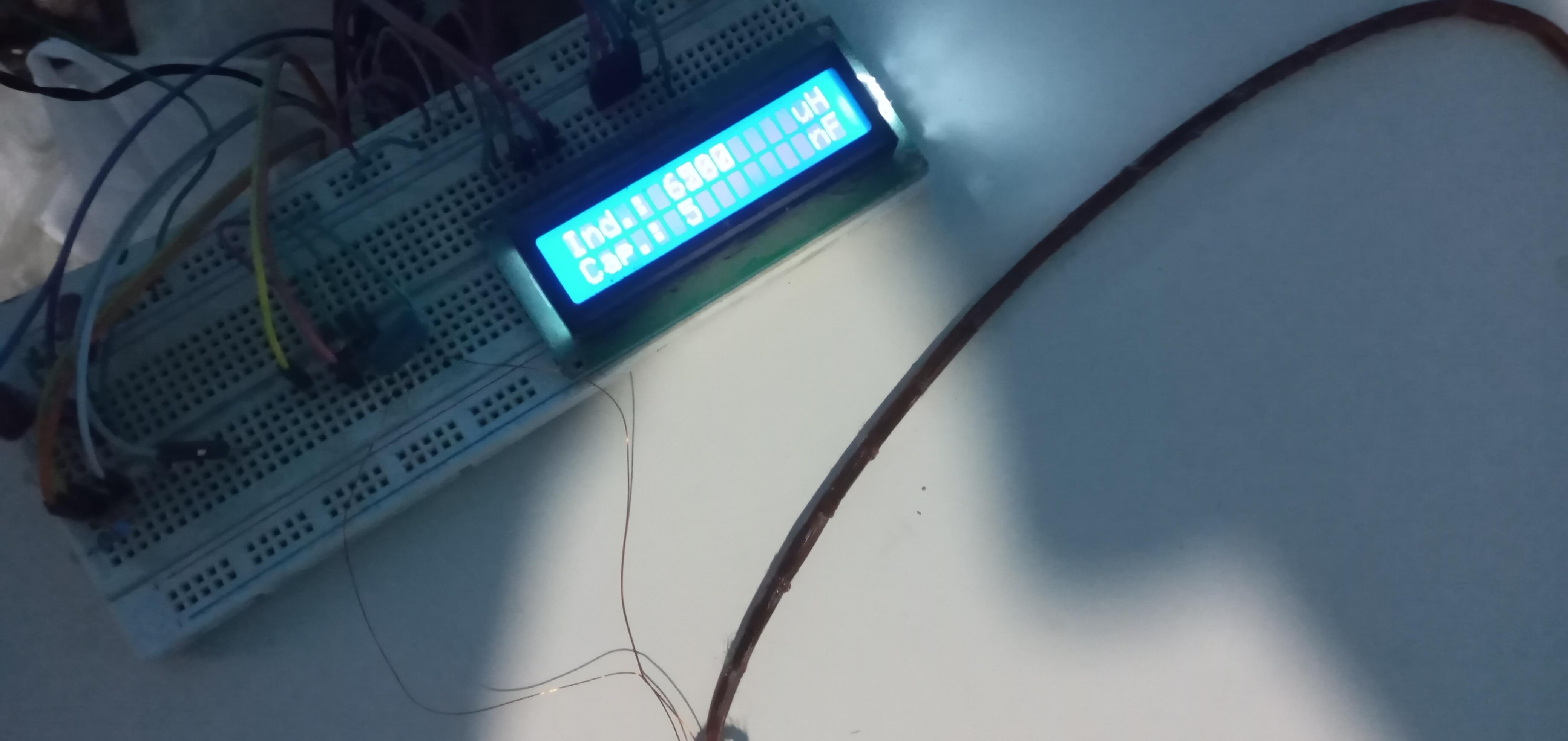

      In order to continue with the TX stage I had to make the Tx coil, I made it with 0.25mm wire. (30AWG), in a diameter of 200mm., with 103 turns. I measured it with my homemade inductance meter and it gave me exactly 6000uH.Click image for larger version

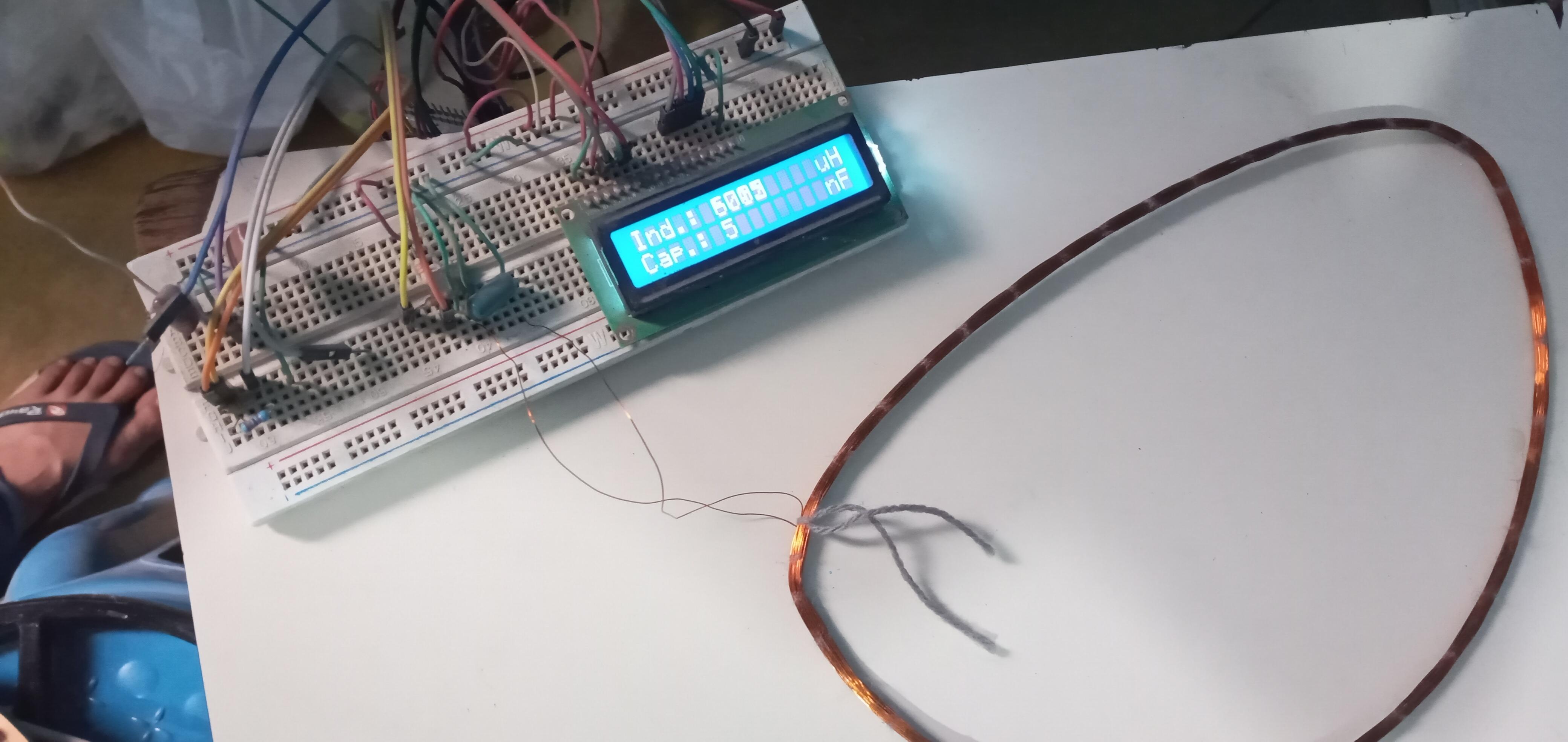

      • 0.25mm RX coil. (30AWG), 200mm. in diameter, 108 laps. Measurement on my homemade inductance meter at 6500uH.Click image for larger version

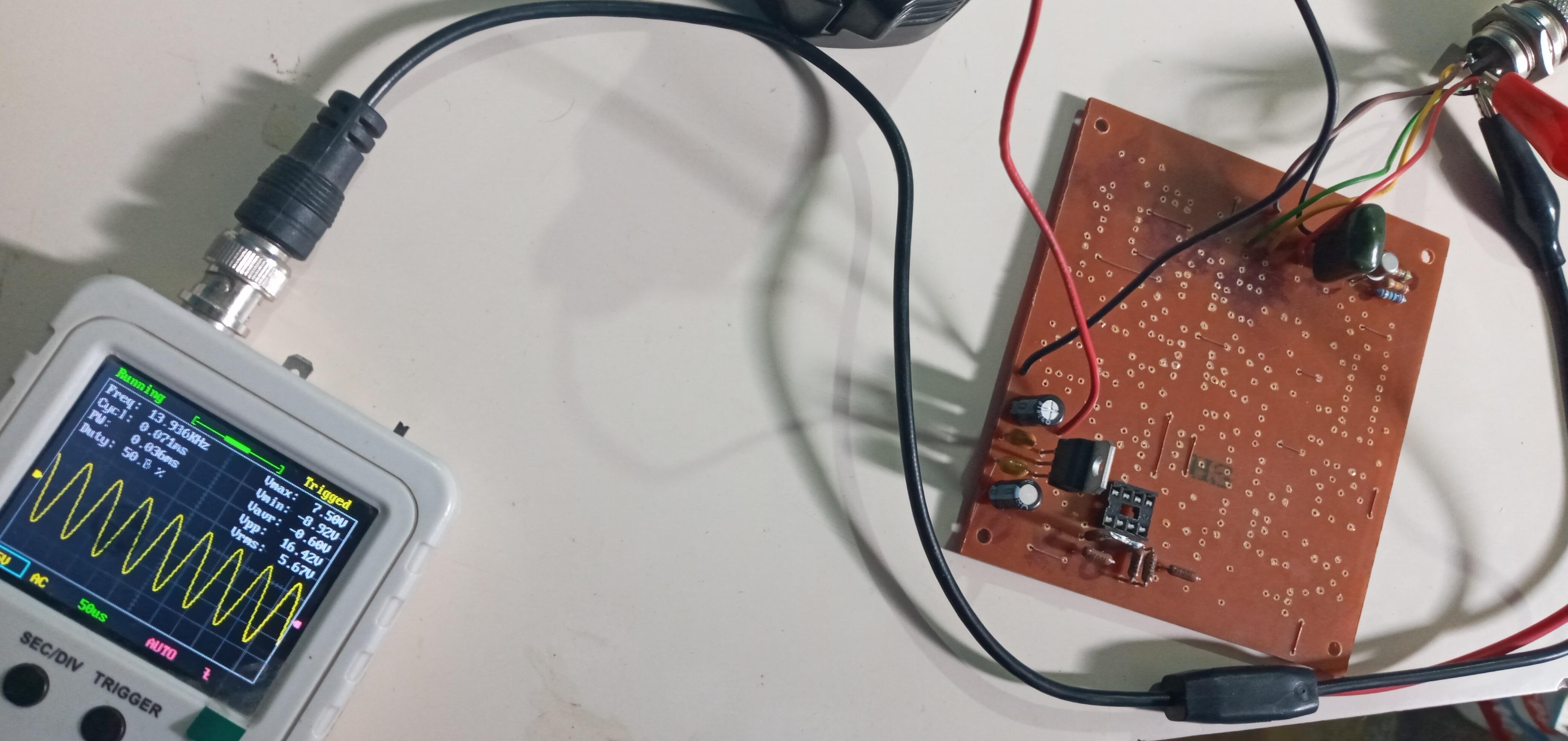

        • Hi friends!!
          I placed 22n in C1 and 219n in C2, according to the measurement of my instrument and placing the 6000uH Tx coil according to my homemade instrument, I obtained the following measurement according to my instrument.
          I am more than satisfied, then I will try with the Rx coil instead of Tx.Click image for larger version

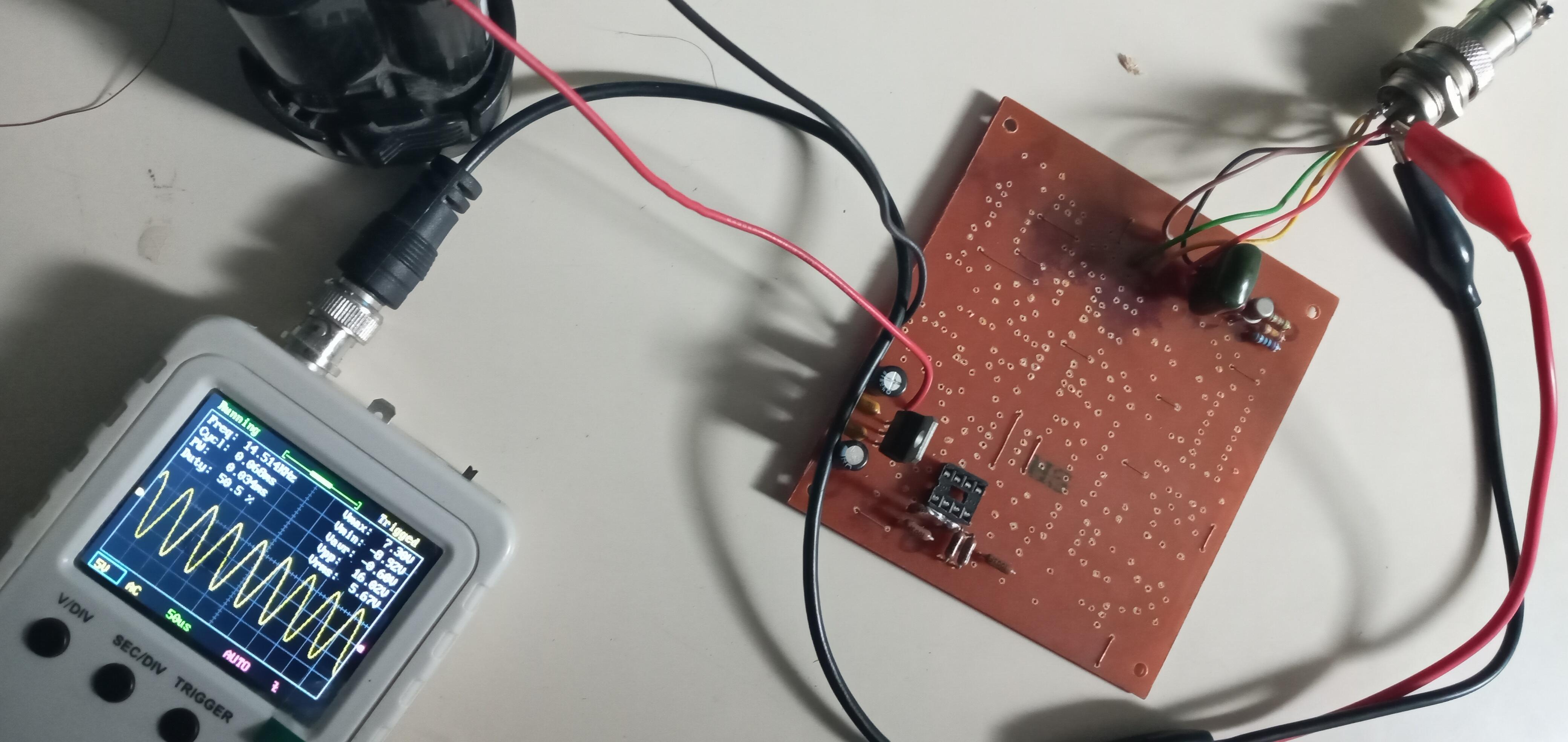

          • Coil Rx instead of Tx is shown in the image depending on the instrument.
            It seems to me that my homemade inductance meter measures correctly. Rx at 6500uH.
            I will now go to block number 2.

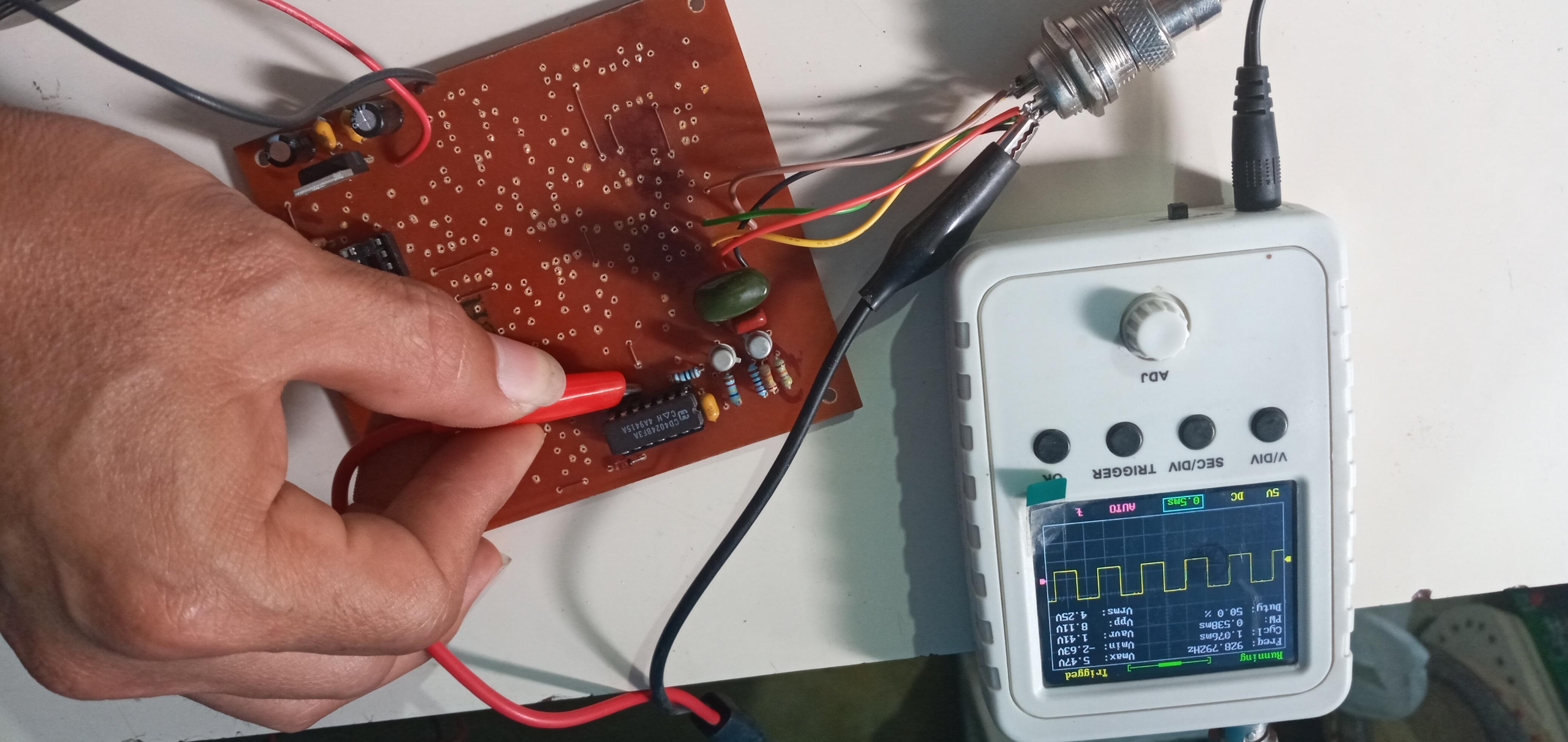

            • Hi friends!
              I just made the measurement at the point U100 Pin6 and this is what I got according to the image. My question is: is the measurement correct?
              Any advice will be welcome!Click image for larger version
              • Originally posted by Ruben2000 View Post
                Hi friends!
                Any advice will be welcome![ATTACH]56917[/ATTACH]
                Yes.

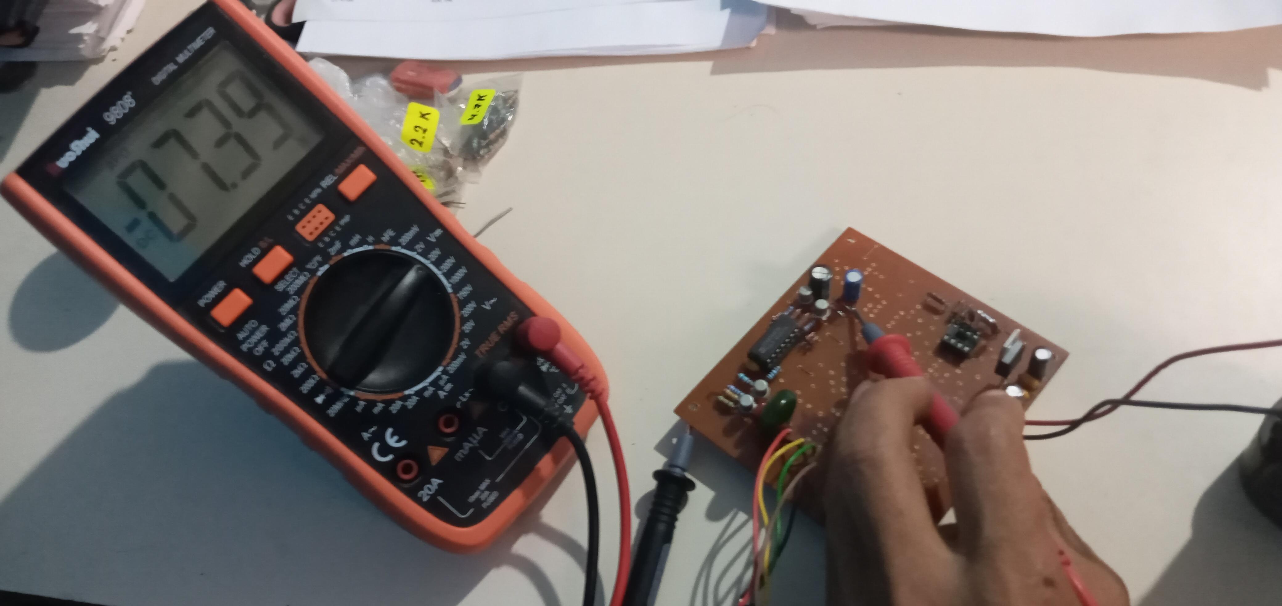

                  I made the measurement on block number 3 at the -5V point; when taking the measurement I got a higher reading. Is it correct that it has such an output? since there is no load on the output.Click image for larger version
                  • Yes, it's correct. It's supposed to be a voltage inverter. 8V minus some voltage drop of diodes.
                    • Although -7.4V maybe should be closer to negative 6.8V.
                      Silicon diode have voltage drop of 0.5 to 0.6 volts across junction. So I should expect to see -6.8 or thereabouts.???
                      • I am not so good at these things. But the document says negative 5volts, which I can't see how. Perhaps when connected to the rest it is closer to 6 volts.
                        I just say the negative rail and leave it at that.
                        • What circuit you made your inductance meter?
                          • Hmm, I you salvage diodes from those boards you got, then watch out for schottky type.
                            Those have low junction forward voltage drop as is well known. Maybe account for the -7.4V you measured.
                              I got it out of here.
                              https://youtu.be/hMa-AWyuxaA
                                The diodes that I placed have the denomination ST4148.
