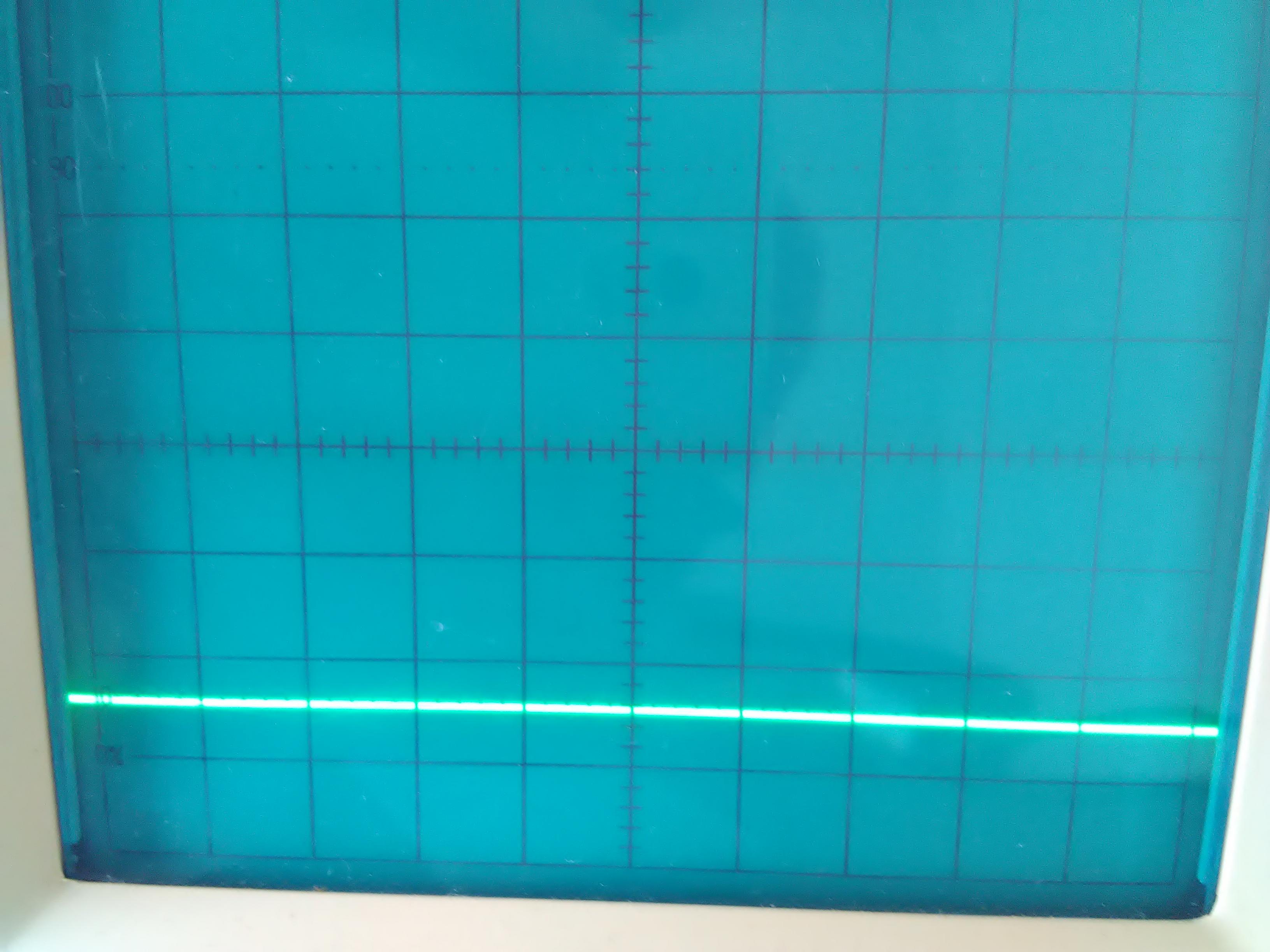

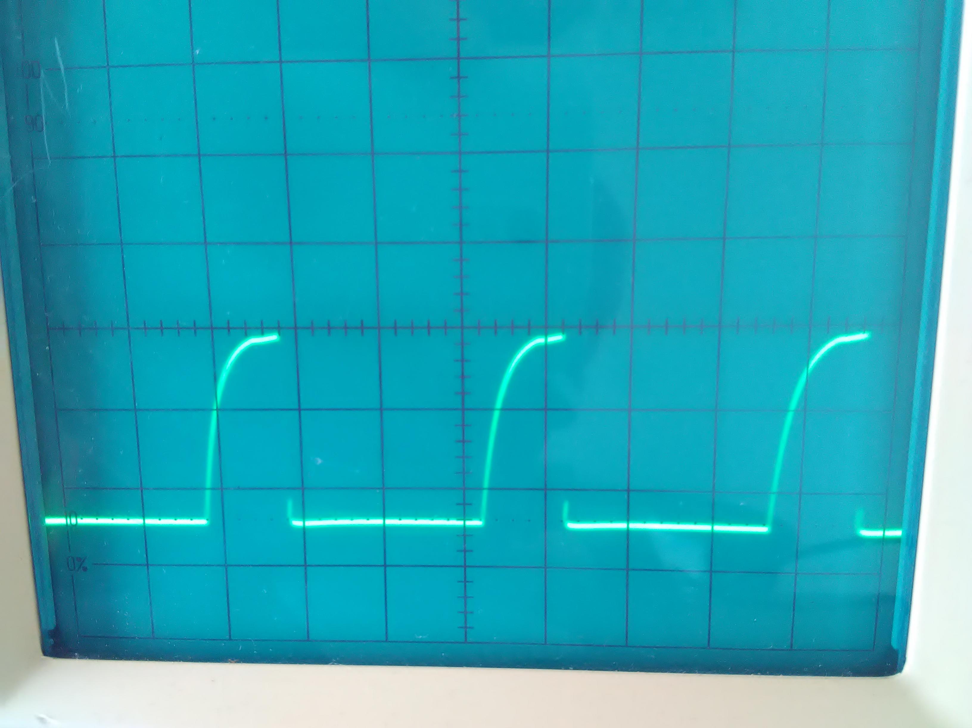

      i've just sat up my TGSL with 28cm coil
      TX: 14.705 Hz and RX: 14.144 Hz
      it's fully functional but i think i have some little problem
      (1) it doesn't detect above 50 or 60 cm even with a big steel wrench or 1kg of other metals.
      (2) it has more depth when i advance the GB pot clockwise more than it needs to reject ferrite.
      sample coin(nickel ,copper , zinc or aluminium alloy)
      GB set low(less than mid range) = 25cm
      GB set high(a bit more than mid range) = 35cm
      i'm just worrying about silver rejection...
      it doesn't detect copper btw but it doesn't matter to me , just in case to know.

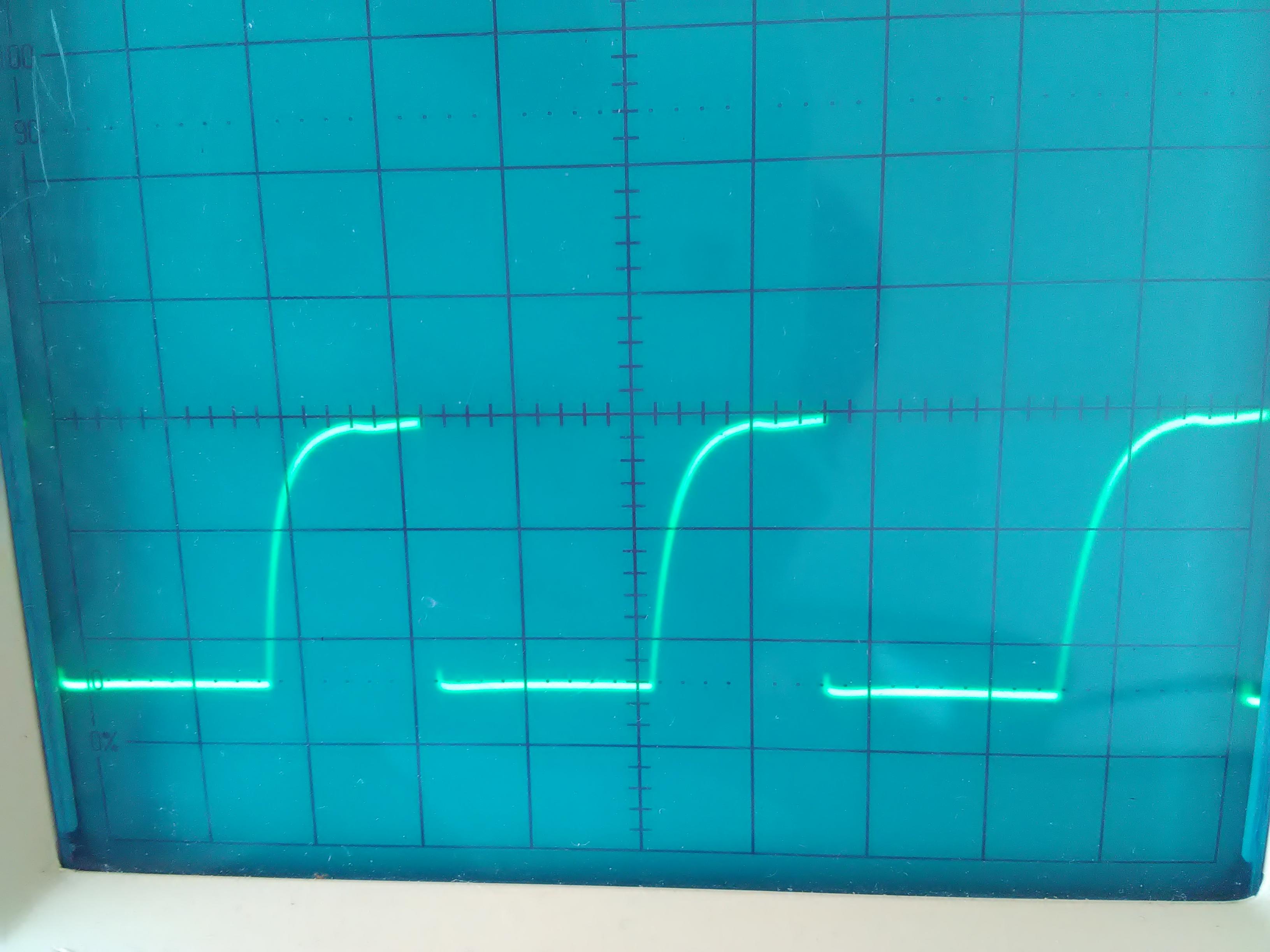

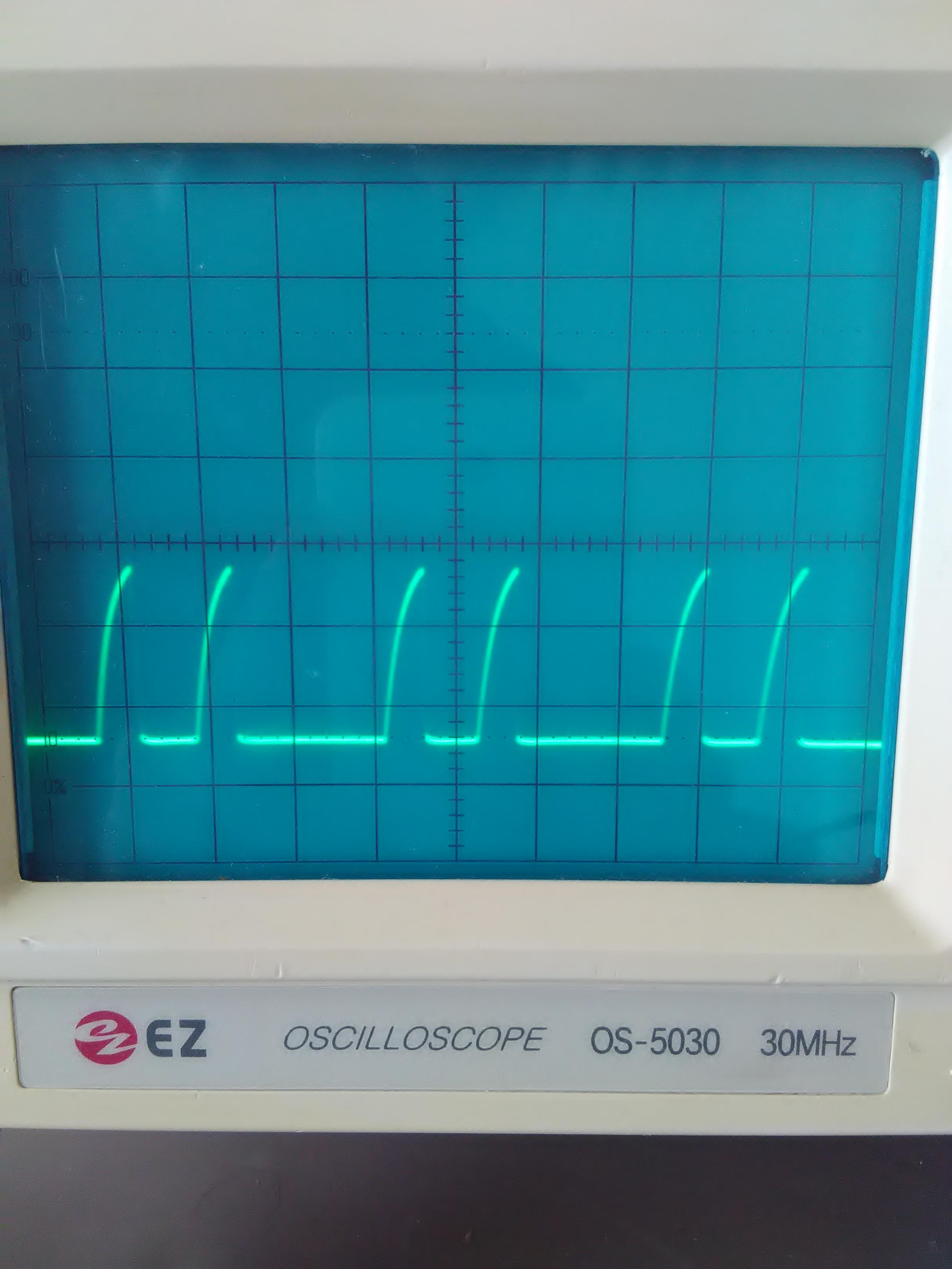

      (3) when i switch to disc mode it works perfectly but when i observe the gate of TR4(disc channel) with oscilloscope ,
      the waveform disappears after mid range of disc pot(100k)
      unfortunately i don't have silver and gold at the time to test if they would get reject when waveform disappears or not...
      thank you guys in advance if anyone would help
      this is the waveform on gate of TR4:
Name:	disc_pot_more than 60%.jpg
      • The TR4 gate waveform looks good at min. However, the 30% & 40% doesn't seem correct.
        Compare to the TGSL 101.pdf.
        Then re-check ALL components from C9, R19, through to input of U102.
        C9 and C10 are fairly critical caps so ensure you use good quality 100pF caps here.
        I also assume you used non-counterfeit chips.
          thanks sir i'll check again
          after 30% it narrows down again while advancing disc pot, that's the reason for 40% waveform
          i've used multilayer ceramic caps for C9 and C10 , should i change it to polyester or MKT type?
          and i don't know if it's a genuine chip , perhaps chinese or tiwanian ones
          i rarely can find genuine chips around

            It is an odd behavior. That why you need to re-check all components. Also recheck the Disc Pot wiring and the pot itself.
            I used polyester caps for C9 & C10. So worth trying other caps.

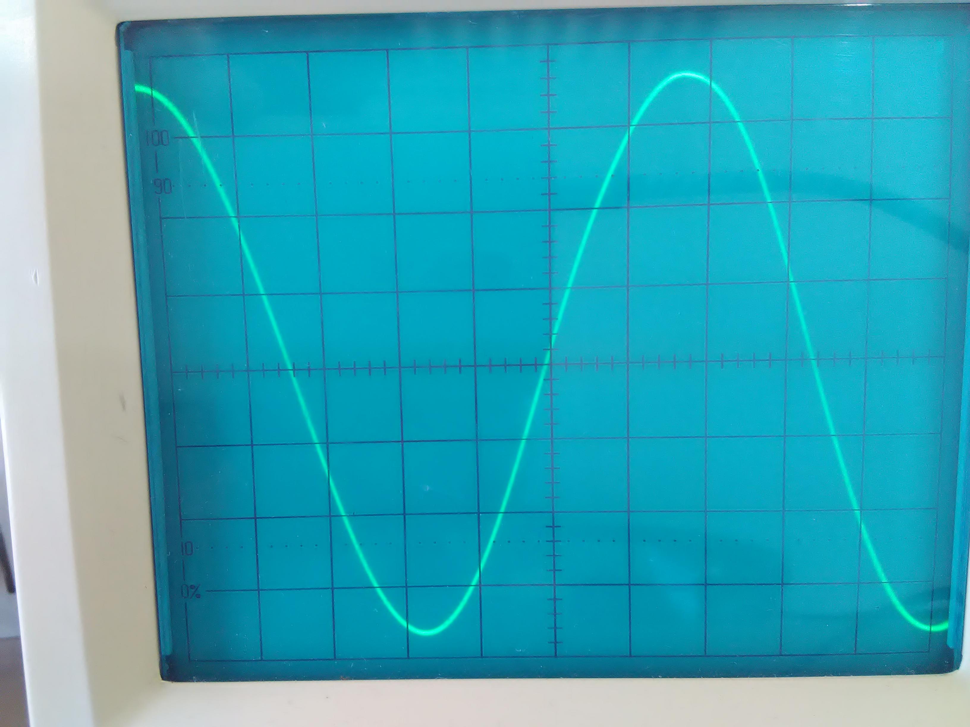

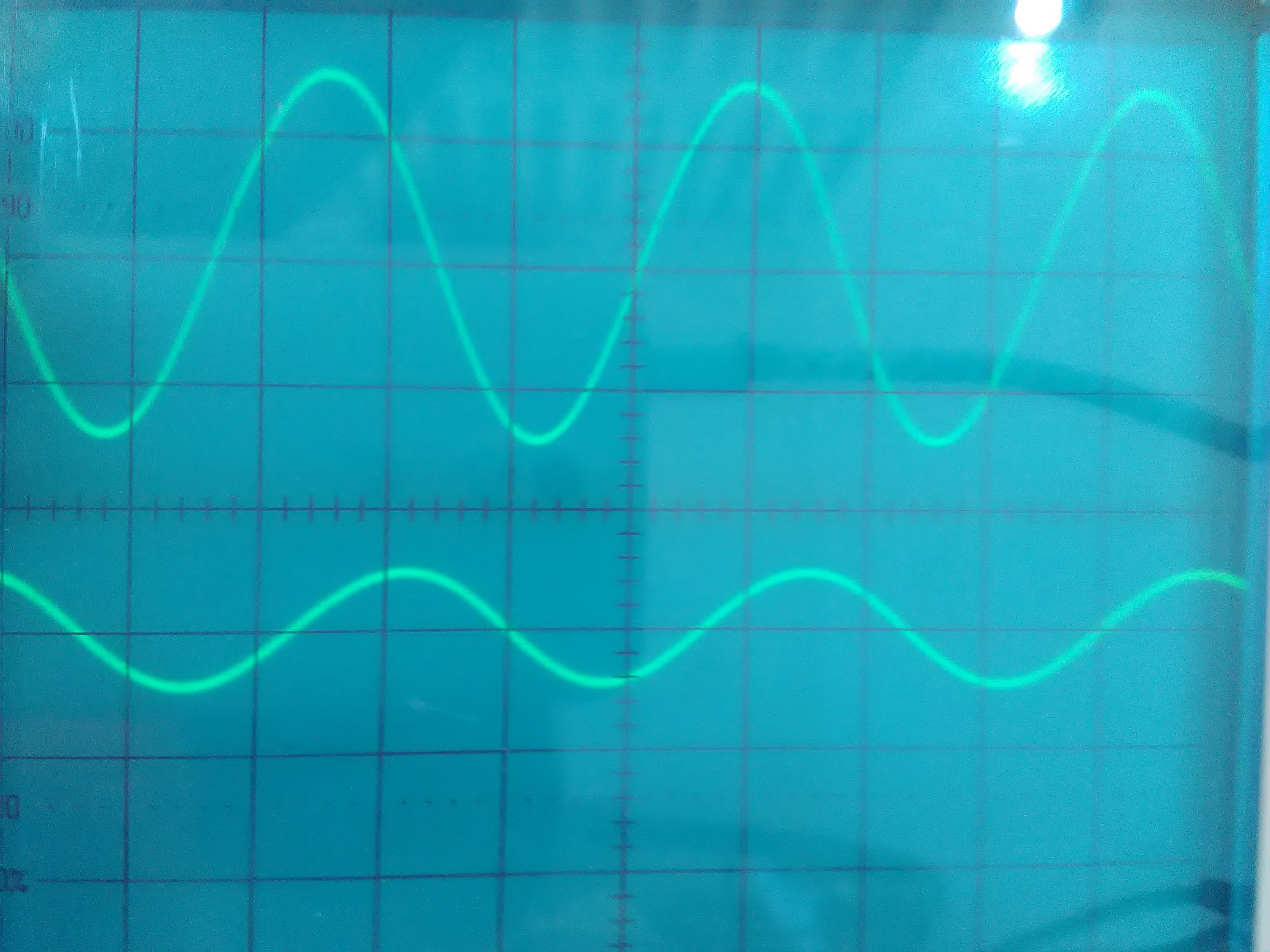

                  TX signal:

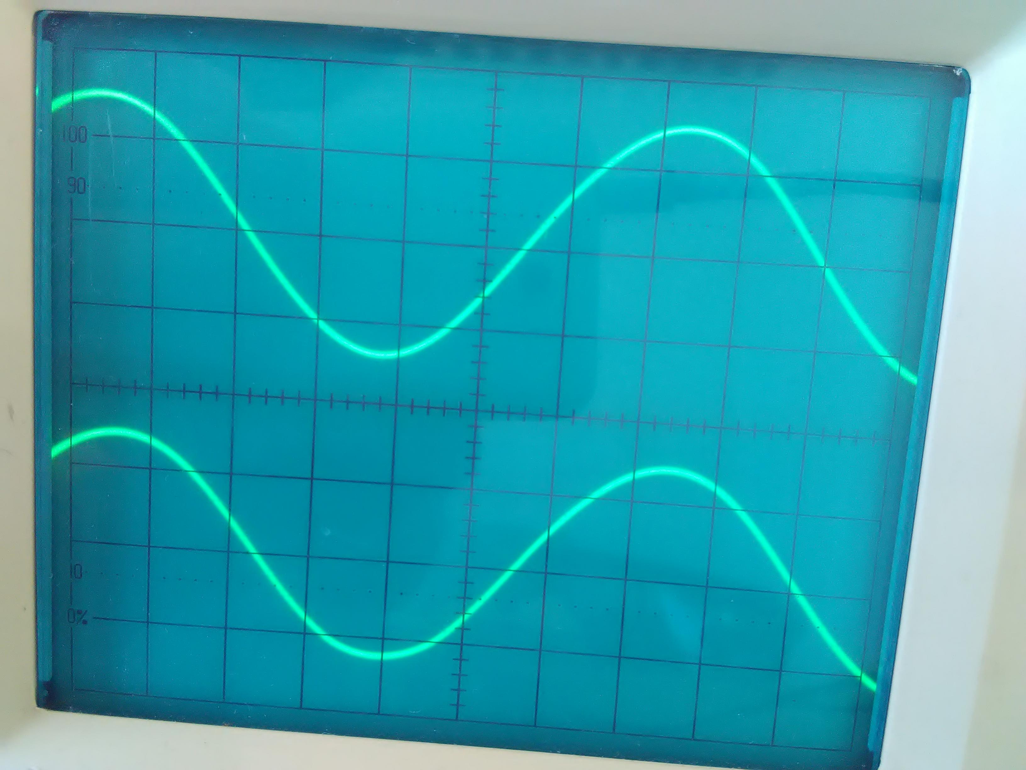

                  TX vs RX on output of U1, each block is 53 degrees of phase shift(so it's 20 now)

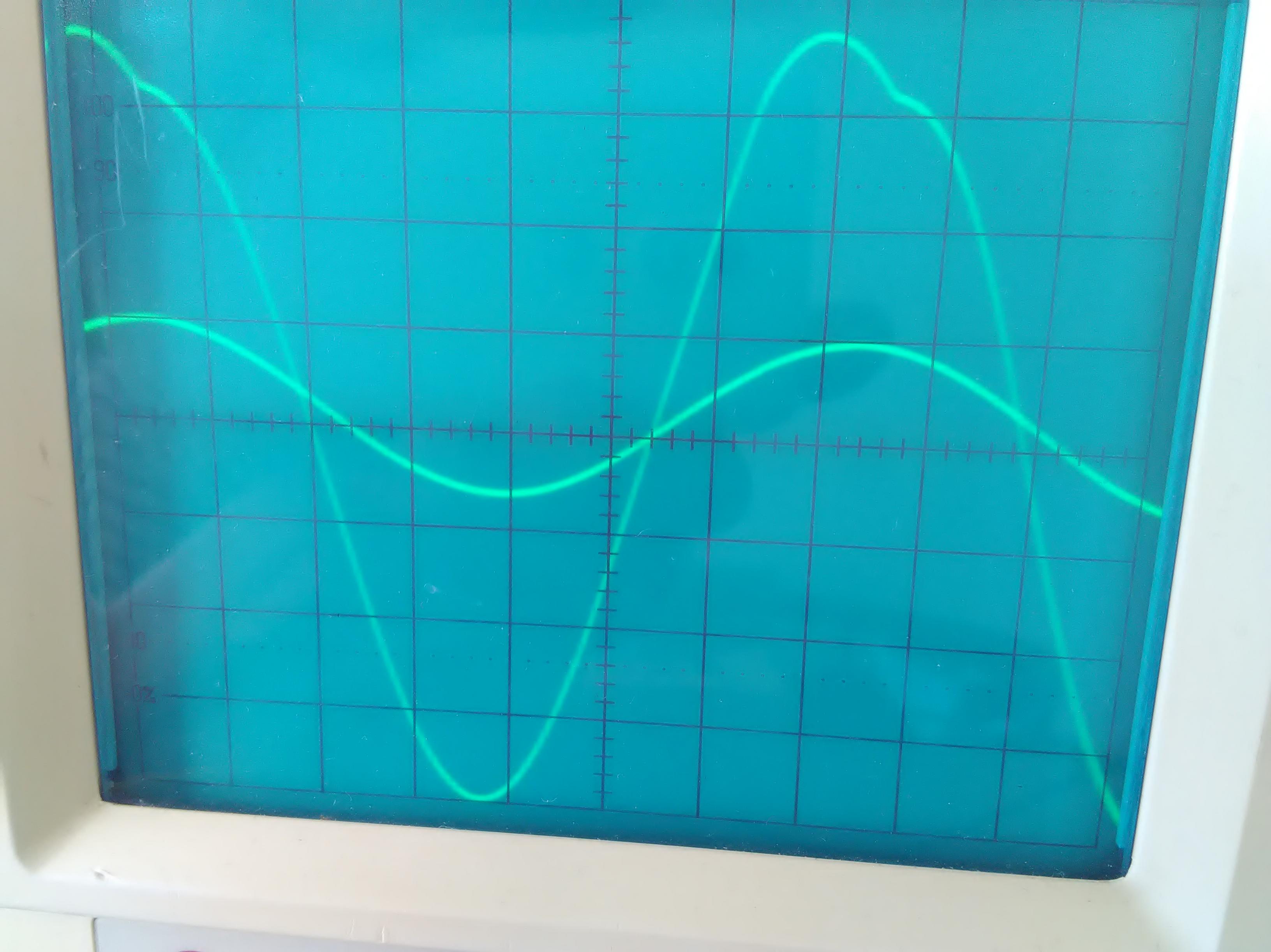

                  tx vs middle pin of disc pot, disc pot at min
Name:	TX up_G of tr4_bottom_disc min.jpg

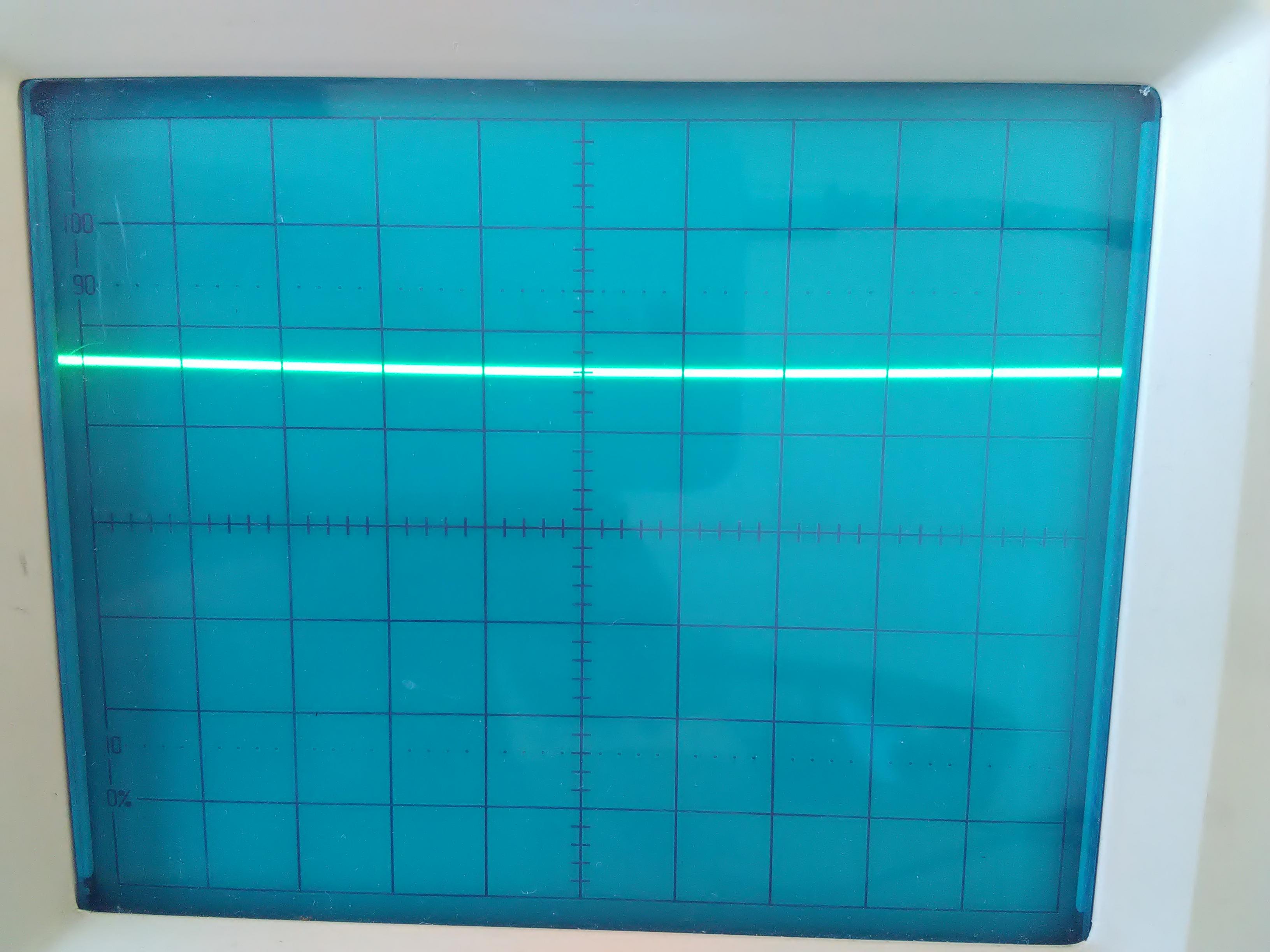

                  tx vs middle pin of disc pot, disc pot at mid range
                  tx vs middle pin of disc pot, disc pot at max
                  something is absolutely wrong

                    • First, the Scope Voltage scale and Time base are Unkown so I can not give much on what you show us.
                      Also is the scope AC or DC coupled?
                      Where on the scope is the ZERO Volt level for each trace?
                      The TX_signal.jpg seems too clean and is NOT the same waveform that is in the Tx_RX_lf353out.jpg.
                      The TX signal in the second jpg looks like what I expect, with a slight kink near the peaks.
                      Are you Sure U101 & U102 have both +8 and -5V (-6.2)??
                      What does the signal going into U102, pin 2 look like? This is a Comparator, When pin 2 Voltage is higher than ground out is high. When lower than ground, output low.
                      Since the output is HIGH when the Disc pot is turned past middle indicates that the signal on pin 2, AC wave, is completely above ground. This signal should be going positive and negative. This can happen if U101 does not have -5(6.2)V.
                        scope time base is 10us per div and voltage is obvious when the tx is large it's 2V/div and when it's smaller it's 5V/div
                        both DC coupled , trigger source is vertical(VERT)
                        zero reference for first and second pic is at the X=zero (middle screenl)
                        for third pic: middle of bottom section and for forth is middle of top section of the screen
                        the last one is lower than middle screen if i remember it right
                        that test point on middle pin of the disc pot goes higher in DC and AC waveform dies when i turn it clockwise
                        TX waveform is clean because of that 100k trimmer, it's not a problem , it changes with that trimmer pot
                        unfortunately i could't capture the signal on pin 2 of U102 cuz my tx circuit runs unstable perhaps for dirtiness or bad solder joint,
                        since the pcb is a double sided board, it's so sensitive to desolder components, and that 100k trimmer legs.... but i see the signal before and after those 100pf caps ,
                        , before caps obviously is tx but after caps was a very low amplitude distorted signal !!! is that normal?
                        i think my negative rail is a bit low , i don't know why?
                        it's about -4.8
                            I got this backwards. The Disc pot goes into the Negative comparator input so output high when input low.
                            Thanks for details on scope pictures.
                            The signal at the wiper of the Disc pot is moving up as you turn the pot. This is Not correct and why the comparator output goes to a solid high level.
                            What should happen is the signal should become more and more delayed as you turn the pot.
                            Did you CHECK the Voltages on the opamp and comparator? -4.8 is lower than typical but should work.
                            Re-check the Disc pot connections and component values. Check all soldering and since you have a hand made double sided PCB ensure connection are made TOP & BOTTOM where needed.
                            • Mr Jaick the phase shift between your Tx and Rx does not seem to be 20deg, there is obviously much less than that maybe 10-15 after seeing the picture you posted.
                              About the negative voltage, try Schotky diodes those have less on resistance and pair those transistors to have equal hFE and also low ESR electric capacitor is a must! The best I have made was around -6.7volts.
                              Waltr has some really good points also!
                              • You can also try to use ICL7660 to make negative voltage for the circuit. You need less components and it makes -7.48volts loaded, works splendid!
                                Do not forget that you have very asymmetrical voltages for the IC's that means that the negative peaks of the signals get clipped. I really believe that this is your problem.
