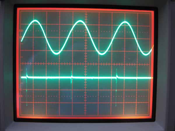

    I am testing oscillator and negative supply section on a breadboard.
    I get quite big voltage spikes (.1 to .4 volt) on V+ rail due to CD4024 counter and push-pull transistors TR7, TR8. Spikes very narrow, couple of micro-seconds, slight ringing at about 400 kHz.
    (see attached picture - top trace, tx coil voltage, 5 v/div. Bottom trace - V+ with AC coupled probe, .2 v/div.)
    I can reduce the spikes by putting 22 ohm isolation resistors between V+ and component with capacitor from 22 ohm resistor to ground (.47 uF across CD4024, 100 uF across TR7, TR8 ), but spikes still there a little.
    Do these spikes exist when parts mounted on PCB, or do they go away?

      I found a major cause of the spikes on the V+ rail.
      The negative supply push-pull transistors TR7 and TR8 are both on for a split second as the square wave input to their bases transitions from low to high and vice-versa. Basically, they short the power supply for an instant, causing a spike.
      I changed the base divider resistors R11 and R12 to 470 ohms instead of 2k2 ohms so each transistor won't turn on until the square wave reaches it's max and min peaks. This greatly reduced the power supply spikes.
      I don't know if the transistors are driven hard enough now to supply good current or are saturated enough to avoid overheating, but it seems to help with the spikes.
      I would be interested if someone could put a scope on their V+ and let me know if they see any spikes.

        they are always there... amplitude can change but you cannot totally eliminate: it's a drawback of design.

                      Maybe I worry too much about spikes because I saw them in output of LF353 - but now I wonder maybe my LF353 was blown, will check.
                      Smaller R11, R12 = smaller spikes -- may keep at 470 ohms or a little more and test. I have other ideas to reduce spikes, some diodes and small caps to delay turn-on, turn-off of TR7, TR8 so not on at same time.
                      Eclipse - I tried some decoupling caps (and isolation resistors) and helps but not as easy as you would think, spikes were very strong. But maybe important, as you say depends on rejection. I think a combination of tricks are worth trying (don't like spikes). Also, maybe C28 is better on output of LM7808 instead of input (or maybe on both).

                              Now I'm a little confused about voltage spikes because I found my oscilloscope probe can contribute to spike -- put probe1 on V+ to monitor spikes, touch circuit with probe2 and probe1 shows increased spike! But only true for very small quick spikes I think (hope).
                              I think the following is useful in general to minimize V+ spike and noise:
                              1. Move (or add) 220 uF cap to output of LM7808 - reduces ripple from oscillator too.
                              2. Make R11, R12 in negative supply driver approx .1 X R9, R10 - reduces time TR7, TR8 on simultaneously, less spike.
                              3. Consider larger R8 to not drive TR6 so hard.
                              4. Consider larger R7 to not drive CD4024 clock so hard.
                              CD4024 is weird, can cause crazy spikes depending on connections. Trying to find ways to minimize it.
                              5. Isolation resistors, decoupling caps on CD4024 and TR7, TR8 driver.
