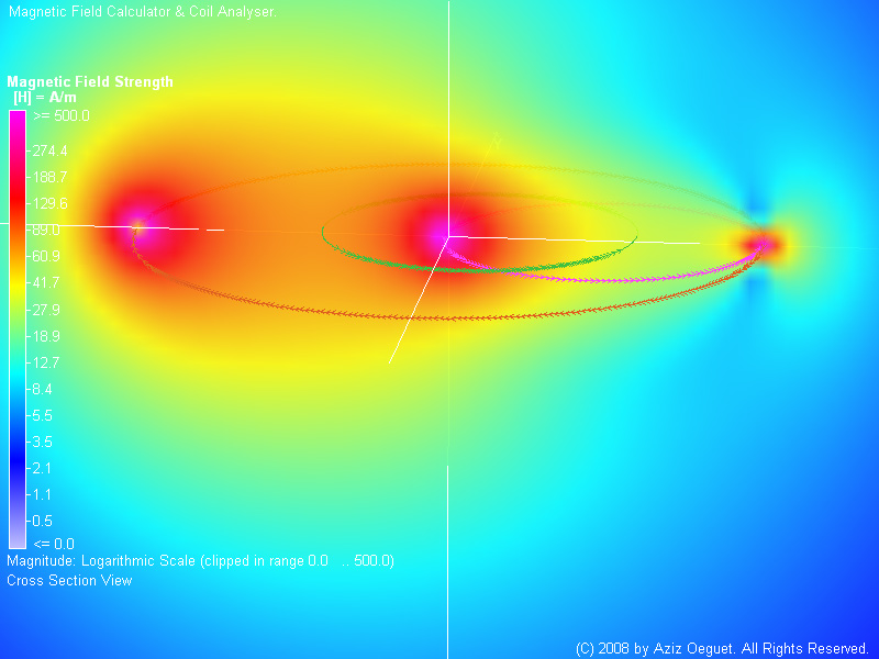

    Interesting, congratulation, and hope usable in measurement not only programming toys.
    But what is input parameters (how coil shape is influenced in visual xyz results?)?
    What happen if you put third cold coil somewhere in field, can you to define it?
    What you mean by "cold" coil?
    I can do many transmit (TX) coils, as needed. The magnetic strength field is a vector field (has strength and direction). On the pictures above, the direction is not displayed. I put 10 turns and and a drive current of 1 A for both coils (not relevant at the moment).
    It is interesting, to compare different coil types before making them. It will be also interesting, to compare omega with concentric coil. I will do this, when I have more time.

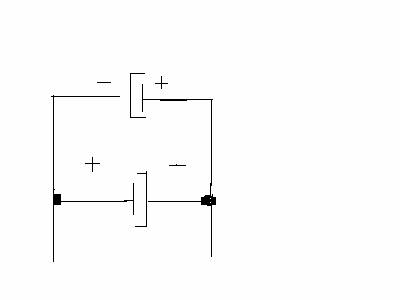

        • hi all
          I saw to get 4.7 Bipolar capacitors 2x10 mf connection like below picture
          Erol

            Yes Aziz, excellent work, but there are many outer influences to coil that have to be computed (e.g. coil shielding) in reality. Only real input (connection to real coil and changing/tunning/loading it) can give you results near to reality in use. Limited theoretical inputs can give you only limited results somewhat far from reality, but very impressive to observe.
            I think a great deal of you, but for practical needs, there is better to use sweep generator and scope or cheap digital USB scope ($100) with spectrum analyzer and connect real coils to it and play/tunning with and observe position and form of curve (f, amplitude, Q, damping etc) on display.
            If you can make an interface between your application and real coil and capture real data, then you can get full practical value out of your application. Best wishes to your approach.
            • Originally posted by erolunall View Post
              hi all
              Erol
              erolunall try this to get from two 10uF one bipolar appr. 4,7uF:
              ------+l
              ]-----¤-----[l+------
              serial not paralel connection

                              • I made an another balanced omega coil simulation. The green coil is the RX-coil on balanced (nulled) position. This shows, why omega coils are for pin-pointing convenient. The high magnetic strength is good covered on the flux area of the RX-coil. So the higher the magnetic strength, the higher the induction on target objects.
                                Aziz
