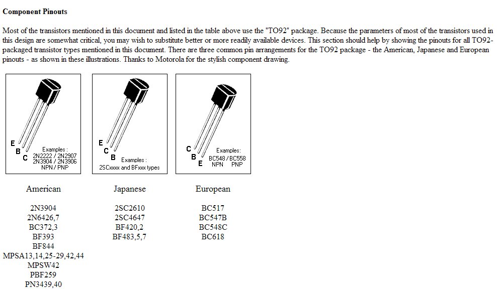

        metallic case ??? PN2222 in metallic case ??? strange.
        Anyway, metallic case 2222 are 2N2222 (to-18 ). Look at the picture.
        The small piece outside indicates E, the central is B and other C.
        Best regards,
        Max
        Usually the 2N2222 and 2N2222A are available in TO18 metallic case, and the PH2222A and PN2222A are available in TO92 plastic case.
        TO18 has base as middle pin and emitter near small lug on side.
        TO92 has collector as middle pin. With flat side down it's B C E, viewed from below.
                  At least the plastic ones should be easier to chew.
                  Hi Qiaozhi,
                  TO-92 (like other packages) is just referred to package dimensions, leads spacing etc so geom. specs of it... not to pinouts, as for sure you already know.
                  There are different config pinouts for TO-92 packaged transistors, as I wrote in previous posts, look at picture below.
                  Then there are also strange things related to non-standard devices and different from expected marking on some asian manifactured components.
                  Hope someone found it useful... to build GSabre!
                  Best regards,
                  Max
