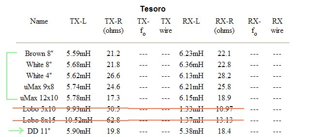

                  • Hi,
                    in this link that you give there is no GS!!!
                      of course there isn't.
                      These are tesoro's coils data. All uMax series coils fit GoldenSabre needs.
                      Do you see 9x8... well GoldenSabre was selled with that kind of coil.
                      Of course you can mount a concentric round e.g. the 8'' brown.
                      The big DD11'' too even if it has a bit different values, of course.
                      TX inductance is about 5.7 mH, RX a bit more 6.2 mH for all them.
                      Look also at resistances... 17. something is the minumum.
                      All these you can use on GoldenSabre.
                      Some are concentric coplanar (most of them)
                      That are more difficault to do respect to DD coils.
                      Anyway, you have to match about those inductances values to get it work good, with any kind of coil (DD, concentric coplanar, OO, whatever...).
                      Green are good values for GSabre. (LOBO used other values as standard, run on different frequencies)
                      Kind regards,
                      Max

                        • Hi,
                          Max.
                          Thanks again!My mistake!
                          But can you tell me what is this 9X8 and 12X10 in cm-s?
                          Are they DD?
                          I will use 0,25 without the varnish!
                          Which is yours 22 DD?
                          Look at this DD11 why RX have less inductance and resistance from TX?
                          Shouldn't they be reverced?This DD 11 in inch must mean 27cm?/1 inch=2,5cm/
                            Thanks Max
