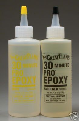

TESORO GOLDEN SABRE
  • Hi,
    anyone have/had experiences with this product ?
    It's a fast epoxy for model airplanes... 9oz total...(about 250gr) my only thought related to problems is about the peak of temperature... cause 30 minutes mean an hi-peak... some temp. fixing can break... some plastic melt etc
    Anyone knows ?
