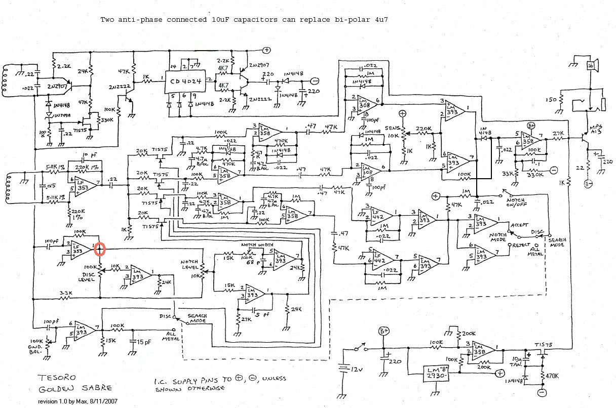

                  • AAAARRRRGGGHHHHHH!!!!!
                    Finally problem is SOLVED for real!!!!!!!
                    But i have to admit - without oscilloscope (even obsolete) i would never find out what was the real problem!!! Also i have to thank to all of you on great support and efforts involved here!
                    Problem WAS damn %&^%$#@%$^%$$@%$% 100pF capacitor C9 at LF353!!!
                    I bought 10 of those brand new from same supplier! Even checked each of those with capacitance meter!? Each showed 105-115pF on meter!!!
                    I would never have any doubts more on those.....but after all possible doubts i decided few hours ago to take oscilloscope probe and "trace" signal after each component....without much of a concept...And i founded it! Damn $%$% capacitor. Out of circuitry it is acting like good one. Included in circuitry it is not good at all. I simply replaced those with first came handy to me - ordinary ceramic capacitors....and it is working PERFECT!
                    Like Max stated; now i can adjust Sense at Maximum and Disc at minimum.......no chatters, no "beep's"....Calm and silent like stone!
                    Also in All Metal mode with Sense to Maximum....working PERFECT...no false signals at all!!!!
                    On coins depth remained same but on larger items...like Cola can depth (distance) raised for 30% more !!!! It can detect Cola can over 80cm in the air now, with 27cm coil. Havent checked yet distances with larger Eliptical coil 32cm...To tired...i'll continue tomorow with testing...
                    Now i can adjust everything by the book! GEB trimmer is now adjusted right in the middle...everything else same as Max described earlier...Huh!!!!
                    Damn local suppliers....thieves!
                    Again, people, thank you so very much for suggestions and efforts here!

                          Ivconic, the reason that the pin 1 waveform is so out of control, is because you have removed the original GS notch level 10k potentiometer
                          that was directly paralled with the 100k discriminate pot. By removing the notch circuit, you have increased the gain of the opamp - at
                          the same time as you also increase the likleyhood of oscillation because of the higher feedback resistance.
                          Either change to a 10k Disc pot, or parallel a 10k fixed resistor across the 100k pot, and see what happens. It will very likely cause a different curve
                          to the Discrimination potentiometer effect (to be more like the original), but things should smooth out.
                          The LF353 is not a rail-to rail opamp. By having raised the circuit's gain, you have run out of dynamic headroom!
                          It feel stupid for not realizing this sooner.
                          Hi porkluvr,
                          you are right on this, I've checked and results from simulations are the same as I can see on scope... with some minor difference.
                          It's better adding a fixed resistor to modified schematics... cause , also, not all LF353 are the same out there.
                          I was thinking few days ago at something related to that...cause when I turn the notch pot, even with notch disabled by switch, I can ear differences on the audio... and that's cause of current flowing in.
                          But then I forget to investigate more on circuit about that...
                          I have all graphite pots, not wire-wound ones on TGS... and that's true that a modification must be made according original gain of LF353 half... you showed why. It's really important for stability.
