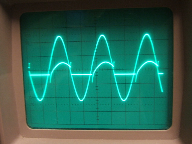

    Max can you scope your LF353 pin 1. and post it here?
    Something is "misty" here???

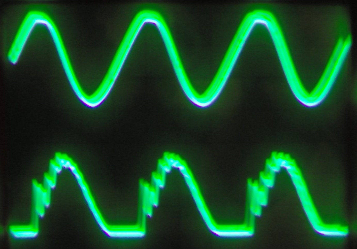

        sorry for bad quality ... I need a tripod or something to do better cause of latency required inside by camera to shoot pictures.
        Actually I haven't around so used hands... and pictures are about "moved"...anyway you could see my signal is different:
        -on top you see the signal at osc, collector of 2n2907
        -under is the pin1 of lf353 and it's parabolic like... with some spurious sinusoidal noise
        Channels amplitude is 5V/square (but can you see squares ?)
        This time I can't do better...
        Hope you see the difference!

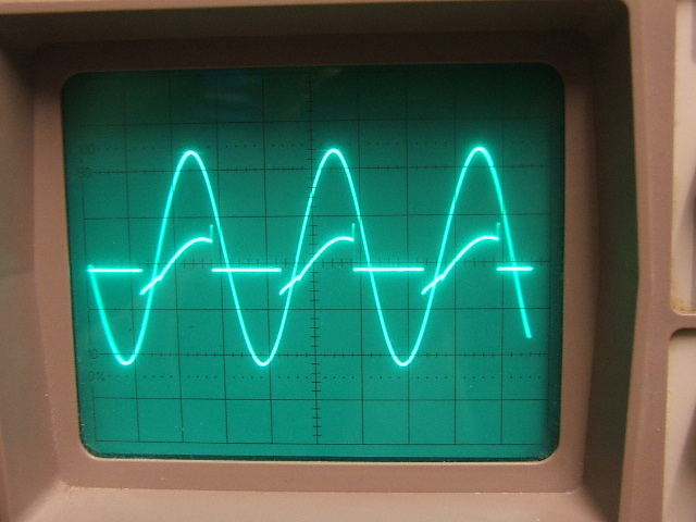

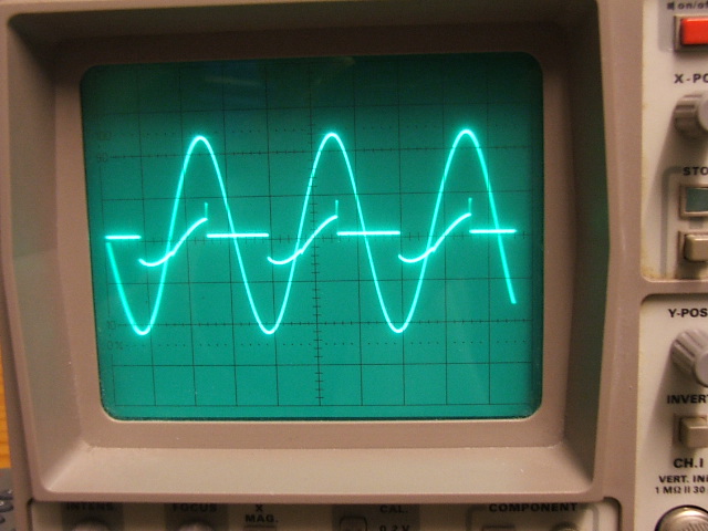

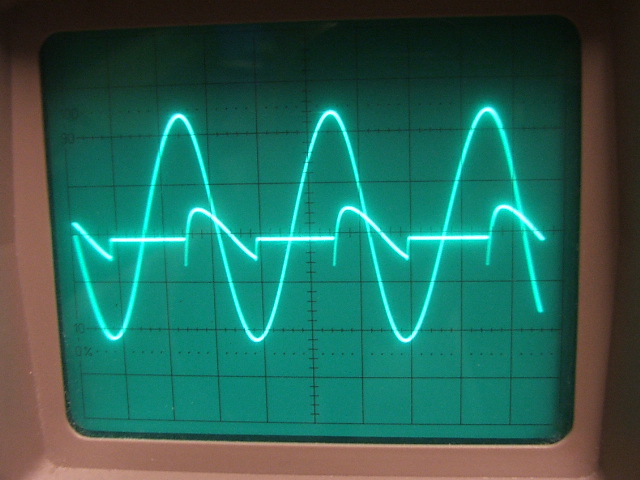

          OK - the top two traces are the inputs to the synchronous demodulators. These look ok to me. In trace one you can see that GEB is sampling at the positive-going zero-crossing point. In trace two you can see the DISC sampling should be at the peak of the waveform for ferrous discrimination, so I guess the DISC pot is turned fully anti-clockwise here.
          The waveform at the LF353 pin1 looks wrong. It's being driven into saturation and there's some instability there. I've used this configuration in the past, and it's clearly not right. Have you looked at what happens to the waveform when you turn the DISC pot? There's definitely a problem here. Are you sure you measured the correct point in the circuit? I have to ask ...
          Receive and transmit look good.
          Can you also probe the outputs of U106A and U106B? In particular, look at the waveform when you wave a coin at some distance from the coil so that the audio signal is weak.

            yes his lF353 goes into saturation at top of curve... and that's no good... but I think there is a problem on the sampling at DISC (fet #2).
            Seems a double pulse of sampling.

                Yes - there is a problem with the sampling in the DISC channel (fet #2), but at least it's sampling in the correct place. I think the double pulse is happening because the sample pulse has that strange instability.

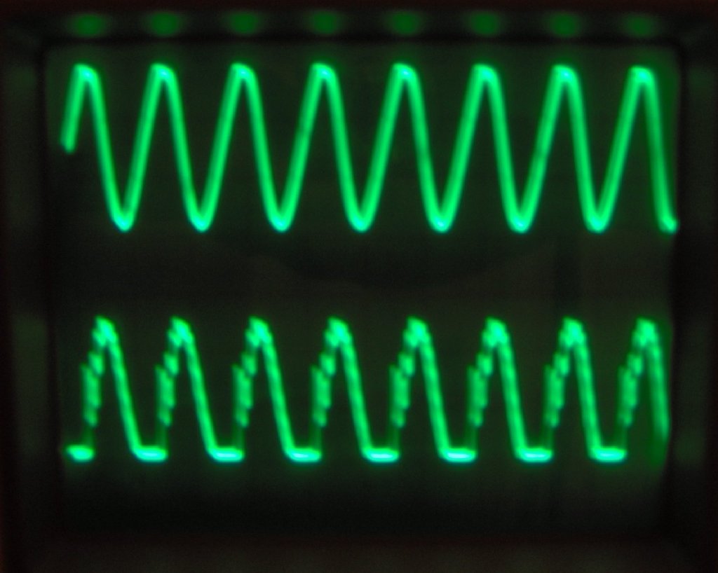

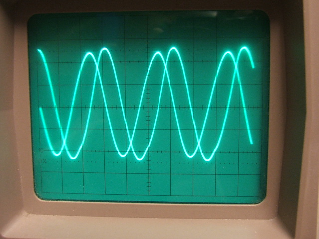

                  Well made some screenshots, transmit sinus is 2 v p/p also the 353-1 is 2 v p/p for the r25 and r26 signals it is 0.2 v p/p ( I hope..... can be wrong )
                  First is LF353-1 then two from r25-q7 then two r26 q6

                    Actually it is not fully anti-clcokwise...Damn! It is a bit over half in clockwise direstion!???
                    Yes i suspected signal from pin 1. of LF 535 at once...!I?

                      Damn! You are right! And i suspected scope!? It is obsolete and very old so sometimes it is doubling ..gramms when turn one switch on it. But this time i am sure it is not a case, cose i cleaned that switch to avoid internal scope hums...Damn!

                        Yes - these all look as expected to me.
                        Ivconic - study these waveforms. This is what they should look like.

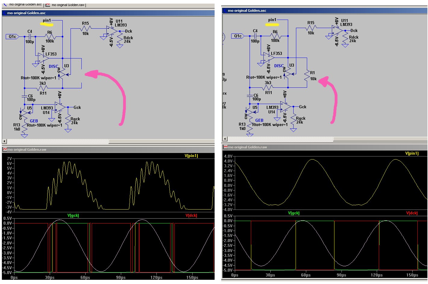

                          • OOh, ooh!
                            Ivconic, the reason that the pin 1 waveform is so out of control, is because you have removed the original GS notch level 10k potentiometer
                            that was directly paralled with the 100k discriminate pot. By removing the notch circuit, you have increased the gain of the opamp - at
                            the same time as you also increase the likleyhood of oscillation because of the higher feedback resistance.
                            Either change to a 10k Disc pot, or parallel a 10k fixed resistor across the 100k pot, and see what happens. It will very likely cause a different curve
                            to the Discrimination potentiometer effect (to be more like the original), but things should smooth out.
                            The LF353 is not a rail-to rail opamp. By having raised the circuit's gain, you have run out of dynamic headroom!
