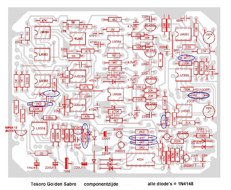

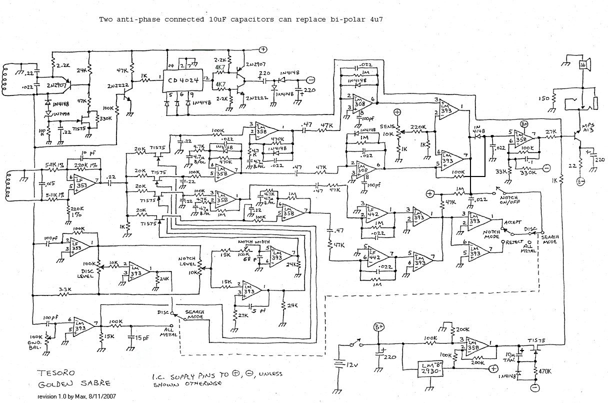

  • Hi all,
    this message is for friends here that need revised schematic and first PCB differences map....so it's easy find the hot-spots there...cause there aren't component label but just values on that.
    So I repost again cause now thread is really long and somehow confusing.
    Use revised schematic values... and you'll be fine.

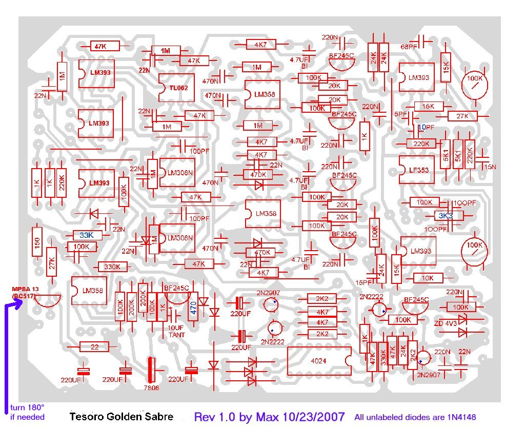

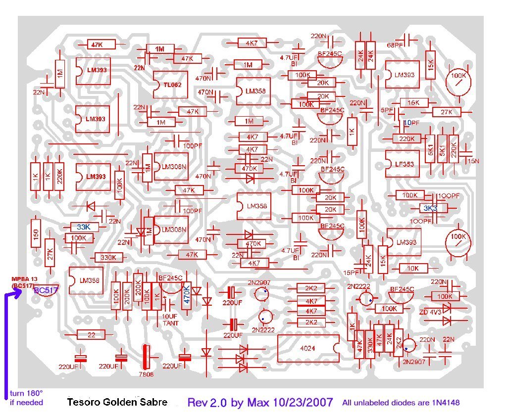

            • Hi,
              this is first PCB with ALL values according with the revised schematic.
              Kind regards,
              Max
              • DEar Max
                470 ohm or 470K which is right?
                Erol Ünal

                  • Originally posted by erolunall View Post
                    DEar Max
                    Erol Ünal
                    470Kohm is right.
                    Thanks for noticed that. Here is correction.
                    Best regards,
                    Max

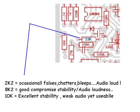

                    • This is ok except this one;

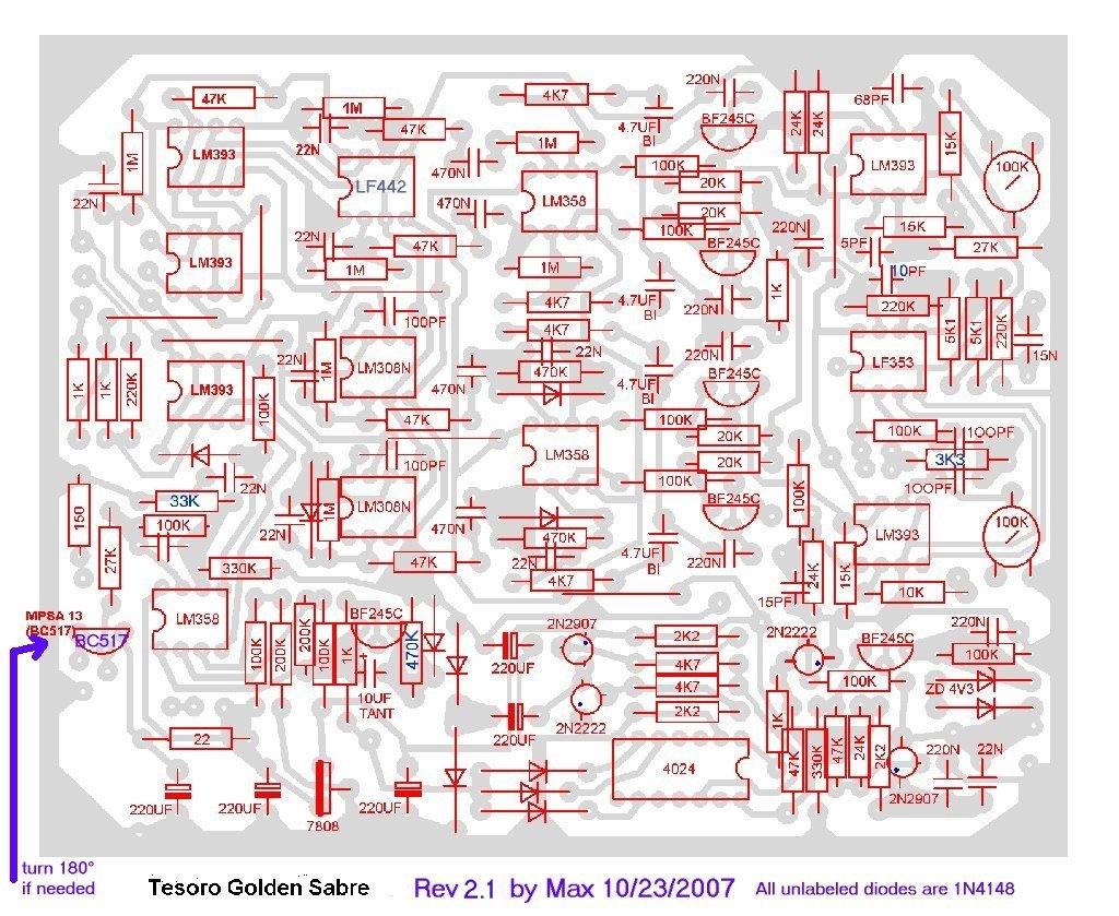

                              yes... but this is actually optimization !
                              I don't use the 33K anymore...from first week after start-up maybe....don't remember. But maybe is better that people here start first with close to schematics stuff... then improving stuff is easy ...changing some resistors , caps... few stuff for big results.
                              I suggest people here start first with unoptimized TGS then go further for max performances... just to avoid problems appears too early in development... like the instability
                              Now I'm posting the PCB again removing the bad TL062 for the original LF442... (people that can find TLC2262 could use it... but this is optimization )
                              Best regards,
                              Max
