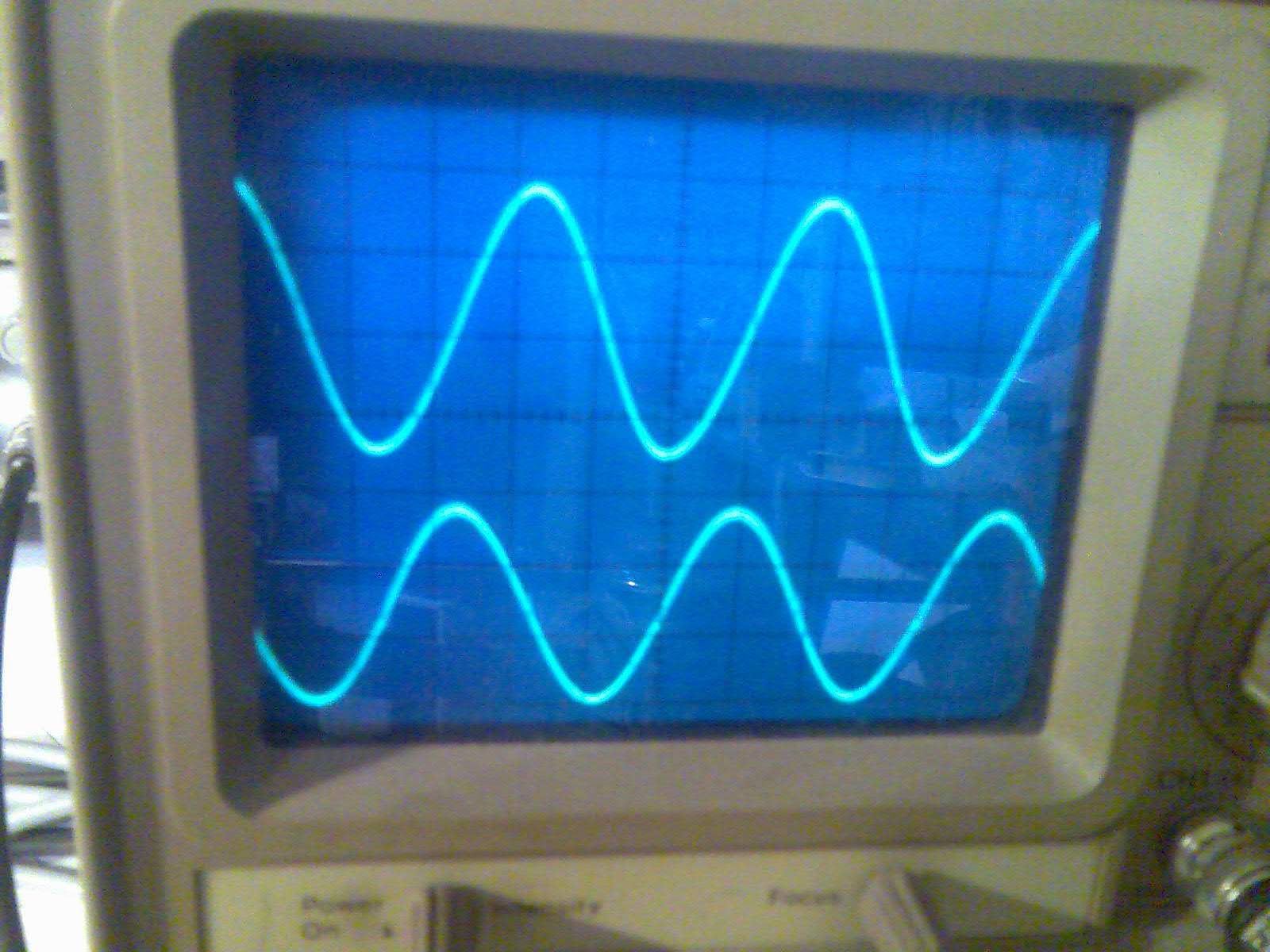

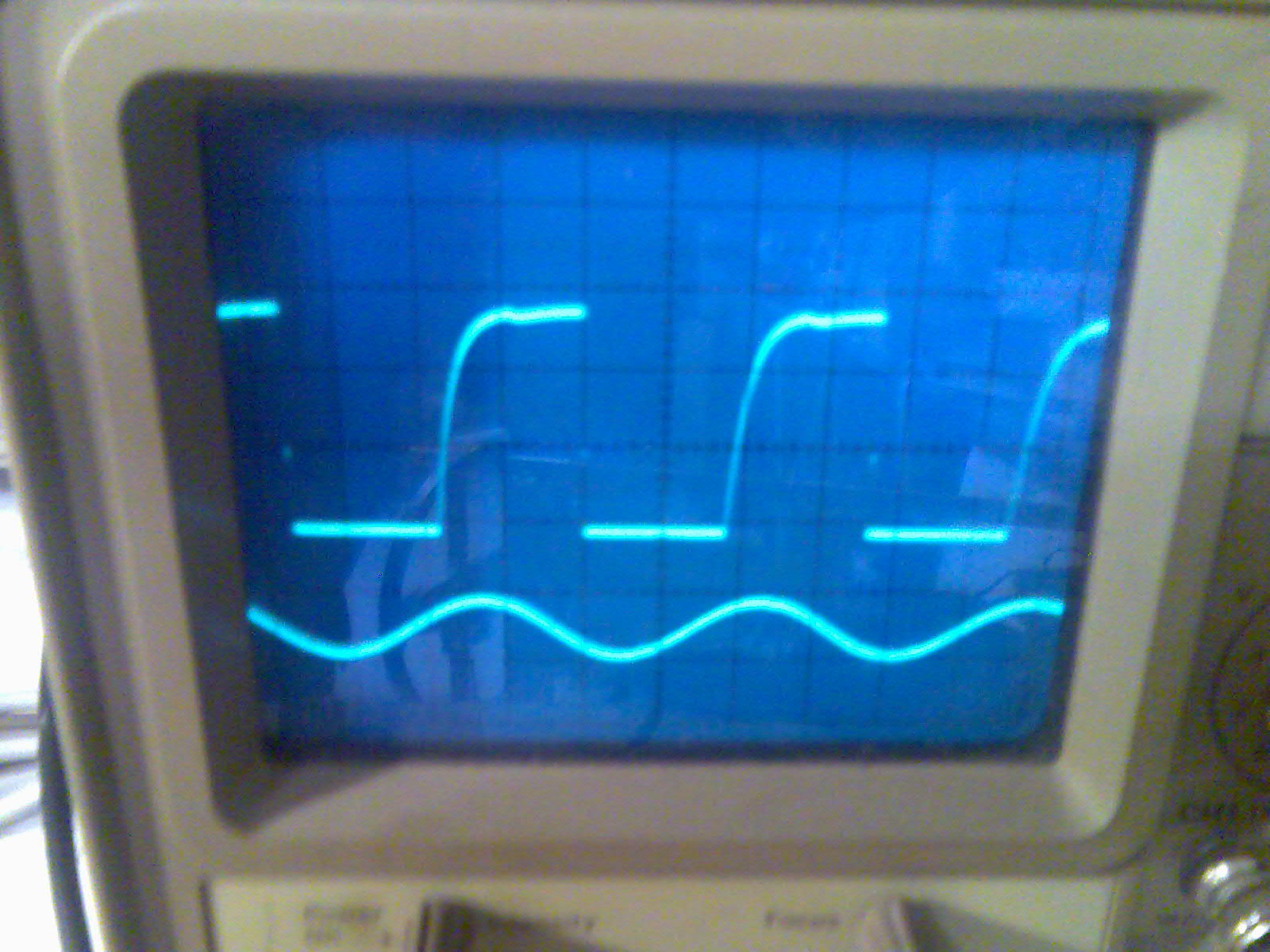

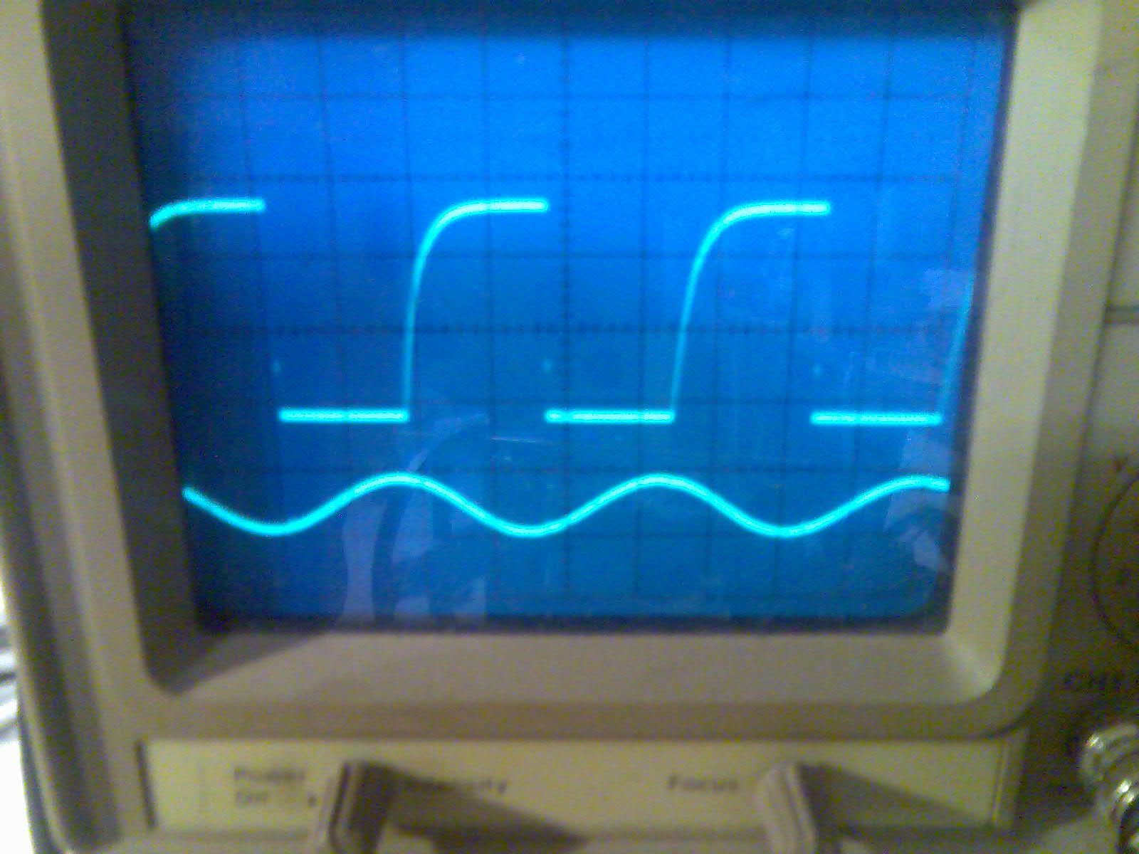

  • Hi. What to say about discrimination. The disc works perfect only for gold , a little for bronze and none for Iron. Do you hear it. What to do the disc for gold and not for iron
    Lets go.
    I attach here some photos. 1st and second are at the out of LM393 with pot at min and max. 3td is the out at "all metal" and "disk".
    Until here all are going ok but the final results are not OK
    to be continues

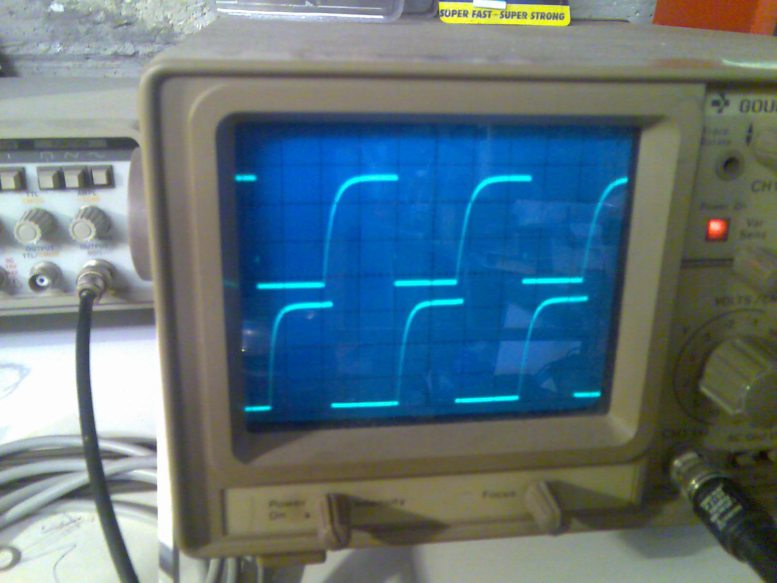

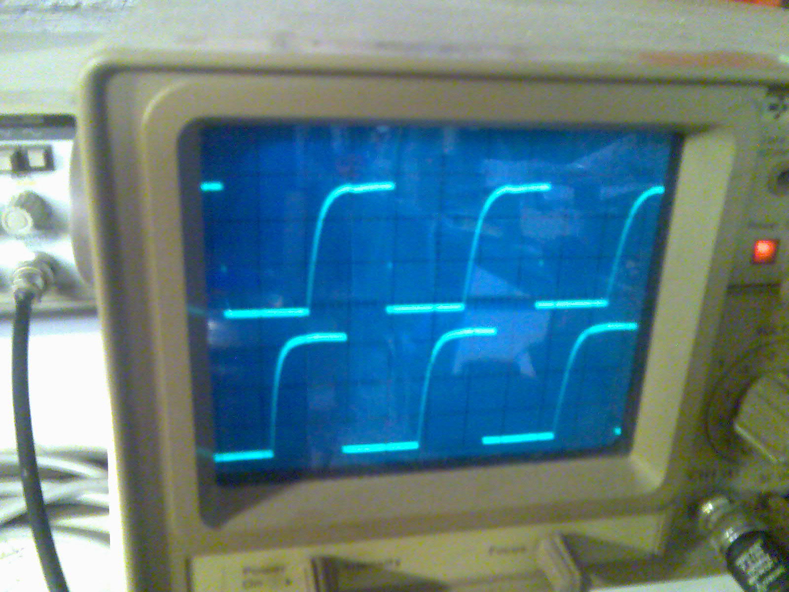

    • I attach here other 3 photos. 1st and second are at the out "all metal" and "disk" with pot at min and max. 3td is the Tx signal (at coil) and Rx at out of LF353 pin7.
      Until here all are going ok???? NO
      I think that i found the problem. Rx signal must be 180degres to the Tx signal. But it has a difference other than 180. Why ????? maybe coil. I must wind a new coil.
      Opinions ??????

          try to reverse RX leads (if you can... I mean if there isn't some connection inside e.g. epoxy that make this last try impossible) and test again... sometimes it works... with a bit of luck.
          If not... you need a right coil there at rx... so you need a new coil.

                        Hi Max. I have reversed the Rx leads without results. So then i checked the rx signal with Tx and i saw a phase difference. Did you checked the phase difference of Tx and Rx winds??? Is there any difference ???
                        When i will find free time i will make a new coil.
                        When i tried to null it i saw that the phase differs from -90 to +90 degrees. Maybe it is time to look it, not only signal null but zero phase shift. VLF detectors are more sensitive to phase shift than to signal null.
