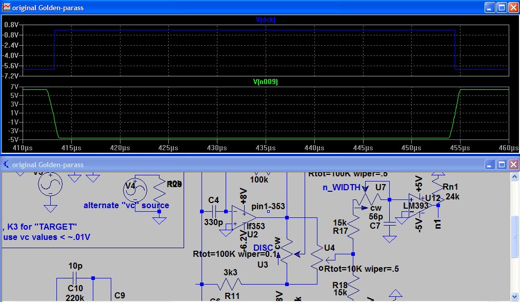

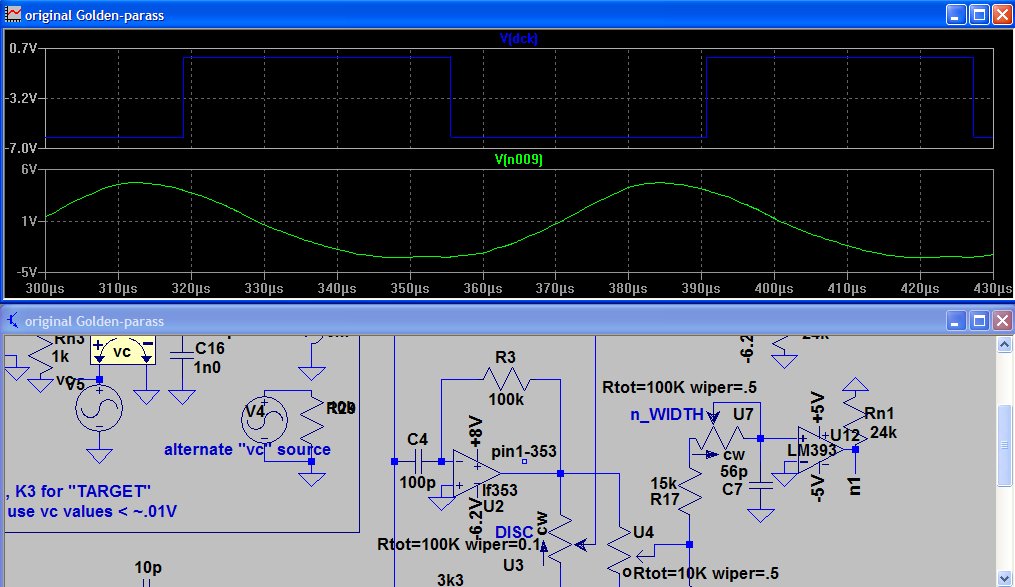

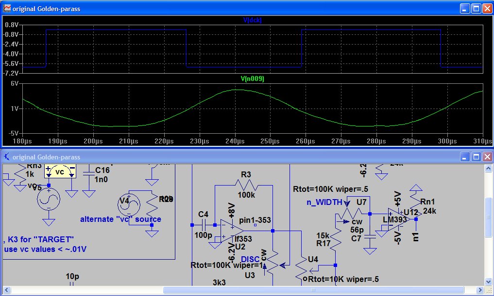

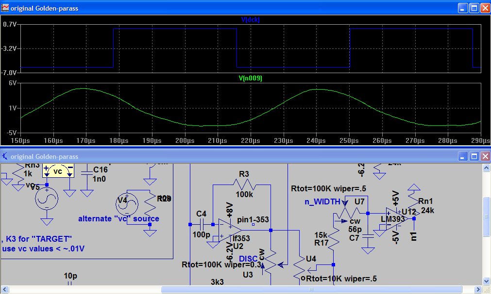

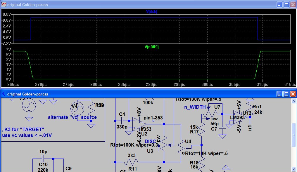

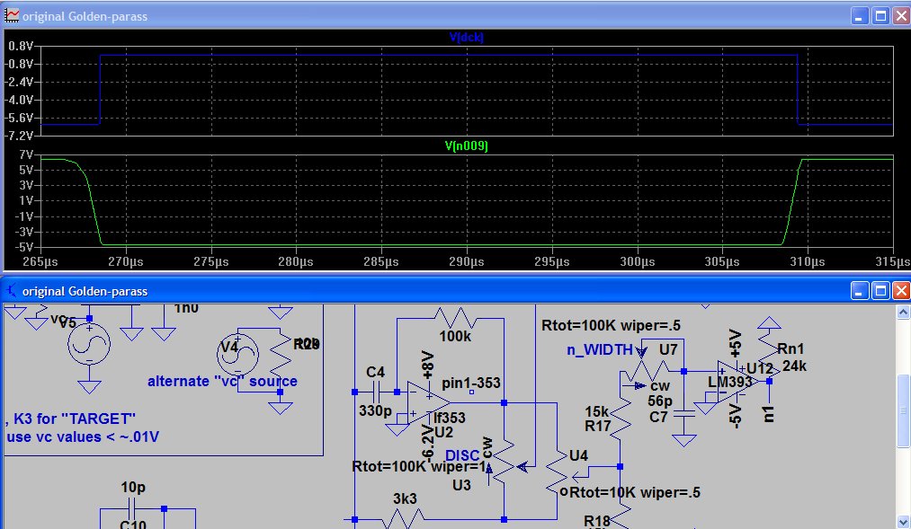

    I've simulated both ways at 3 pot positions: 0.1, 0.3 and 1
    Seems the 100pF way have much more degrees of range... but also 330pF give some adj maybe it's enough to disc foil.
    Look... I'm in a hurry now.
    Kind regards,
    Max
          Kind regards,
          Max

                Hi Ivconic,
                nice to hear you made also progress on osc section using square wave... the power delivered is more that way that a standard sinus but could be problems related to multifrequency jitters... anyway I'd like to see more news by you about that....and how it performs for real on soil.
                About noise and disc pot... disc intervals ...I agree with you: I noticed that moving the disc pot (in TGS also moving the notch pot even with notch disabled) is possible finding "hot spots" where the detector is more and more unstable than e.g. at min disc setting.
                All right about that, and maybe yes the reduced disc range (but still good as I see your writing) help reducing also this kind of problems.
                I think that at particular phase shifts the "intermodulations" peaks sums and you can lost into troubles with erratic or similar to erratic behaviour....bleeping, I mean, at speaker: comparators start commutating easy.
                I have to made some other tests about 220-330pF BTW at which capacitance value you run your very good performant TGSL with still good disc ?
                I found good 220pF but 330pF gave me some problems yesterday.
                Best regards,
                Max
