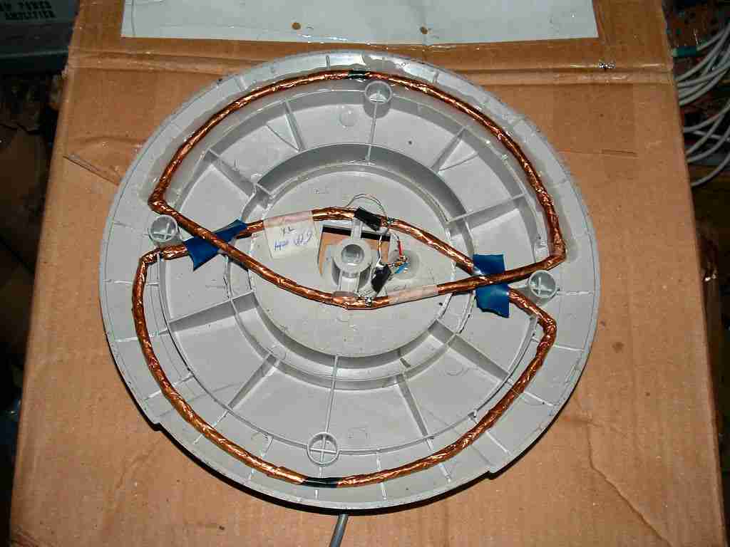

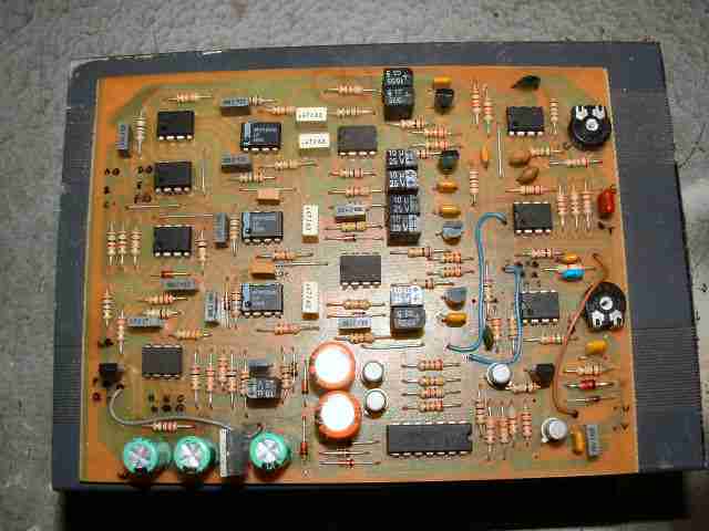

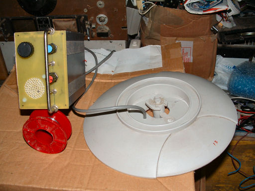

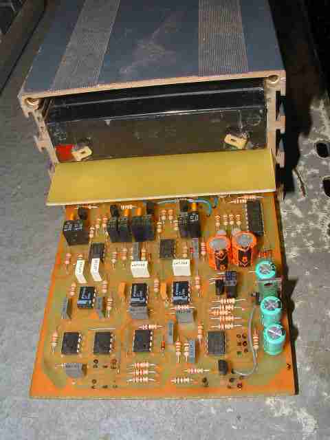

      • Hi,
        Here i post some pics of my TGS : i hope they can be usefull .The coil form is from a CRT monitor support, excellent as very strong, but a bit too small: diameter of the coil is only 22cm.With this coil i could get 25cm for 1 euro coin,same foir similar size of gold, and around 30cm for a big copper coin.
        I will try to improve it a little and build a bigger coils, will post eventals (good) results
        Happy building,
        Fred.

          Hi Fred,
          you have to try Ivconic's design of DD coil to gain better sens. If you results are good with an smaller coil you'll be surprised with the large one.
          Look at other posts, follow numbers and you'll end up with a very good thing at the price of some wire and a bit of patience.
          About overlaps I noticed your coil is heavy overlapped and round shaped in central area: I noticed that the best way is keeping wounds about parallel at middle, like you can see opening a coiltek's one (the ones used in minelabs).
          I suggest you make a big one and null very carefully... then you'll be surprised.
          Kind regards,
          Max
          • Hi Max, Fred, Ivconic….
            Once more I searched PCB for errors and found that 100k trimpot in GEB section has no resistance. Maybe this can explain strange behavior of audio section in past? I replaced him and now TGS works better but sensitivity remained 20cm. I changed already LM308 with new ones and instead TL062 I place LF442 one and after that sensitivity become a bit better. I noticed in the meantime that a sensitivity control has no influence at machine. No difference with sensitivity pot turned at 1 or 10. No changes. I know that right now I don’t have coil in which I can swear is nulled properly but in the past with this same coil gained much better performance. I start to suspect that my PCB isn’t good, etching in hurry etc. Now, maybe I pay tribute for my impatience. I think maybe is time for me to give up from TGS for now and try Goldy or Vladimir’s PCB and then with this experience back to TGS again.
            Darko
            • Originally posted by Darko View Post
              Darko
              if sens pot have no effect on your TGS there is some mistake... maybe in coil. When things are right it gives maximum sens at max position but when at minimum you can always detect stuff but at lower range. I think that is a regulation say from 70% to 100% of total...so just on 30% of sens regulation starting about from 70.
              But that may change from one homemade to another cause of tollerances of components... and coils.
              If coil is no good or you have problems at preamp and the like I think you couldn't notice that behaviour cause maybe your detector sound when signal is already strong (near target)... then you are already under 70% of theoric range... thus giving no variations.
              If it isn't coil:
              you have to check the signal path... if preamp is ok you'll focus on fets and then 308s (or other ics there)... and then on comparators after the sens pot.
              All parts can give that problem if there is a mistake or wrong stuff/values: an example are fets ... you can use different kind even various versions of the same device like BF245A,B or C but there are differences about cutoff voltages... then your devices could work bad if not compatible with TGS sampling voltages commands at gates.
              The original fet TIS75 has e.g. min VGSoff -0.8V and max -4V ; but the BF245 has min -0.5 to max -8V that's a huge difference.
              If you consider the worse case you need really -8V to switch off them then you'll get into troubles cause maximum negative voltage for TGS is -6.2V and command line of fets don't reach that value but something less around -6V.
              So... your fets, in the worse case, could remain partially closed... that's why is so important having a scope in that measures: you can see if e.g. sampler part works ok or not. For other parts is the same... looking at signals is much more efficient way of finding mistakes in circuits.
              Best regards,
              Max

                  • Hi Max,
                    Thanks for your comments,
                    Yes i will build a good DD coil, i already had made some experiments with it but as i lack a good housing i prefered to make a smaller one that i could actually finish - even if performances are not so good.
                    I have noticed also that with a badly nulled coil sens pot make almost no difference.
                    I was able to achieve a nulling of less than 50mv at output of opamp before shielding, but after i put the shields it was not so good.And in the next one i will folow your advice about overlaping.But with that form it was no easy.
                    Best regards!,
                    good luck to all builders
                    Fred.

                        Hi Max,
                        Thanks to your help and advices problem solved. It's a bad FET's. Now TGS works just as before burned. Thank you for help.
                        Darko

                              And Fred, thank you for yuor advices. And thank you for pictures of yuor TGS. Yuor TGS looks great. About housing. What kind of box it is? Looks wery nice and practical to pack TGS into. I have my own design look likes in my Avatar. It's not poor but require quite time for making one and because of that I looking for already maded box which will be good for TGS.
                              Best regards,
                              Darko
                              • Hi Darko,
                                The housing is form an old comercial Italian radio system, really it is the right size,i just had to file a litle the sides. The problem is weight,it is extruded aluminium.I dont like very much the front panel i have made, i may change it .I am also waiting for some wire to make more coils experiments.
                                did you made your front panel from some software? looks really good.
                                Happy building,
                                regards,
                                Fred.
