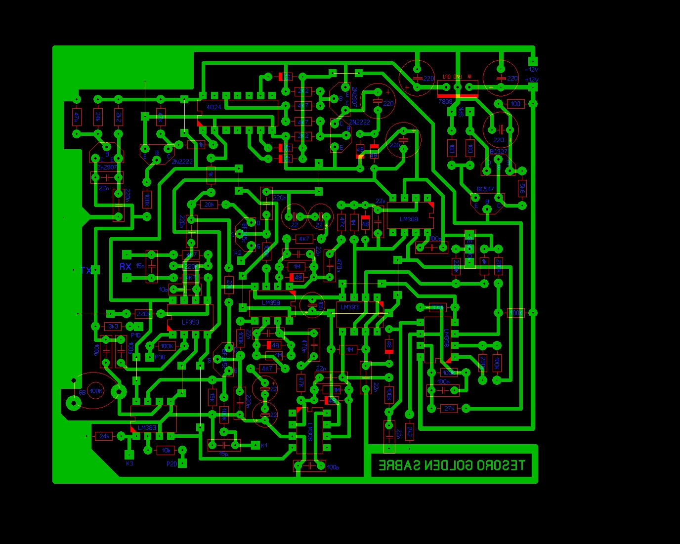

    Can anyone here tell me how i can flip the board on the pdf format? because i dont know how to do it.
    Or can someone post me a ordenary picture I can put onto office, because then its so easy.
    Many thanks in advance
    Dave
    install pdf creator
    when printing choose instead of your standard printer pdf creator
    the file goes redirected to pdf document instead of paper sheet from your printer
    i put the pcb into word.doc they are easy to fit into right size so
    but do it like you want
      Dave
      Download the Gimp Image Editor (it's free) and import the PDF file. You can then flip the image either vertically or horizontally.
      • Gimp image editor
        Many thanks its so easy to use, quite powerful considering its only small download and free.
        Warm Regards
        Dave

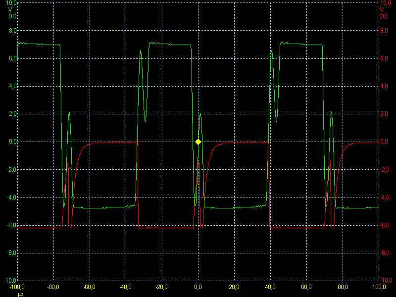

                    Hi DtM!

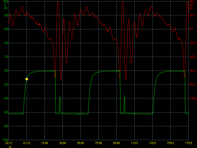

                    3. I would like to see some more graphs of your LF353 output at pin 1 (compared to TX signal on other trace) for different values of C9. What value of C9 makes the ringing completely disappear? Maybe go down to 50pf, 40pf, 30pf, etc.
                    Actually, it looked pretty good at 68pf from your graphs, I would choose that value to keep maybe. It would be interesting to see your sync pulse at max and min DISC pot setting with C9 = 68pf.
                    Cheers,
                    -SB

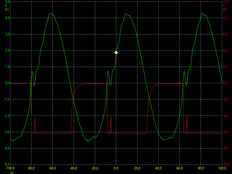

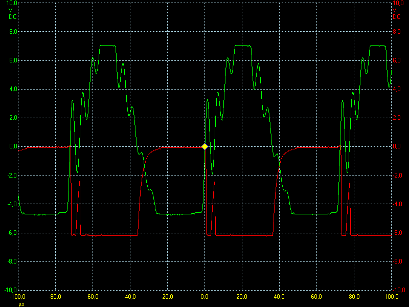

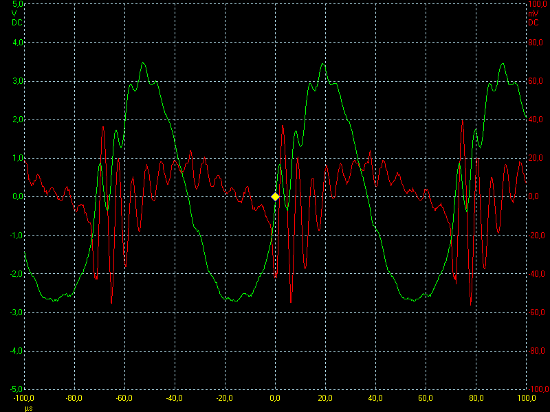

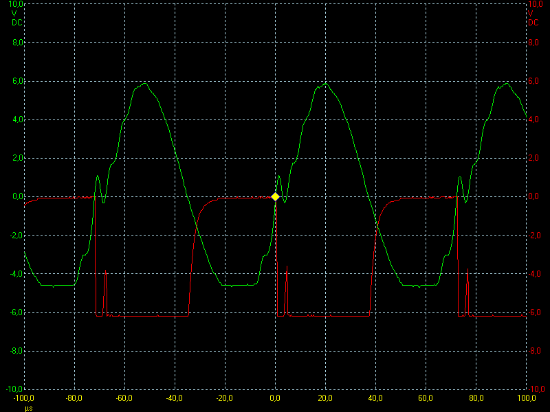

                    I've did a small test with different C9 values but is seems that within the range of 60 - 90 pF you the 'best' Disc signal/ shape output LM393 pin 1 ( varying of course from pcb to pcb ).
                    This a picture with 68pF for C9 : Output pin1 LF353 vs output pin1 LM393 DISC signal with Disc pot at minimum / 0% .
                    Still a little spike, only at the minimum of the disc potmeter
Name:	68pf 0% disc pot.png
                    This 80 pF has also the same spike only at the minimum setting for the Disc pot
                    Only the complete signal at the output LF353 increases.
Name:	80 0% disc pot.png

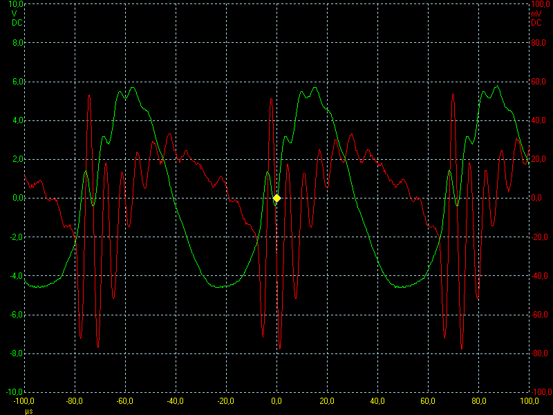

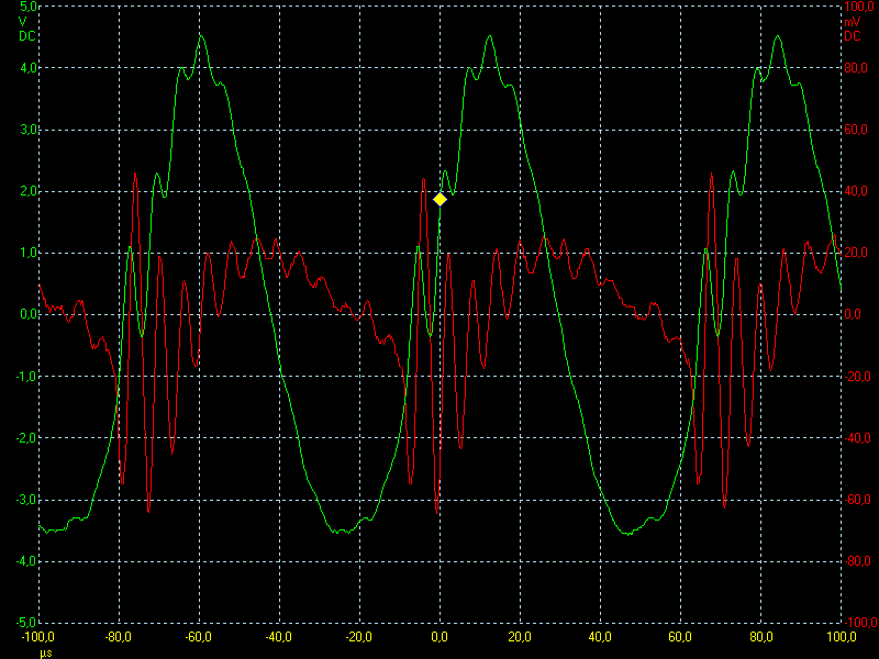

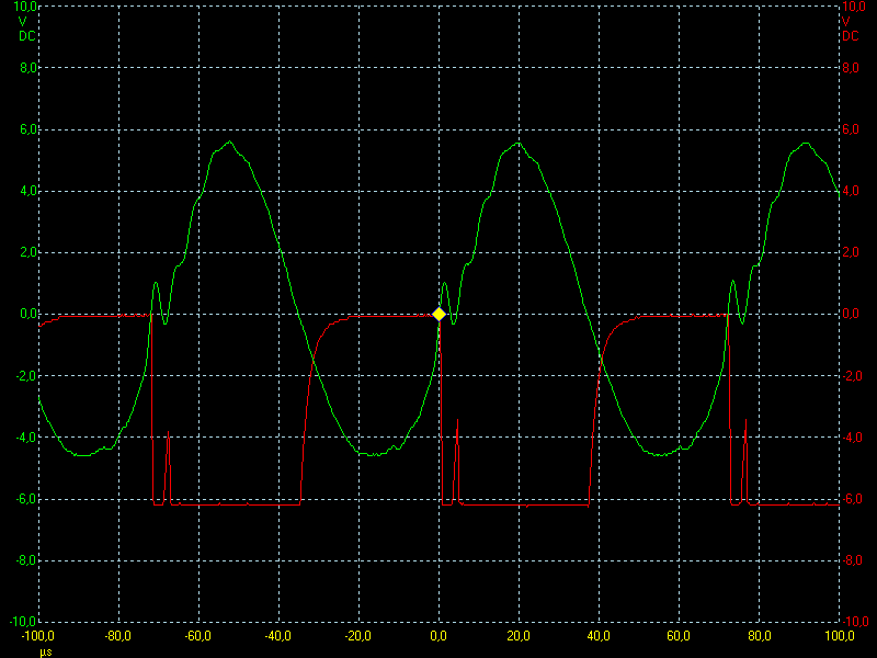

                    A 100 pF for C9 gives my pcb the best cards in terms of a Disc signal without any spikes over the complete range of the Disc potmeter ...
Name:	100pF 0% disc pot.png
                    122 pF gives spikes again even at 50% of the Disc potmeter
                    0% :
Name:	122pF 0% disc pot.png
                    50% :
Name:	122pF 50% disc pot.png
                    and 168 pF : the ringing somewhat disappears
Name:	168pF 0% disc pot.png
                    As said before : this part of the circuit is pretty forgiving and if someone has problems with the spikes a different value for C9 mightbe considered .
                    Kind regards ,
                    Dennis the Mennis

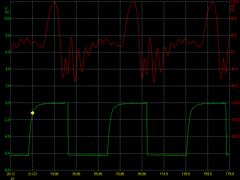

                          Hi DtM - great pics -- raises some interesting questions!
                          I assume the red traces are the output of LF353 pin1. When I look at the voltage scale, it looks like the signal is approximately 100 mV p-p. Is that correct????? If so, something is really wrong! The output of LF353 pin1 should be 10 volts peak-to-peak at least!
                          Would you double-check that? Maybe you measured a different point?
                          Anyway, the sync pulses look good shape, which is what matters. But for good stability, you want a healthy input, so tell us what is happening with the LF353 pin 1 -- something is strange there.
                          Also, looking at the graphs of the LF353 pin 1, I see many zero crossings that I would expect to make spikes in the sync pulse, so I'm wondering if you probed the correct point? Let us know!
                          Best regards,
                          -SB
                            I did and you were right ( of course ) , I messed up LF 353 pin1 and pin2 , the other side of the 100K ...
                            Normally it is pretty late when I post something ... must have been sleepy, my workshop noise usually becomes less after 00:30 hr , don't know why.
                            Best regards,
                            -SB

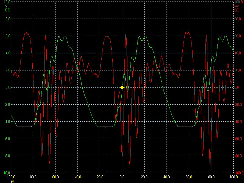

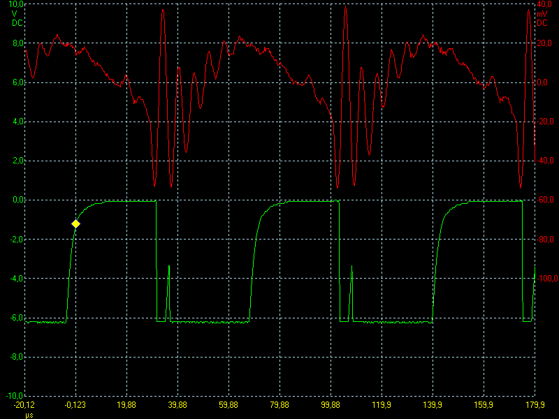

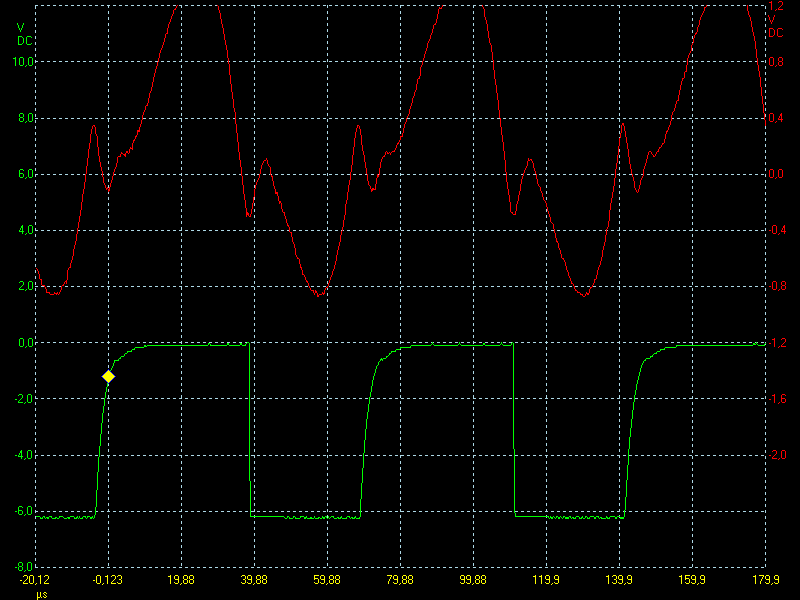

                            Hi Simon ,
                            Thanks for your reply ,
                            To be sure no one gets confused I've made some graphs again of :
                            - pin 1 vs pin 2 of the LF353 and
                            - pin 1 LF353 vs LM393 pin 1 (Disc Sync Pulse / all these examples at 0% of disc pot)
                            for 51 , 68 , 80 , 100 , 122 and 168 pF .

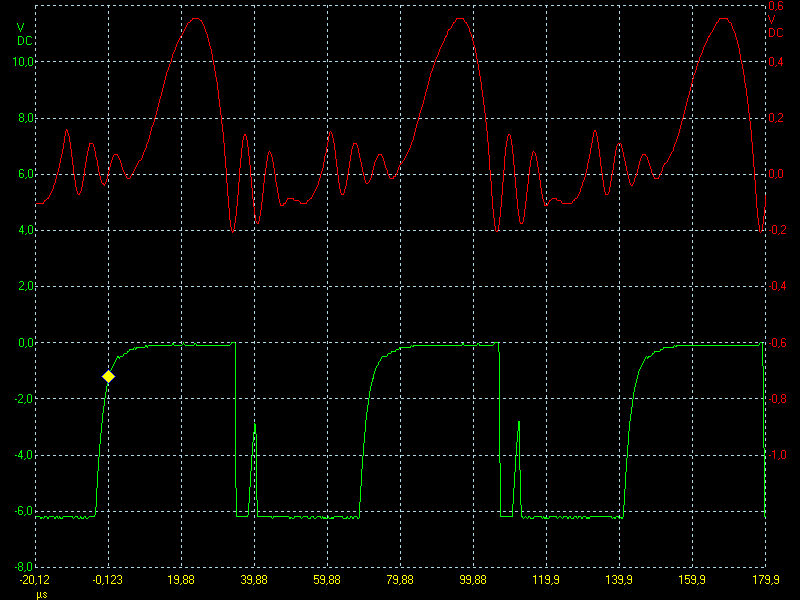

                            51 pF :

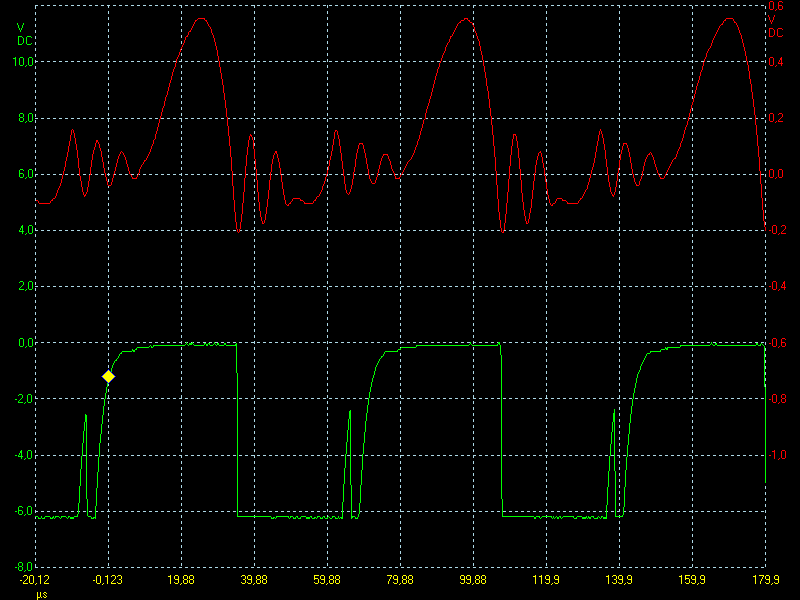

                            68 pF :
Name:	68 pF + Disc.png
ID:	328728 Click image for larger version
                            80 pF :
Name:	80 pF + Disc.png
ID:	328730 Click image for larger version
                            100 pF :
Name:	100 pF + Disc.png
ID:	328732 Click image for larger version

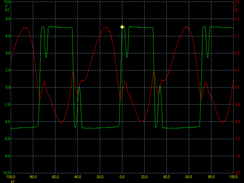

                            122 pF : ( from 0% -40% of disc pot the spike remains )
Name:	122 pF + Disc.png
                            168 pF :
Name:	168 pF + Disc.png
ID:	328735 Click image for larger version
                            In my case it is impossible to make a 'perfect sinus' ...
                            But as said before : the secret of the Disc Sync spikes is revealed ...

                              Thanks DtM, I can sleep at night again...
                              Your (actual) LF353 pin 1 looks pretty normal, and those little spikes on the sync pulse usually don't cause a problem (even though I don't like them and made some mods to get rid of them).
                              I've never seen a graph of LF353 pin 2 before, so... interesting! But generally we don't care what it looks like, if pin 1 looks pretty good. However, it might be useful someday to compare our pin 2's. Because it is a "virtual ground" according to op amp theory, it is hard to interpret (for me).
                              Anyway, I would think your DISC mode should work OK -- if your sync pulse phase range (min to max) is normal compared to TX signal phase. It looked roughly OK to me, but we can check some more.
                              I think you already checked this, but it is useful to check the voltage on C15 as the DISC pot is turned from min to max. It should not go below -.5 volts, otherwise could be a problem.

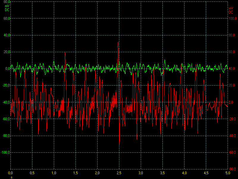

                                The question what should be a 'normal' noise level for TGS kept haunting me so I took my stuff and went to my testing ground in the middle of the meadows just outside of my city.
                                No sheep this time ...
                                Here's a graph measured on the outputs of the LM308's .
                                Normally I've only measured the noise on one of the outputs just because I can clip my probe easy on it and in the assumption that the noise level would be the same on both outputs .... not .
                                I've never expected such a difference between both channel .
                                Noise on the outputs of the LM308's with a shielded coil in AM mode:
                                Green for the output of the GB channel and Red for AM/ DISC channel
Name:	noise am mode shielded.png
                                Noise on the outputs of the LM308's with a shielded coil in DISC mode:
Name:	noise disc mode shielded.png
                                Now I for sure that :
                                -The noise level should be very low , 5 -10 mV in the field , but I never achieved this in my workshop which is usualy somewhere between 25/30 mV till skyhigh , with even spikes running trough and really unpredictable.
                                - My pcb doesn't generate any noise
                                But why such big difference between the two channels , something must have damaged on my pcb during the trip .
                                I've switched the LM308's but the problem remained on the same place
                                Back to workbanch for further investigations ...
                                This must also explain why some of us suffer from cracks , hums and fals alarms in 'rest' position( due to excessive noise : I think the treshold before alarming is around the 40 mV )
                                To be continued
                                Kind regards ,
                                Dennis the Mennis
