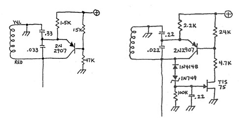

      if you change (actually select) the fet at oscillator stage (amplitude control part) you'll get higher voltage there.
      Usually I see it good at 14-14.5Vpp, but in some cases you'll get near twice the supply rail like in the ideal case -the famous 16Vpp-.
      The original TGS was with TIS75... but I think , cause of tolerances of devices, any Tesoro TGS had little different amplitude of output signal... not really all running at 16Vpp.
      The fet kind also impact on non-linearity, but much more the PNP transistor you use... low gain ones give a sharp bump on signal.
      Kind regards,
      Max
        Strange? I omitted whole fet part from my last few TGS's and it is working the same. Also get 16vpp the same as was in the past.
        I think fet part with zener is just sort of "fuse" there and in normal conditions do not affect signal amplitude at all. It is inactive all the time. Fet is "opened" and actually 2N2907 base is connected via 47K to ground.
        You omitted it, but short S and D terminals, right ?
        That way base goes to GND by 47K.
        It's an amplitude regulator... change transistor polarization to give steady output voltage.
        Some Tesoro's oscillator haven't the fet stuff... others, like TGS, have it instead. The difference is small.
        I think it was added to give extra long time stabiliy than in versions without it.
        Also, when strong temperature changes happens the just transistor approach could give consistent variations at amplitude of TX.
        In picture I report same stuff of an old thread about silversabre: on left it's silversabre-osc, on the right is eldorado-osc.
        Note the difference from TGS: in eldorado seems there's a 4K7 instead of 47K and NO 330K resistor at S and D.
        So, we have , at least, 3 different strategies by Tesoro in their MDs:
        - silver-bandido, with no fet section
        - tgs with fet 47K and 330K
        - eldorado with fet 4K7 and no 330K
        But which is the best ???
        Kind regards,
        Max

              I look at Eldorado thread, schematic has 47K just like TGS. Is there another schematic?
              Another possibility: try pot with fet, tune the coil voltage for max volts without distortion... Not easy for Tesoro because production environment, but easy for us! But if doesn't matter anyway... Only way to know for sure is use pot, test with very deep target barely detectable.

                  I think you're right... in Eldorado it's like TGS, I think I made a mistake following that old Leto's post here:
                  https://www.geotech1.com/thuntings/s...ad.php?t=13145
                  Maybe the 4k7 one is from Inca ?
                  Anyway, there are 3:
                  - silver-bandido
                  - eldorado-tgs
                  - other with 4K7
                  Kind regards,
                  Max

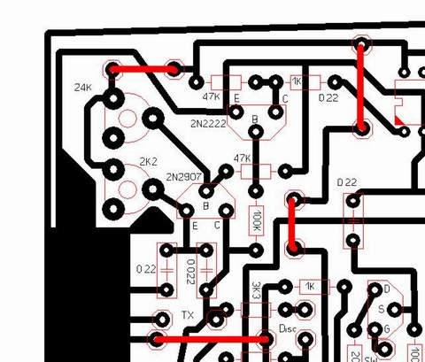

                  • Whatever....i am not using fet part anymore. Of course base of 2N2907 goes via 47K to gnd. I get full 16vpp at collector.
                    With or without fet part i havent noticed any differences in behavior so far.
                    I do void fet part just for reason to save some space on pcb, no other special reason...
                    Other question here is interesting and possibly very important; threshold part? Original setup from first TGS posted here is without any trimmer just with fixed values. On one of my pcbs i included trimm for threshold and gained no benefit form it...
                    So at next pcbs i omitted it again.
                    Audio path is an issue here and must be reconsidered and modded. I tried many times and yet not satisfied..

                          • I think you have right, Max!
                            I would rather adjust resistors there than to keep fet stage.
                            I was thinking to put trimmers instead base and emitter resistors and to adjust those using scope.
                            It was my idea from long time ago...i am just to lazy to do things faster than usually do...
                            Already adapted pcb draw, but dont have time to make it right now.Will be ready in a week or two...
