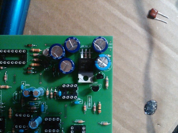

    I don't think it's a big deal.. Just drill one additional hole and feed one lead from the 220uF cap to the end of the 100 ohm resistor. Just add an errata sheet explaining where to drill and route.
    If you have a significant number, just sell them as-is with the mod. I can post how to correct if that's what you want to do.

                  That C27 error doesnt look like big deal to me. One drill and connection to closest GND
                  That C simply decouples relativly hi current speaker driver from rest of the circuit so that battery voltage doest suffer from high current spikes

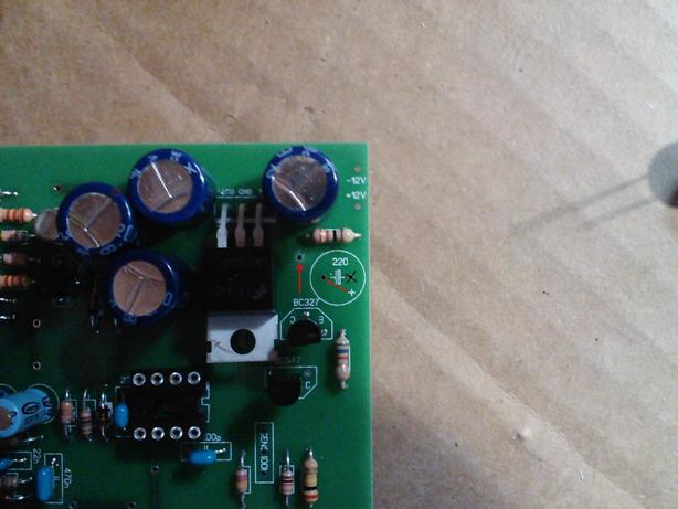

                    Finished my board last night, and below is the only change I had to do.

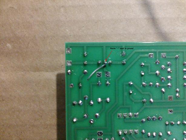

                    For the 220uF cap in the audio section , drill a hole at a 45 degree angle, maintaining the same lead spacing. The new hole will now accept the negative lead for the 220uF cap.
                    Flip the board over and route the negative lead to the center post of the 7808 regulator.
                    That's it!

                    The holes for the 7808 as well as holes for some of the wires to the pots and leads to the coils should be larger..
                    Components that fit on Ivconics PCB will not fit quite right on this PCB.. See the mounting of the 7808. Clearance should be a little more in my opinion.
