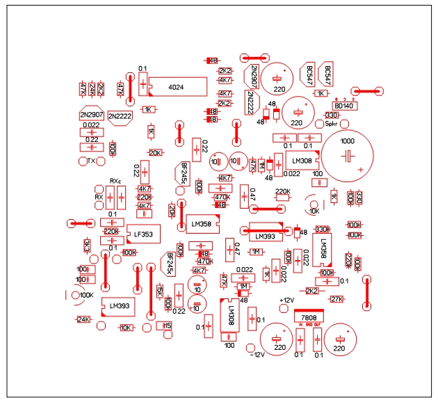

    I forgot to attach the Edited PDF Version of the Placement OC.pdf file (named: Placement OC (Edited).pdf). This file has compatible circumference to the PCB.pdf file, and has now been added as attachment together with the original version from @Ivconic as comparison.
    I apologize for this mishap!
    Robert
    Placement OC (Edited).pdf = Edited Placement OC.pdf file (JPG example given below)
    Placement OC.pdf = Original version from @Ivconic
    PCB.pdf = Original version from @Ivconic
    • Orderable parts list for TGSL
      One of the toughest parts of a project can be ordering all parts. Below is a list of parts that I used for my last TGSL project. Everything works as advertised. Parts match the layout above. The only exception would be that I used J107 for BF247C and TL071 for LM308.
      Don

                • Corrected one line.. U104 and U105 should be a TL071AN or LM308N.
                  Don
