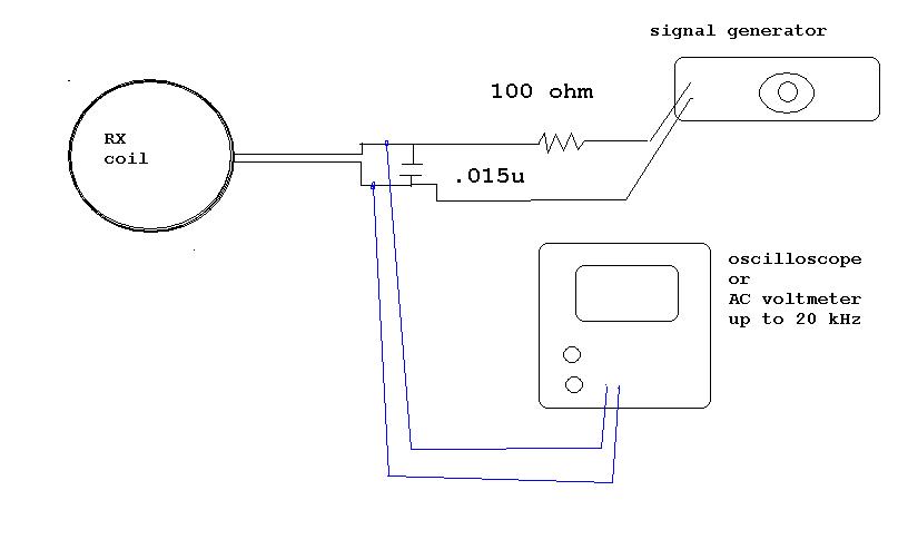

    please how to measure RX frequency without capa and coil calculation
    i mean with digital multimeter which has got frequency meter as well
    thanks

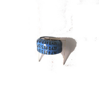

                • Yes Quiaozhi, that's the component! I have almost identical here by me.
                  Acts indeed like real capacitor!
                  So, i was thinking to wire it up at TGSL and observe behavior on scope. First i would like to wire it up at chopper output. Usually it produces -6.2V +/- 0.5V. So.... hopefully this special capacitor will further stabilize and filter negative rail at TGSL. Will try and see later..
                  Also, it would be good to wire it up to TX supply also.

                      have you ever noticed that capacitor-look-like component, usually present in older VCR's? Small component, exactly capacitor look, usually labeled as 0.47F (!!!!) 5V or 6V? Meaning actually 47 000 uF !!! Small...smaller than capacitors we are using mostly here.
                      So.. i took one recently and wired it parallel with one led diode and ps. Switched on ps and second after switched off. Led diode shined (diming down) for 2 minutes after!!!!!
                      So...actually it is capacitor. Hell of capacitor! Excellent to stabilize some voltage. So...here is my funny question:
                      How about, if we use that component(s) in TGSL? On very few places, especially on TX and eventually at chopper output (reversed, respecting polarities there)....ha?!
                      I asume, it will take a bit of time to charge fully from accu. So, after switching on, detector will be ready to operate after few seconds...
                      I never had any experiences before with this kind of capacitors....but shure this look like having some potentials to be used here...
                      I am very interested in your opinion..
                      I had same reaction when I saw it here and I had to buy it: http://www.goldmine-elec-products.co....asp?dept=1028
                      I know it must be good for something, just haven't figured out what yet.
                      It would be good for something needing sudden large current draw, like a camera flash. TGSL is pretty steady current. Maybe better for PI detectors. I tried bigger capacitors on TGSL negative supply to try to get rid of voltage spikes, but didn't help - they are too fast, smaller caps work better. Can't seem to improve on TGSL....
                      I think also might be good for micro-power projects, like solar powered radio beacon, etc.

                          By RX frequency, I assume you mean RX coil-capacitor resonant frequency.
                          You need to get a signal generator which can make different frequency sine waves.
                          You need to connect the output of the signal generator to the RX coil (which is parallel to the capacitor) -- put a 100 ohm resistor in series with the signal generator output also.
                          If your multimeter can measure AC voltage up to 20000 Hz, you can use it. Otherwise, you need to use an oscilloscope.
                          Measure the voltage across the RX coil and slowly vary the signal generator frequency from 10000 Hz to 20000 Hz. When the voltage is highest, that is your RX resonant frequency.
                          -SB

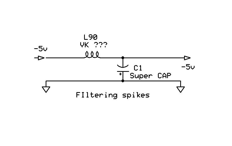

                                Actually, i was thinking to experiment with more complex filtering;
                                super cap and small choke.
                                Now, job is to accuratelly calculate choke for this filter... we have 3.5-7kHz (approx) spikes there.. So choke must cover that bandpass.
                                Hmmm.... i would not be offended much if somebody help here with choke calculations..!
