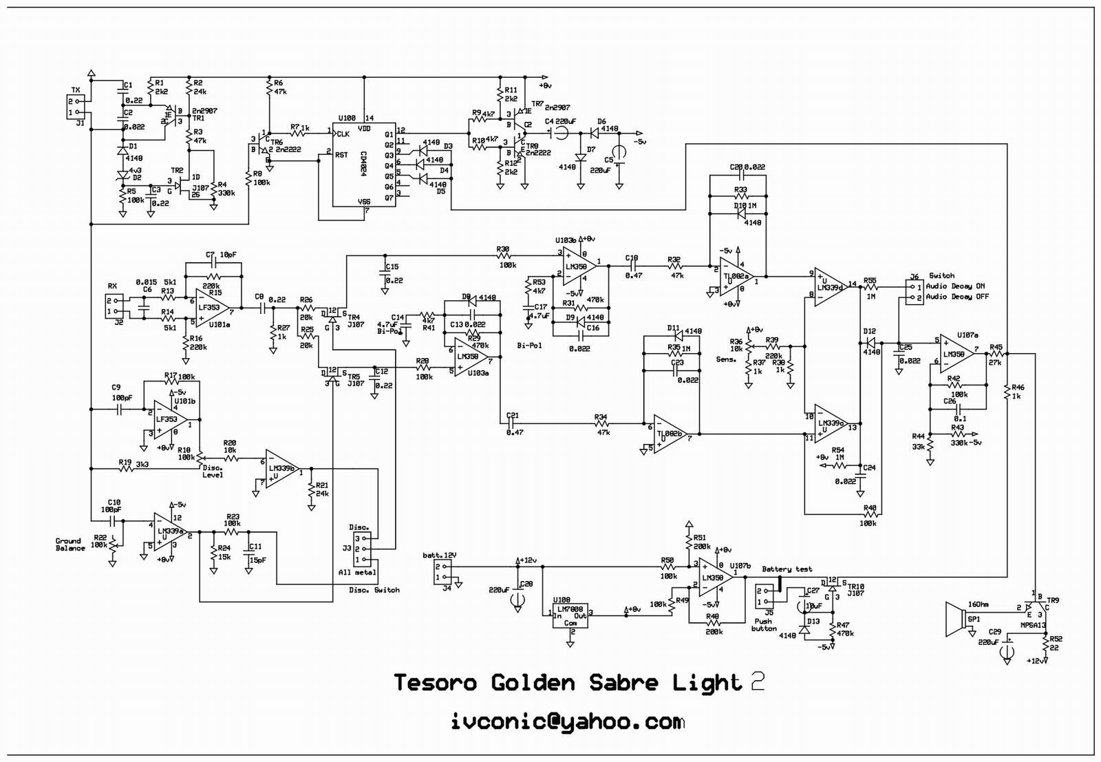

                        I was thinking to make "Light" version even more simple;
                        Instead those two LM308 to put one TL082, alos instead LM393 to put LM339....?
                        What do you think people? It will work or not?
                        I'll post schematic these days....

                            Just pay attention on pin assignments...Yes, you may try LM1458 instead
                            LF353 for example....or TL082... buyt just for comparsions...
                            I am not satisfied with LM1458....but TL082 works almost good as LF353?
                            Now back to schematic; Yes! Again i made mistake! I omited those 2 resistors!
                            Damn! How it is possible? I guess it was in rush...not so good with software
                            for schematics...Thanks Porkluvr a lot again!
                            OK, now, for the last time, there is absolute correct and accurate schematic!
                              Why waiting?
                              Here it is!
                              • PCB?
                                Need one good soul to draw pcb for it!
                                Come to think; it is not Tesoro GS anymore!
                                Can i patent this!?
