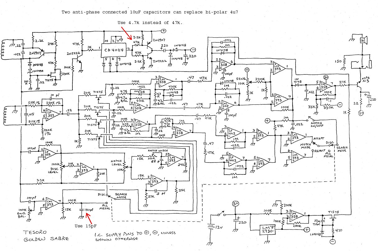

      What do you think people? It will work or not?
      I'll post schematic these days....
      Why waiting?
      Here it is!
      Hi ivconic,
      I think lm339 mod would work great. I have some dubts on TL082 instead of two LM308... these dubts is related to hi-fi audio circuits experiments I've made with dual op. amps... never get good results where there dual pramp... and expecially TL0x2 series... but they aren't preamp there.
      Maybe there would be ok! Think that only way to know is made a prototype.
      Also you could exchange TL082 with other things (e.g. NE5532) if a few mA more is not a problem (and many other newer stuff with very low noise if you can find).
      Why not!? circuit would be even smaller!
      Best regards,
      Max

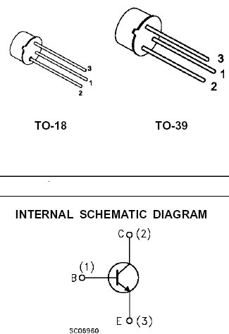

                            metallic case ??? PN2222 in metallic case ??? strange.
                            Anyway, metallic case 2222 are 2N2222 (to-18 ). Look at the picture.
                            The small piece outside indicates E, the central is B and other C.
                            Best regards,
                            Max

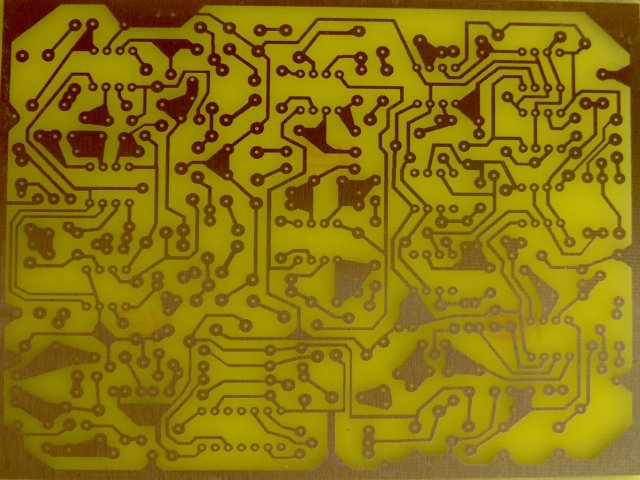

                            • Start enjoying GSabre
                              (Have to drop my acrobat reader in the trash can... one day or another)
                              I like .JPG schematics!
                              Kind regards,
                              Max
                                Nice work!
                                Its very enjoiable!@!!!
                                I work much,but havent sleep for a 2 days and everything were ready!
                                I sleep less than 3 hours if I am lucky to even get some!
                                So its nice and easy!
                                ehm yes... required me much efforts... about total of 40minutes of work!
                                Smoking cigar also that time! Trick is "kind of a fog" ?
                                (or good positive pcb, film and UV-radiations ???)
                                I think that Fog is half work here!
                                So keep smoking my friends... at least when you try to make PCBs...
                                I suggest 1 Montecristo/PCB minimum
                                Best regards,
                                Max
