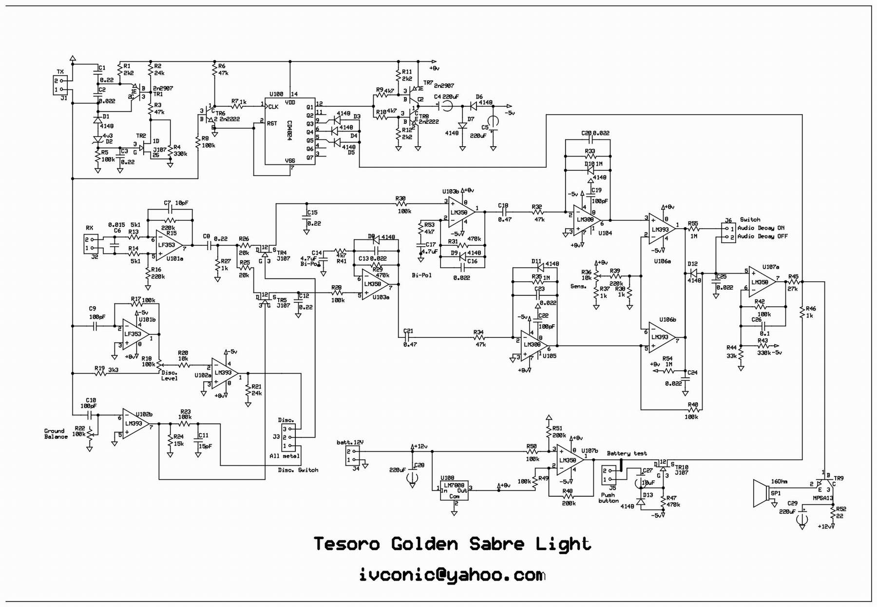

        Hi tiktak,
        Ivconic maked a really good work on this PCB and version of GSabre.
        It's intended to host a normal speaker and headphones socket too.
        As in bought detectors! Nice.
        I'm planning to make it too... soon, but have to find some time!
        really simple... look at schematic... you'll see speaker 16ohm, right ?
        That means just a small lo-imp speaker to be mounted inside the box.
        Ok, R point is just connected to resistor 150ohm that goes to gnd.
        You could use it to drive e.g. normal headphones connecting both channels to R point and P point.
        Just use P, Q points as in picture for suitable (larger) speakers directly.
        Meaning of having 150ohm in series with your phones is adjusting output impeadance to suitable value and also reducing audio volume... You could leave out 150ohm resistor using e.g. hi-imp headphones (a quality set of, with volume control(s))... but is your choice.
        Better if you wire a jack-socket on panel and then have internal speaker normally connected to P-Q point... and then inserting phones jack disconnect internal speaker and connect phones to R-P point as described.
        Very easy. Very useful e.g. if you need to work on noisy fields... and you need just headphone.

                      0.30mm is close to 29AWG (28.73mm) that have a resistance of 268.4024 ohm for 1km so 0.2684 ohm/m.
                      But this is intended for bare wires, without varnish.
                      If you have 0.30mm varnished you actually have something between 0.27 to 0.28mm diameter of internal conductor (varnish thickness could vary from manifacture to another, kind of insulations etc).
                      So I'll assume you have about 0.28mm diameter (bare) wire, so a 29AWG.
                      You need to match the tesoro range (18-24 ohm for both windings). and so it's relatively easy know how many turns you need if you know the former side lenght. Assuming you would like to build a 22cm DD coil you need a former that have something like 18cm diameter former (this depends much on how much you want the overlap zone is wide...) and then 56.52cm of circumference.
                      OK. Assume you want 22ohm of resistance you need :
                      22/0.2684 = 81.96 = 82meters
                      and so 82/0.5652 = 145 turns
                      D=21cm (diameter of former? seems big!) you get
                      circ = 21*3.1416= 66cm
                      so 82/0.66 = about 124turns to get 22ohm

                          yes, but not inside coil housing... not required. Just change they to suite needs, so having close to original freq. on tx side and, if needed, change on rx side other cap. Just do it on PCB directly.
                          Referring to tx:
                          0,30 mm and 124 turns if you use larger former diameter 21cm, more wire in one turn
                          and then 145 turns if you use 18cm diameter former ...to make windings.
                          You can make both tx,rx same number, but I suggest this:
                          wire 0.30 - former 18cm diameter - TX=145 turns RX=160turns
                          would be fine I think.
