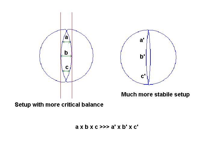

                      Anyway, i have few more notices for you people;
                      First, i made several coils for TGS, all of them are DD.
                      I usually used old proven method, like so many times
                      described here.No need to repeat again.
                      But let's back to good old Minelab coils; those are
                      working very good!
                      Have you ever took a good,steady look on those shapes?
                      Minelab DD coils are all simillar,but much more different
                      than any hand-made i ever seen....
                      Angle of overlaping is less than at usuall hand-made?
                      So i tried to "copy" that shape and see what's going on.
                      Finally made a bit larger DD coil with 28cm diammeter.
                      Of course i used 0.25mm (0.28mm with varnish) wire for both
                      coils...
                      Results are much better than expected. 1cm nickel coin at
                      40cm in the air and 33cm in the ground!!!
                      Discrimination - PERFECT! Stabillity - PERFECT! Neither one
                      false signal, no matter if i swing coil,cable...or simillar
                      "torture" due testing stabillity...
                      But i tried to respect Minelab "shape" and overlap coils tight
                      and close, without rising distance between overlaping parts.
                      Also noticed, this way is much easier later to null coils.
                      Usually it takes 10-15 minutes to null coil with a lot of
                      efforts, now; it takes me few seconds to find best "spot" to
                      null those!!!?
                      Except benefits, i havent noticed any drawback of doing this way.
                      Performances are much better now.
                      Minelab...ehm! If you can not beat them, than learn from them!
                      No need for further explanations,just look at picture.
                      I am not sure why this coil is working better and why it is much
                      easy to balance it....i can make assumptions here..but must be
                      some of you more conversant to explain, better than me?

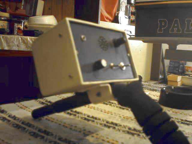

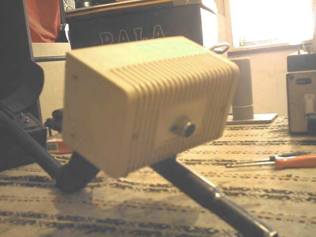

                      Another tip; detector housing...! Ts,ts,ts...i had so many
                      problems in the past to find proper housing for my detectors.
                      Now, it's a piece of cake!
                      Remember good old Hercules monitor for pc XT and later 286/386..???
                      Back side,lid made of plastic,part which covers tubular end of screen!?
                      Simply use small,precise saw and cut nicely that part of plastic and you have
                      very nice housing for detector! Look on the picture...
                      Front panel cut from another piece of plastic....and that is all!

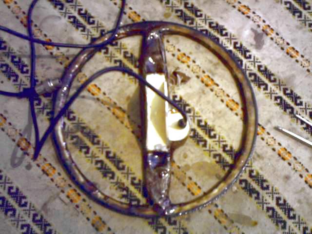

                      • Ugly coil!
                        Ugly coil, isnt it?
                        I made it without much of material....Anyway it is working good!
                        • Hercules housing 1
                          Hercules housing ....
                          • Hercules 2
                            Hercules 2
                            • No of turns!!!
                              OOOH! I forgot to mentioned number of turns for this coil;
                              120 turns for TX and 125 for RX....
                                Very best regards!
                                Hi ivconic,
                                I've noticed all you said too! On big overlapping area I get into troubles with false signals ! I subscribe everything !
                                But I've made my bandido's DD like you said about minelab stuff !
                                And then it works really cool.
                                Thanks for drawing pattern!
                                Best regards,
                                Max
