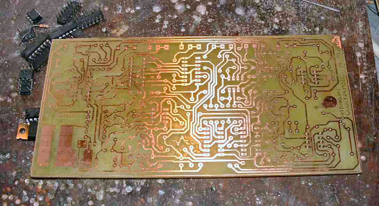

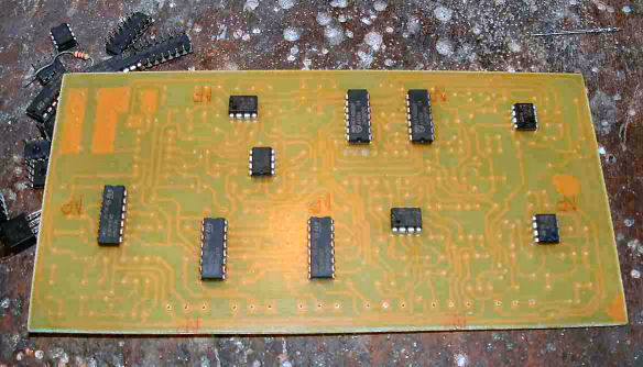

    • Hi Neslon,
      I am using this PCB, same as yours?
      i will use replace TL062 by TL082
      and LF357 by LF353.
      Good luck!
