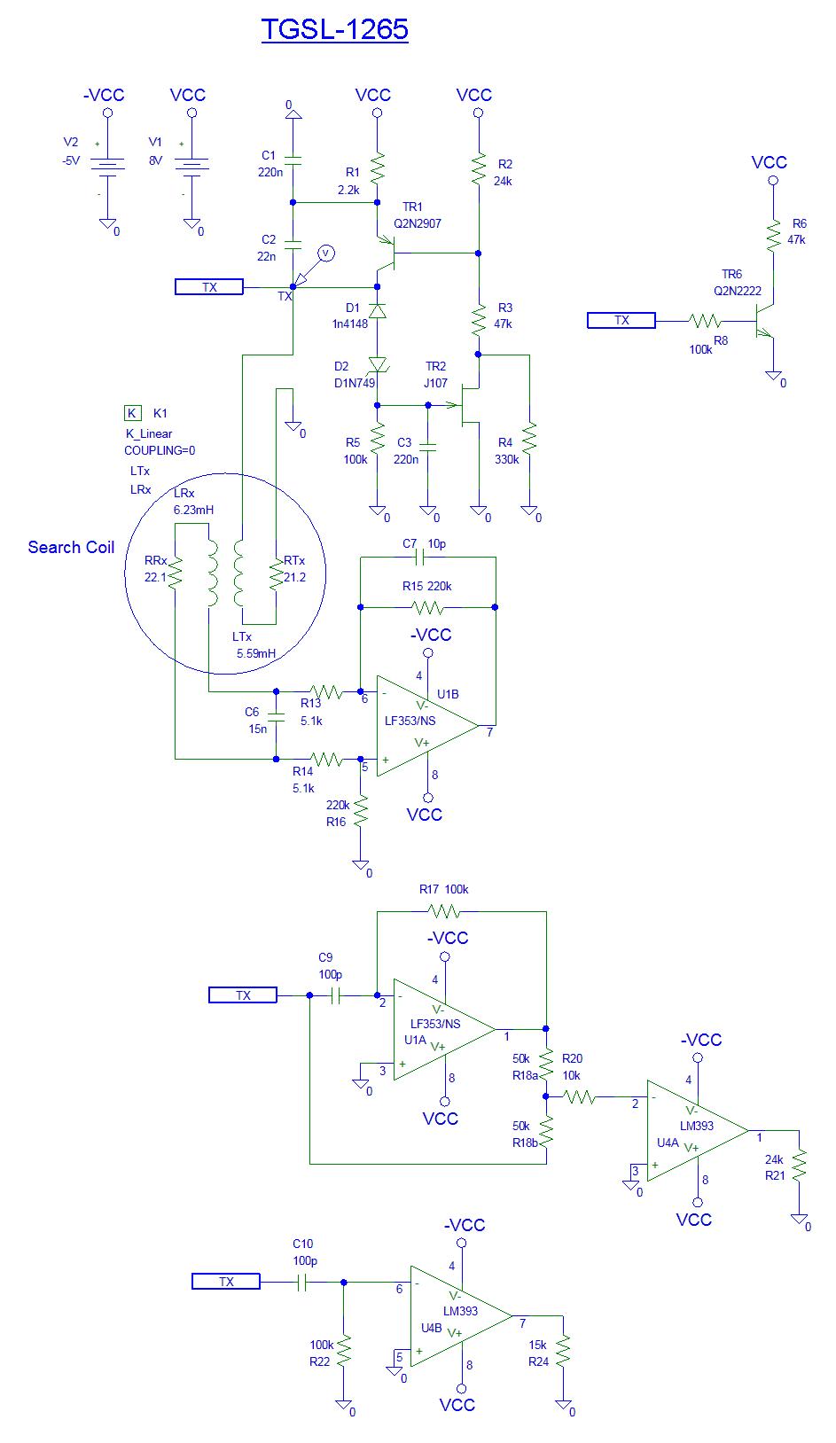

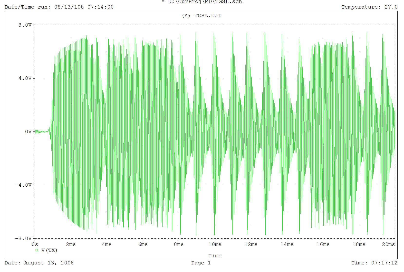

          • PSPICE Analysis of TGSL-1265
            Hi friends
            This is SPICE analysis of OSC section of TGSL-1265 with all associated loads.
            Tx signal is not stable with loads but without loads it becomes stable.
            What is the problem?

              you must always consider the internal series resistance in the coil models. The instability is probably due to a wrong simulation param.
              In my simulation the tx signal appears almost stable in amplitude.

              • In some simulators TGSL oscillator will not start to oscillate at all !!!
                Still it is working from a start eachtime i finish another one and switch ON.
                So...simulators "...are good for absolutelly nothing!"
                Joking of course, Max is right, some parameters are not set up..
                In LiveWire it will not start at all? Yesterday i tried...no results!?

                          • Trust Simulation
                            Don't mistake friends
                            MicroSim Pspice is not baby toy ... I made many circuits with aid of it from 1995 to now. I have dialup connection and 60MB upload is unpractical to send it fou you.
                            Just change R5 from 100K to 220K so TGSL works with every Coil ... believe ... test it

                                R5 is just part of "fuse" stage there, does not have any relation with what you are suggesting here!?
