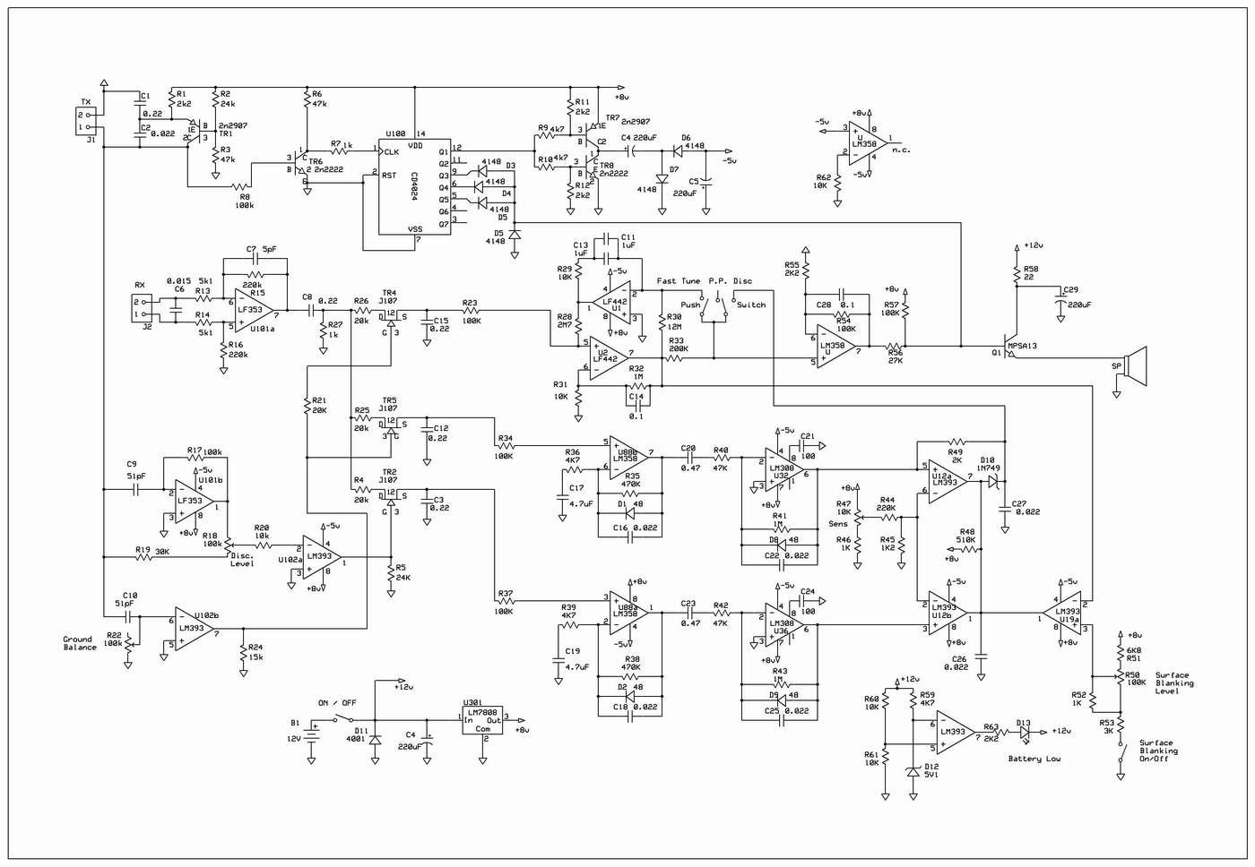

            • R47, R55
              Are R47, R55 (4K7 resistors on final LM393 output) on TGSL 1265 PCB? Don't see them.
              Sorry if repeat question . (annoying we can't search small words.)
              Cheers!
              -SB

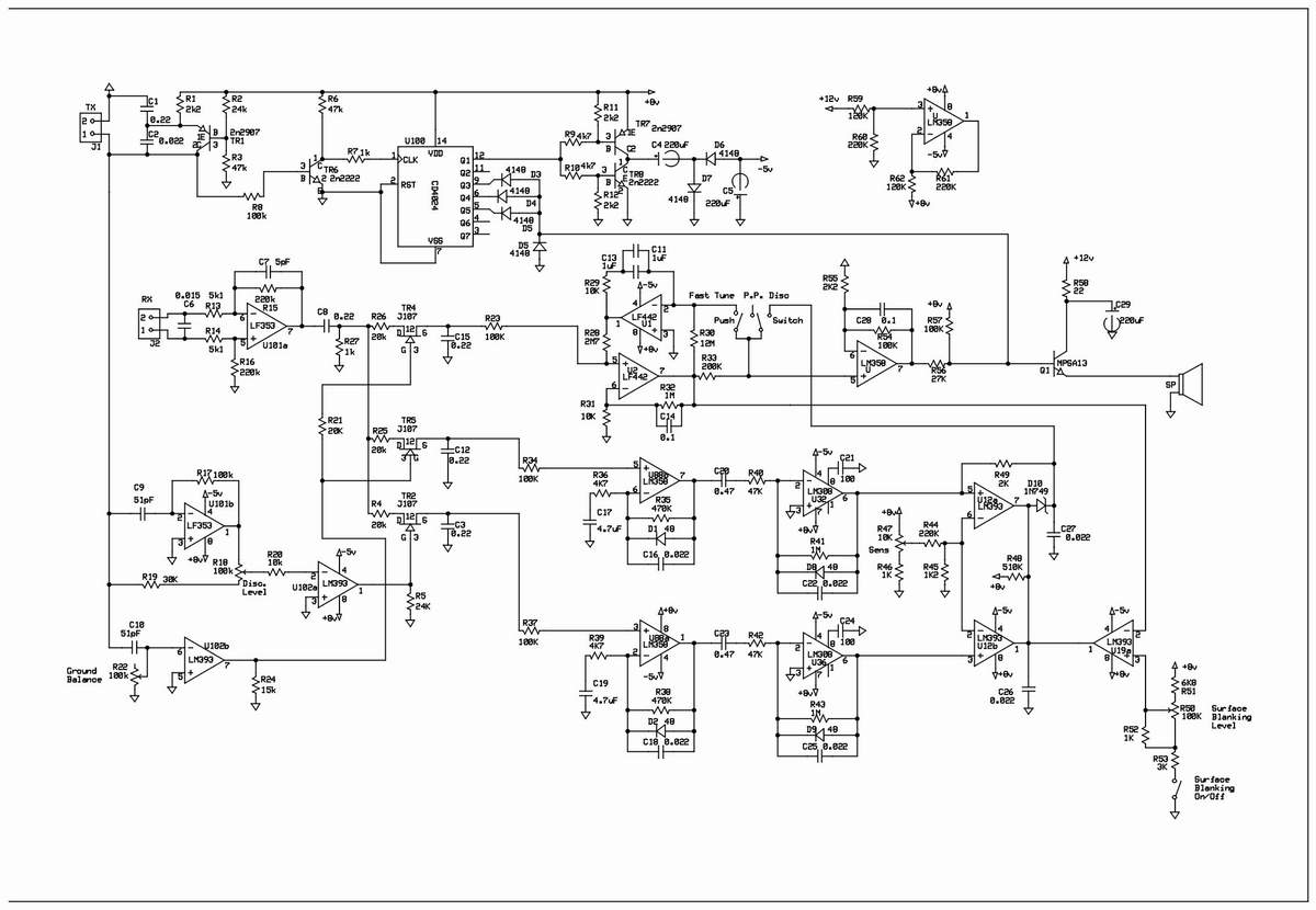

              • LET THERE BE ROCK !!!
                Good thing to add on TGSL is PP mode..so
                Let there be rock!
                  Let there be rock!
                  that's interesting... I think will be the only important feature missed in original design!

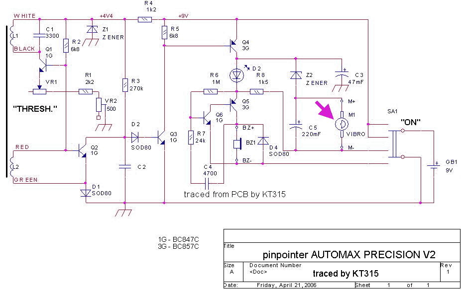

                  I'm doing pinpointers these days...
                  Found a schematic posted by KT315 of an Automax pinpointer... uhm... I've mounted on perfboard in 30 minutes... and say what ? It works cool!
                  It get 1 eur at 2inches easy... and more with other stuff... like 2eur coins that's enough for me to say it works just cool!
                  Just I had to add some mods... and use an guessed coil cause I have no data about!
                  So... I think I will pack it and use on the field very soon.
                  If anyone interested I could provide data for coil and other missing parts...

                  • TGSL + P.P.
                    Ok now is complete....
                    • coil inductance
                      PP interesting - where did you get circuit?
                      TGSL not so L any more.
                      I have a couple of review questions - getting very difficult to search huge thread:
                      1. What is the "official" inductance of the TX and RX coils for TGSL? Did anyone actually measure Tesoro GS coils? Or has anyone concluded a "best" inductance from experiments?
                      2. What size wire is OK for RX coil? Is 32 awg OK? Has anyone tried even thinner? From schematic, it seems maybe resistance of RX coil not important (unless we are "on resonance" but Max says no). Why not 40 awg wire?

                        my pinpointer is from a KT315's schematic... he draw from reverse eng. of the pcb of automax precision version 2. You can see it in the picture, all by bjts, no ics.
                        Ivconic followed other tesoro's designs to make the PP mod on TGS! i like it... I made something similar but I think is lost in this thread at unknown page...many months ago... but I never tested it.
                        The reference inductances are those of uMax coils... you can read some values here: http://geotech.thunting.com/cgi-bin/...oils/index.dat
                        In concentric there's something 5.6-5.75mH at TX and usually around 6.2mH at RX.
                        Now... actually we are interested mainly in DD config... but use slight different values about inductances... we get about 5.45mH for TX and 5.6-5.7mH for RX in Ivconic's DD design.
                        Notice that in tesoro's 11'' DD is something 5.90 at Tx and 5.38 at Rx, but consider also that our DD goes deeper !
                        With original one 11'' you'll get it run around 14Khz or below... but with our DD here you'll get around 14.6 - 14.69Khz (100 turns).

                        • PS: I forget params for PP
                          used 120turns for tx, 60 for rx on a 62mm long ferrite rod... like in AM radio.
                          Wire is 30AWG.
                          Used then 4700pF for C2 and 1Mohm for the thresh. pot.
                          For transistors could use anything, I've used BC547/BC557
                          The zener at vibro stuff depends on voltage of vibro... if 3V use a 5.1V diode.
                          And works cool!
                          Kind regards,
                          Max

                              Hi Nelson,
                              I posted them in the message above yours... look at it.
                              Coil is very easy and not critical at all, other turns ratio will work too but I used 120/60 for now.
                              With that data you can run it at around 100Khz.
                              Remember that phase is important, so if doesn't work reverse one coil leads.
                              When you turn it on at first you just need turn the pot till it sounds, then back till just hear small/low cracks or nothing at all... then it's at max sens... and will detect 1eur at about 2''.
                              It will start cracking at far but nearing object it will rise the tone till strong beep will signal object in really safe way, you can't miss it.
                              It's good for smaller things too... like nuggets and the like: you need to near it more but can detect 3mm stuff at 4-5mm with a good sound.
                              Another advantage is that's really stable... you switch it on and off... and works about the same: other PP need constant retuning at each switchon...no good.
                              Kind regards,

                              • Hi Max
                                For bz1 what i need? a simple piezo or one with oscillator inside?
                                Diode are 1n4148?
                                Thanks in advant.
