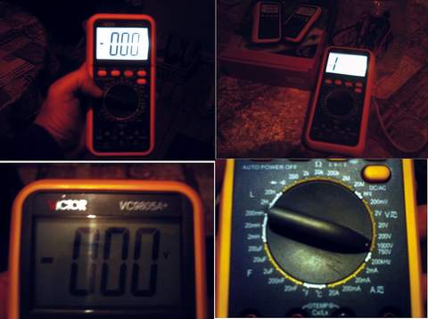

  • It is dark and damn camera is poor. But here it is!
    "VC9805A+" model....??? With backlight!
    Not expensive much..but not cheap also, some 30 euros!
    But it is splendid tool for nulling coils! So far most accurate!
    http://www.warf.com/electronic-products-4327.html
    • Ivconic,
      What multimeter do you use?
      I will try to get the same.
      But I cant get better sens with only coin.So might be everything.
      Now changed cable with normal coaxial.Just using two.
      Can null much lower.But still sens is the same((((
      Qiaozhi,
      I try and can reach 0V.But still same sensitivity.
      • First thing, when bought it, i checked residual voltage at original "Brown" Tesoro coil with Eldorado. Reading with this mmeter was exactly 4mV - by the book. Than i made my own handmade coil and nulled it at about 6mV (couldn't achieve less). That coil is working excellent until nowdays (sold to one old "customer"), 1e in air at 34cm with TGSL (BD140 version)...
        Than i also made ..maybe 10 more coils (some of those couldn't null below 15mV) and nulled with this instrument. So far i had no problems with it..
