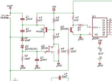

    A) Why only hysteresis on one channel, not other?
    B) Output impedance (low) of LM308 shunts the feedback, has virtually no effect.

    It's only required on one channel, because the outputs are wire-ored, And it makes sense to place the hysteresis on the ground balance channel, because the disc channel only acts to disable the output when ferrous targets are present.
        AND for postive output, OR for negative. Positive makes audio beep on TGSL in current circuit -- so noise on either channel could make chatter. Not clear to me but I see the idea.

          I found the problem causing that I was unable to null the coil properly.
          And next thing in the menu: changing the phase shift between Rx and Tx signals seems almost impossible just using the method of moving the two coils. The thing is I am now able to adjust the amplitude having 5mV/Div on the scope and Its hard to see even the peaks in the voltage, less than 1mVpp for sure! How much exactly I don't know perhaps around 0.1-0.2Vpp.
          BUT: I can't adjust phase in this case. I can do that measuring on the output of LF353, but this will automaticly disable the good ballance achieved!
          So the dilemma now is ways to achive phase shifting, not using Rx and Tx:
          1. Using metal pieces, What type: Al, Cu, Fe... Drawbacks of this method? I know it's used by DIY-ers not by famous manifacturers (mineleb, tesoro) this must have a reason.
          2. Using different values of resistors in the Rx preamp part. I've seen circuits which you can change resistor's values in Rx part to achieve phase shift
          3. Others??
            I think this is correct. Since all targets cause a phase-shift to the left, then moving the pulse to the right is causing it to sample slightly negative.
            How much does the sample pulse move when you've made the adjustment? Is it about 1us?
            thanks, that's the answer and question I expected. As always you provide really informative posts.
            Now it's about clear to me.
            The delay when shifting to the right is about 1.2 us.

                      Thanks for posting Eagle file.
                      Glad your coil nulling now. Can you tell us how you fixed problem nulling? Would be helpful information.
                      I am trying to understand importance of this phase of nulling residue signal. I would like to see comparison of real TGSL with one coil with wrong phase and one with "correct" phase, both nulled to same voltage.
                      My thinking is it only should matter for non-motion pinpoint mode.
                      The reason is: for motion mode, the nulling residue should just make a constant voltage after the JFet detector (filtered by capacitor).
                      Each target has it's own signal which is added or subtracted. Motion detector responds to difference, ignores constant nulling residue.
                      Why should it matter whether nulling residue voltage is tiny negative or tiny positive because only target signal passes through bandpass filter?
