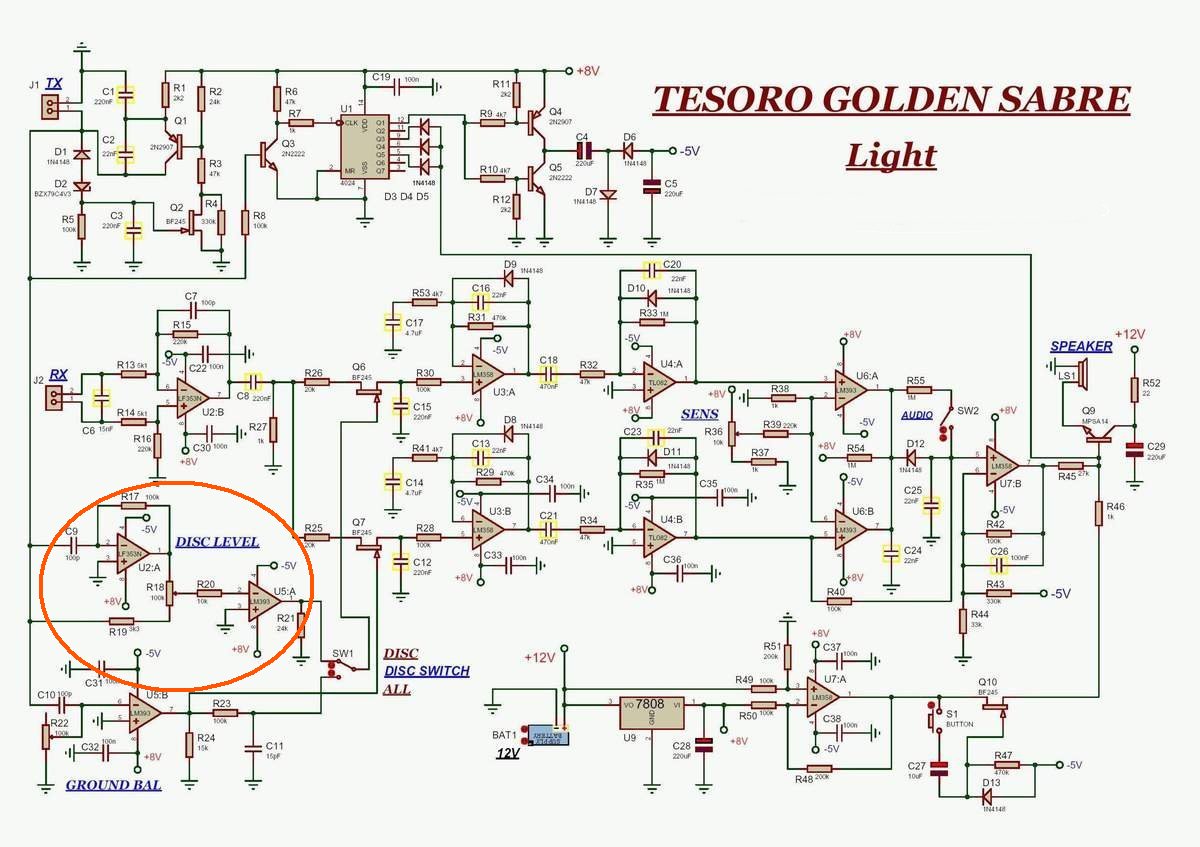

    yes I think this is the last posted one by Ivconic that uses TL082. I've made the board... though I had a problem with orientation of printed film first time... so I've made a wrong board first time and a remade just few minutes ago... so I have it now.
    As I see in your picture your PCB is different: does it work good ?

    Well, I had problem with placing commponents, mispleced some of them. I correct already that. Now machine works, but in DISC mode no response at all. Maybe I have problem with FET's again. I don't know. Now I use 2n4393 and maybe some of them not functioning properly. I will check that. I tested LF351 instead of LM308 as you sugested and for me, seems there are no differencies but I cannot say until TGSL become fully operational. I hope, my TGSL will be operational very soon. In any case I learn something new every day here about electronics and my English are better and better.
    P.S. I think latest Vladimir's version of PCB is with 308s.

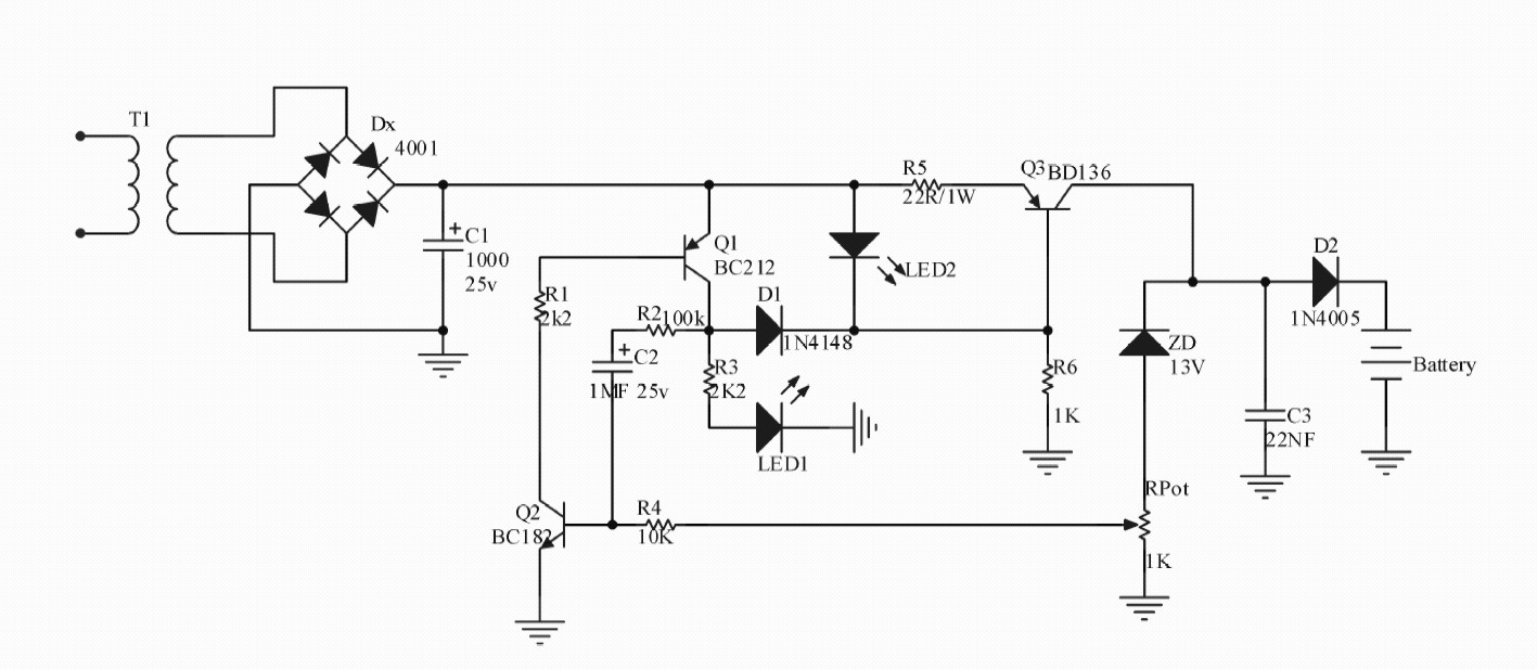

    • Charger
      TikTak i am using my handmade charger.
      This one allows charging various batteries. To adjust for given battery you must put proper zener diode there. For 12v/1.3Ah battery i usually put ZD13.
      Also charging current can be adjusted with R5. I put there 22R. But this mostly depends of used transformer. Some small transformers wont allow proper charging if R5 is lower than 30R..
      Led diodes are there to indicate charging state....
      This charger automatically stop charging when battery is fully charged.You do not to pay attention on charging time, just connect and forget!

              Hi Max,
              What could be a reason for non working TGSL in DISC mode? What should be I check?
              Darko
              • Originally posted by Darko View Post
                Hi Max,
                Darko
                if it works in all metal and not in disc problem is maybe at disc signal to gate of fet.
                When you put it in all-metal the disc channel fet get its gate signal from the delay network (resistance + capacitor) that is just a few shifted from geb sampling signal due to the RC network.
                Thus I think that maybe your disc signal have something wrong:
                - check the section of LF353 near disc pot expecially capacitor value there
                - check also at LM393 after the pot that actually drive the fet's gate
                If you have scope you can look at signal directly ...otherwise just check components and connection/solder joints for mistakes.
