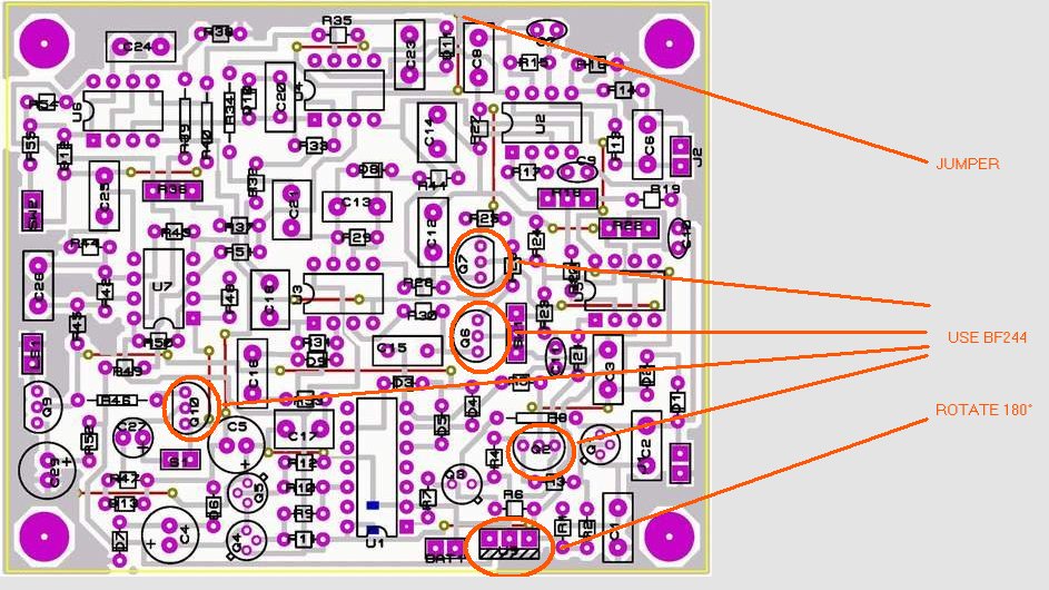

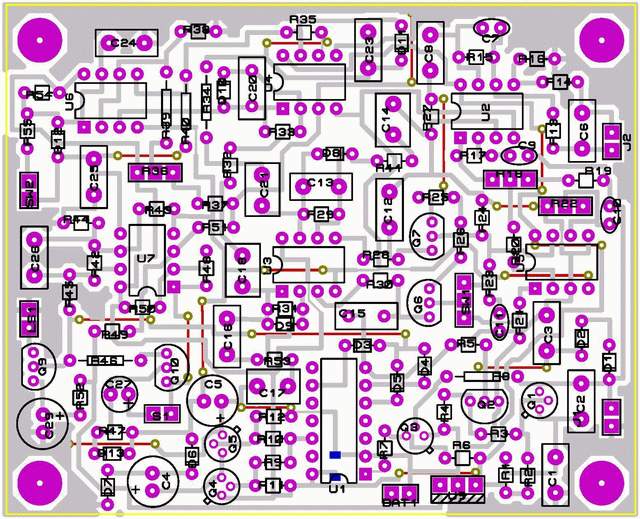

    • Hi all,
      found some small mistakes on that PCB:
      - partially erased jumper on part placement picture
      - wrong sided 7808: rotate 180°
      - all fet pinouts expected are like in BF244 not for BF245: if you put BF245 as is it will not work, so use BF244 or put gate of BF245 in the central pad
      For now it's all I've found...rest seems ok.
      PS: the 220uF capacitor at output of 7808 is not present on board
      Kind regards,
      Max

            Hi Vladimir,
            many thanks for your help and your PCB designs... I like very much.
            I'm doing some preliminary testing now on that board I've mounted...but cause of few spare time, at the moment, it's taking a bit long for me this time. I hope I'll see you posting here more good stuff like you have done already, cause it's really good work... and looks professional.
            Respect to original complete TGS board it's really space saving and this is one good thing for homebrew projects too.
            Best regards,
            Max

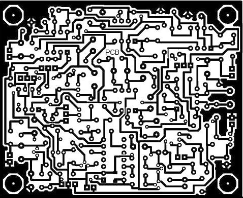

              • Hi sirs (friends).
                At me is projects in Proteus much. You saw them.
                Delta, Montana, Goldscan, TGS, TGSL, etc.
                If to establish program Proteus 6.95 (30mb) it is possible to change PCB according to your desire.
                I can export to file DXF, and Gerber.
                PS Max, I sent you TGS the full version in Lajout-5, you have received?

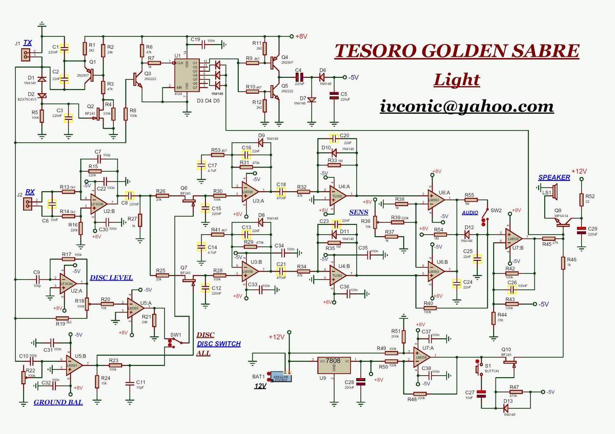

                  Hi Vladimir,
                  I've received the email and file: as always great work by you. Thanks.
                  About royal... it's worth a try I think. I hope someone will post pictures of it.
                  Many tesoro's designs are really good made and can be also improved much with few changes... components for example.
                  For example, I've changed on board I've made using your design the preamp to NE5532 and found it works really cool there. Also I've tested TL072/TL082/TLC2262 and with all device works really cool instead of the 2 LM308s of original design.
                  There are some bleeping conditions now... but I haven't tested if not for a few time... so I think your design will result really stable with some small change and maybe even better than original larger board.
                  Sensitivity is already good... and I haven't tuned at all !
                  Many thanks for everything,
                  Max

                          do you mean these files by Ivconic and Vladimir ?
                          I repost them here for anyone.
                          Kind regards,
                          Max
