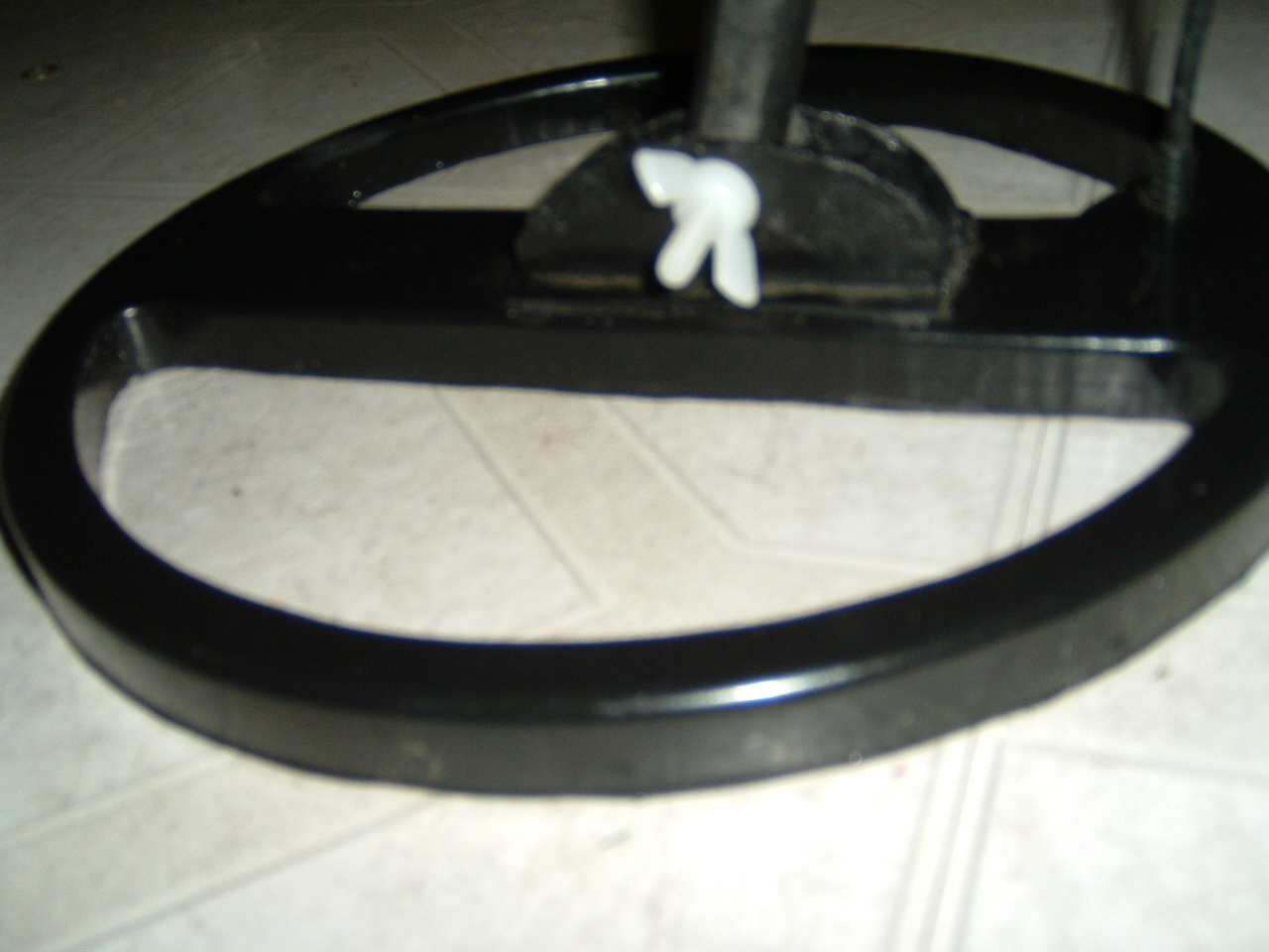

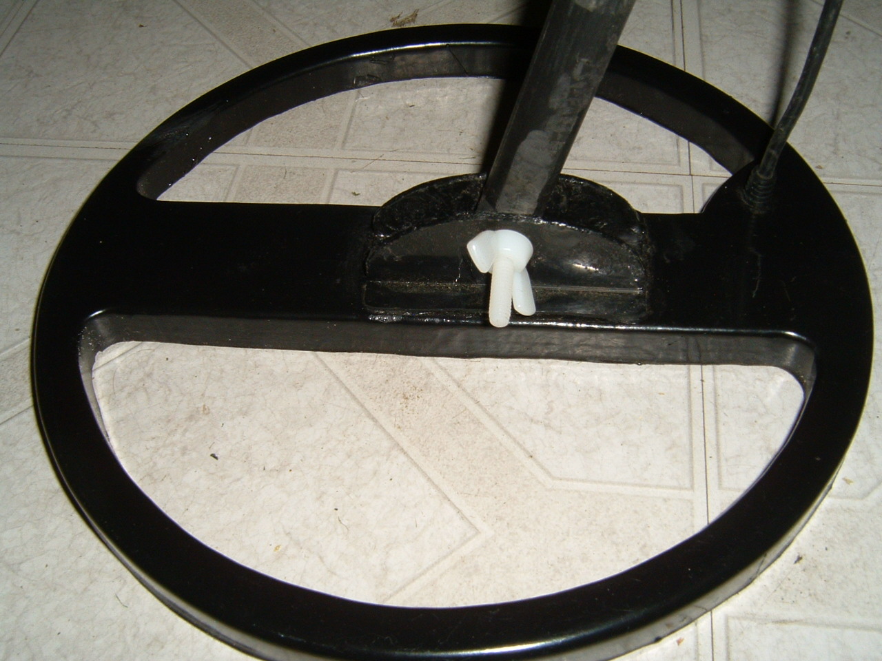

                              as previously stated, I built TGS, which worked ,but I had trouble with notch filter. I was going to build TGSL, but I settled on TGSL edu, I now get 30 cm depth. I went out hunting a 100 year old high school playfield and found a canadian quarter and some pennies. To my amazement, I found razor sharp discrimination between silver and aluminum. complete discrimination of large steel, but strangely I was hitting old magnetic sensitive beer bottlecaps. Here are some pics of my latest vacuum formed coils. If it is helpful to anyone, I found that you need to get the abs hot enough that its sagging almost to the bottom of the oven, carefully watch it! then you place the frame on the vacuum box, and you will here the rPMs of the shopvac go up, and you will get good detail on your coil shell. On nulling the coil, I hold the top coil while watching the oscilloscope, then drop dollar store glue gun glue on coil points, I then use dollar store $1. epoxy to secure coils further. Then use 24 hr epoxy to fill the coilshell with no movement.
                              Finally I got a good discriminating reliable detector. I searched the TSGL posts. and saw that the original Tesoro patent allowed bottlecaps? anyone???

                                Excellent job!
                                Yes, rusty bottlecaps seem to be able to fool Tesoro, maybe all, MDs. I don't know why.
