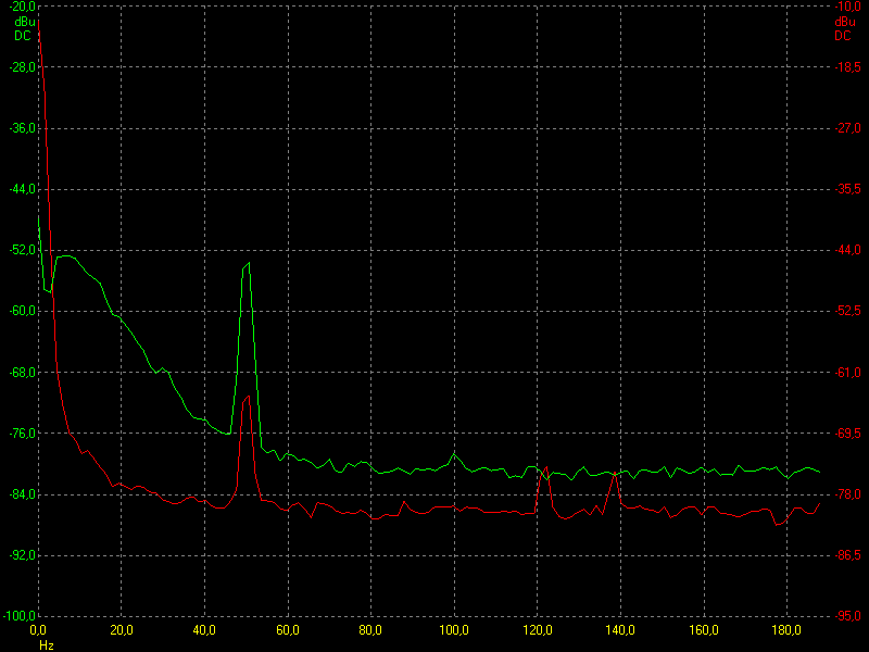

          For anyone's interest :
          Here some graphs of a spectrum analyzer in practice ( averages are shown )
          U103 Vin vs Vout ( 190 Hz) :
Name:	U103 Vin+ _ Vout.png
          U103 Vout vs U104 Vout ( 190 Hz ):
Name:	U103 Vout_ U104 Vout.png
          U103 Vout vs U104 Vout ( 6 kHz ):
Name:	U103 Vout_ U104 Vout 6 kHz.png
          kind regards ,
          Dennis the Mennis

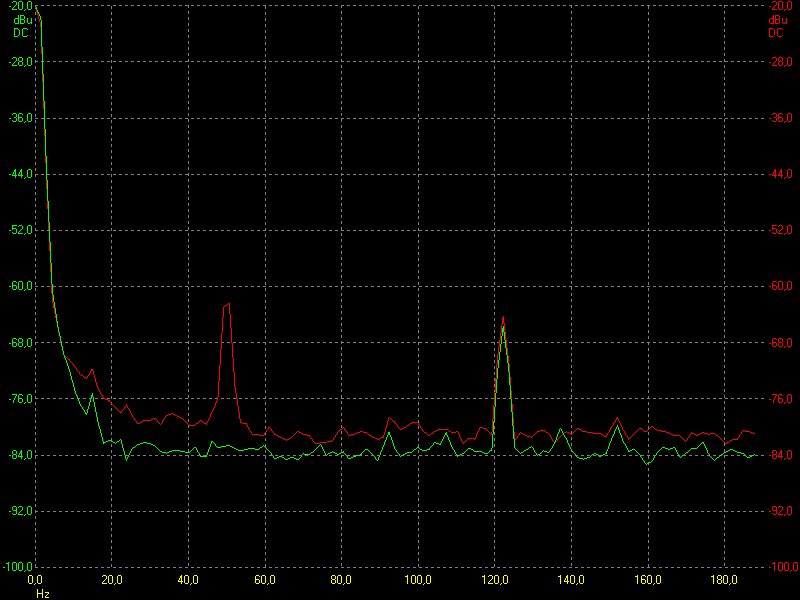

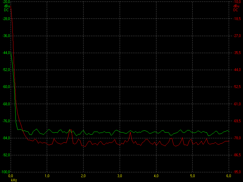

            • Originally posted by Dennis the Mennis View Post
              [ATTACH]15591[/ATTACH]
              [ATTACH]15593[/ATTACH]
              [ATTACH]15592[/ATTACH]
              kind regards ,
              Dennis the Mennis

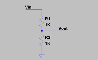

              Hi DtM!
              Those are interesting graphs, but they don't make sense to me.
              Can you describe exactly how you made the measurements, the equipment, any connections to your TGS?
              Could you also make a similar spectral analysis of a simple resistor network (such as a voltage divider) for a reference?
              Let's see if we can get better agreement with LTSpice.
              -SB

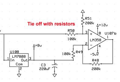

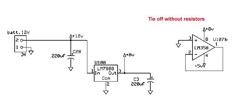

                              • LM358 tie off
                                Side note:
                                I notice on eduardo's schematic the unused LM358 is "tied off" using several resistors.
                                I looked into this and became convinced that you can tie off the op amp without needing resistors. See photos below for comparison.
                                However, I'm interested if others have opinion on this. It seems useful to simplify our PCBs if we can get rid of any unnecessary parts.
                                -SB
