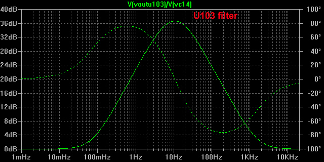

      Back to your response on block #6, I can see where C13, C16, C18 and C21 determine the upper and lower cutoff frequencies thereby creating a "bandpass" filter of sorts. But since the inputs to pins 2 and 5 are not necessarily at 0V, the OPAMPs have to have some reference voltage all the time on pins 2 and 6. You could just replace the 10uF caps with pots and provide a reference voltage but you would be constantly adjusting them to be slightly lower than the DC value on pins 3 and 5.
      My take, for example, was that the DC value on pin 6 would always track the voltage on Pin 7 and any change on Pin 5 would be compared to what was on pin 6.. At least until the caps (C14) began to charge or discharge and caught up to the voltage level on pin 7 again.
      Are you suggesting that C14 also has a function in the bandpass filter as well?
      I think I used to understand this stuff around 30 years ago - maybe not -- but this is my current "understanding":
      U103 is basically just a slightly peculiar bandpass filter - peculiar because it has unity gain at zero and infinite frequencies (rather than zero gain) with a nice fat gain (36 db) at the center frequency of about 11 Hz. (Yes, capacitor C14 is a crucial player in the filter band -- it is not just a shock absorber -- the value is critical in shaping the filter.)
      The unity gain means that the output exactly tracks (output equals non-inverting input) any DC bias voltage (by nature of the negative feedback loop). It also exactly tracks high frequencies. Frequencies around 11 Hz are amplified greatly and so become relatively more important, thus the low-bandpass nature.
      So, whatever DC bias appears at the non-inverting input will also be present in the output. This is not a "feature" I think, just an artifact that is tolerated because the next filter stage (LM308 ) removes the DC bias and rolls off the high frequencies. The Synchronous Detector (SD) "summing" capacitors C12 and C15 also roll off the high frequencies.
      I believe it is the "bandpass" nature of the overall filter (removal of DC bias) that makes the TGSL a "motion detector" (i.e. if you leave the coil over the target, the signal will die out).
      Those DC biases that appear at the non-inverting inputs of U103 are due to our "null" signal passing through the SD and accumulating on capacitors C12 and C15. They will be different for the DISC and GB channels because of the different sync pulse phases. But ultimately those DC biases are simply ignored -- their main significance, I feel, is that it means we have to choose a "null" signal phase that does not forward bias the JFets in the SD and screw up the works.
      So bottom line is I just see U103 as a bandpass filter stage with an unfortunate DC gain of 1 that is a tolerated tradeoff for the advantage of using the non-inverting input as a high impedance input (to be easy on the SD).

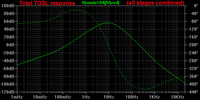

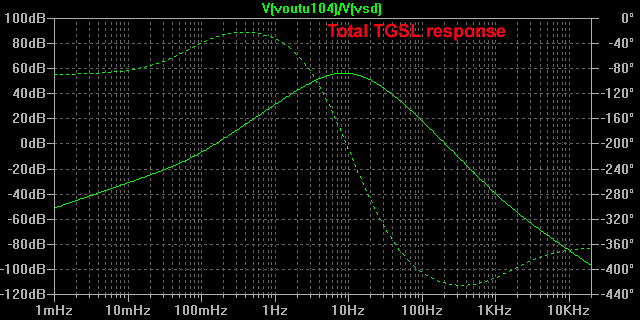

            Simon,
            Thanks for all your input.. Much appreciated! Would it be OK to to use your freqency plot with the document I have been working on?
            Also, you have two plots on the graph. What is the one with the dotted line?
            Don
              Simon,
              Don

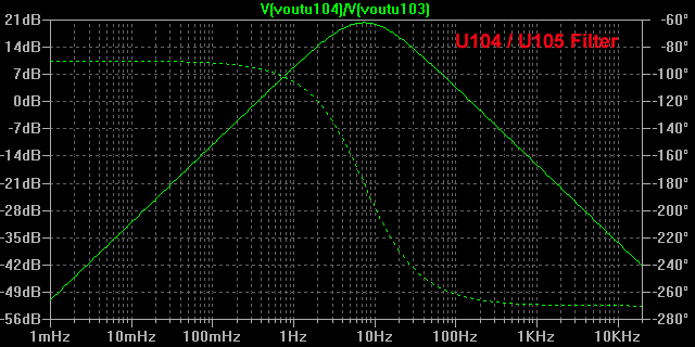

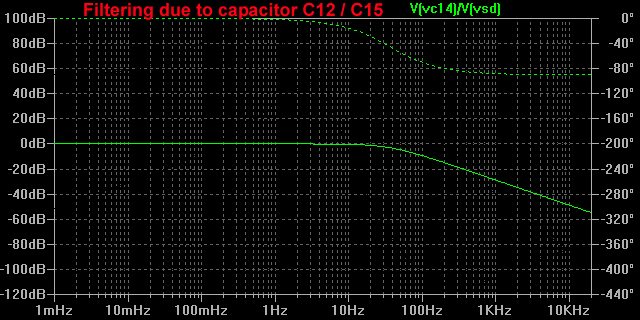

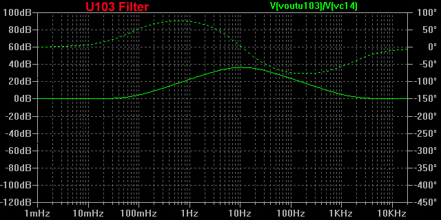

              Hi Don:
              Dotted line is phase shift vs. frequency, values on right vertical axis. Left axis is gain in dB for the solid line.
              So you have choice (since I'm an overkill guy), I'm attaching the filtering characteristics of each separate stage in the amplifier, including the SD capacitors, and the total combined characteristic of all the stages.
              Cheers!
              -SB

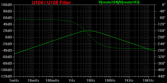

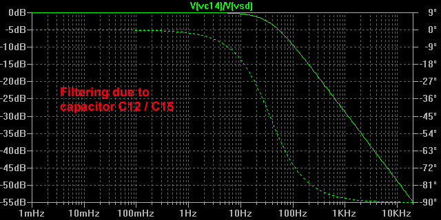

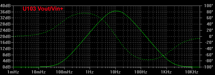

              • Hi Don!
                Sorry, that wasn't enough overkill!
                I thought it is actually better if all graphs were to same scale, so it makes better visual sense and you can feel the contribution of each stage better.
                So, one more time (with feeling)...
                -SB
                (*Of course use whichever you want)
