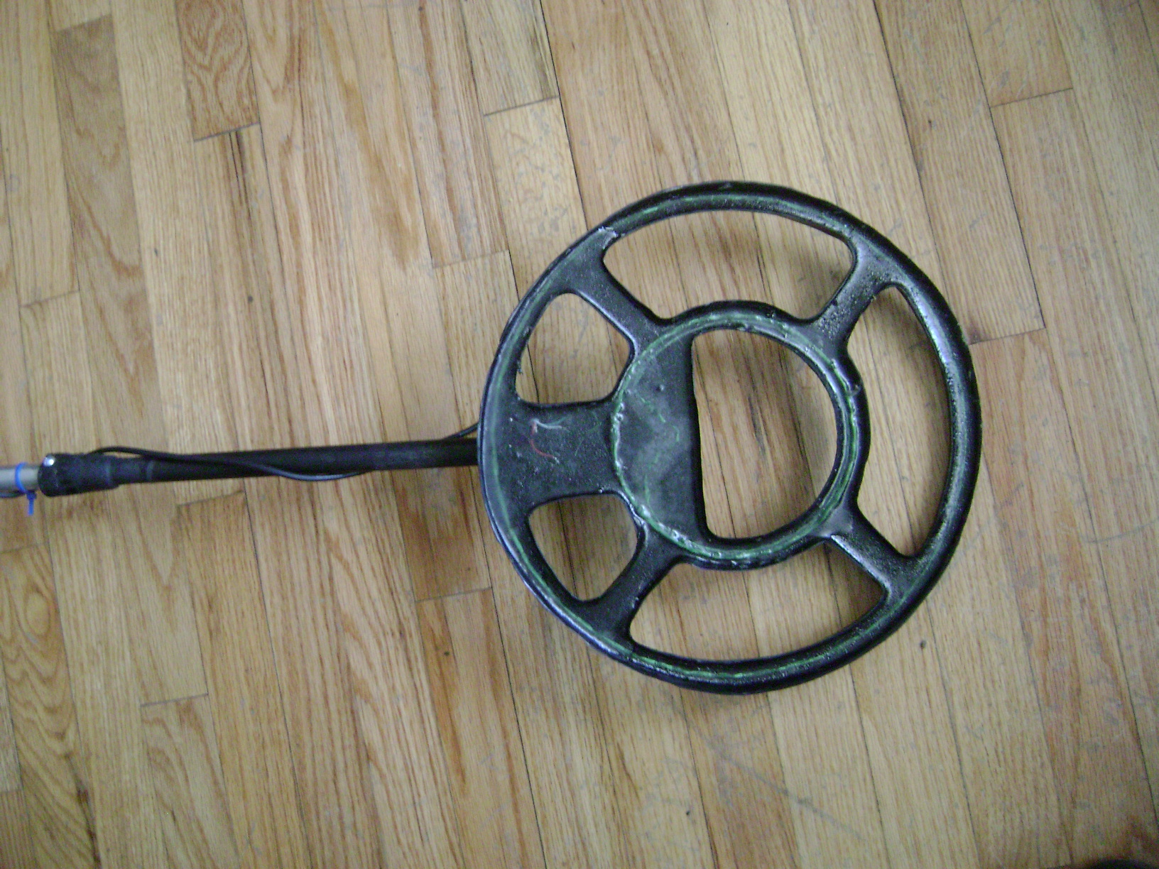

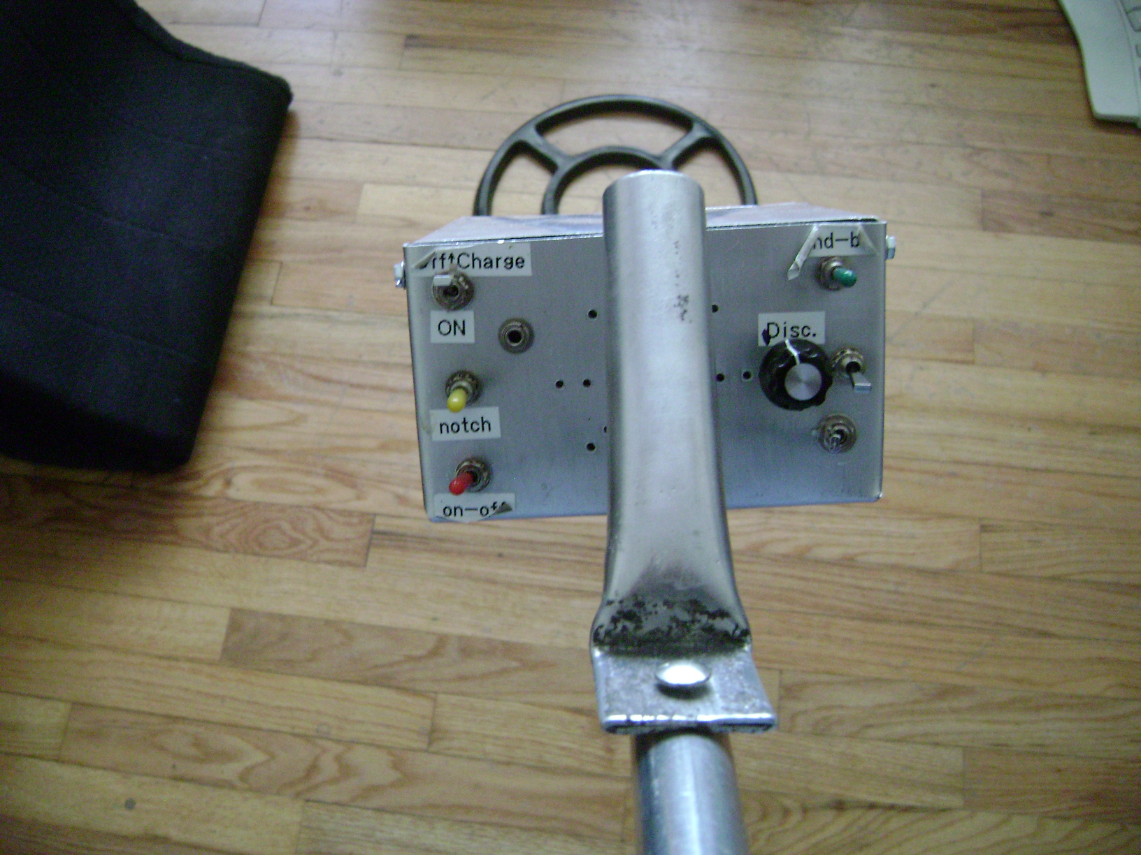

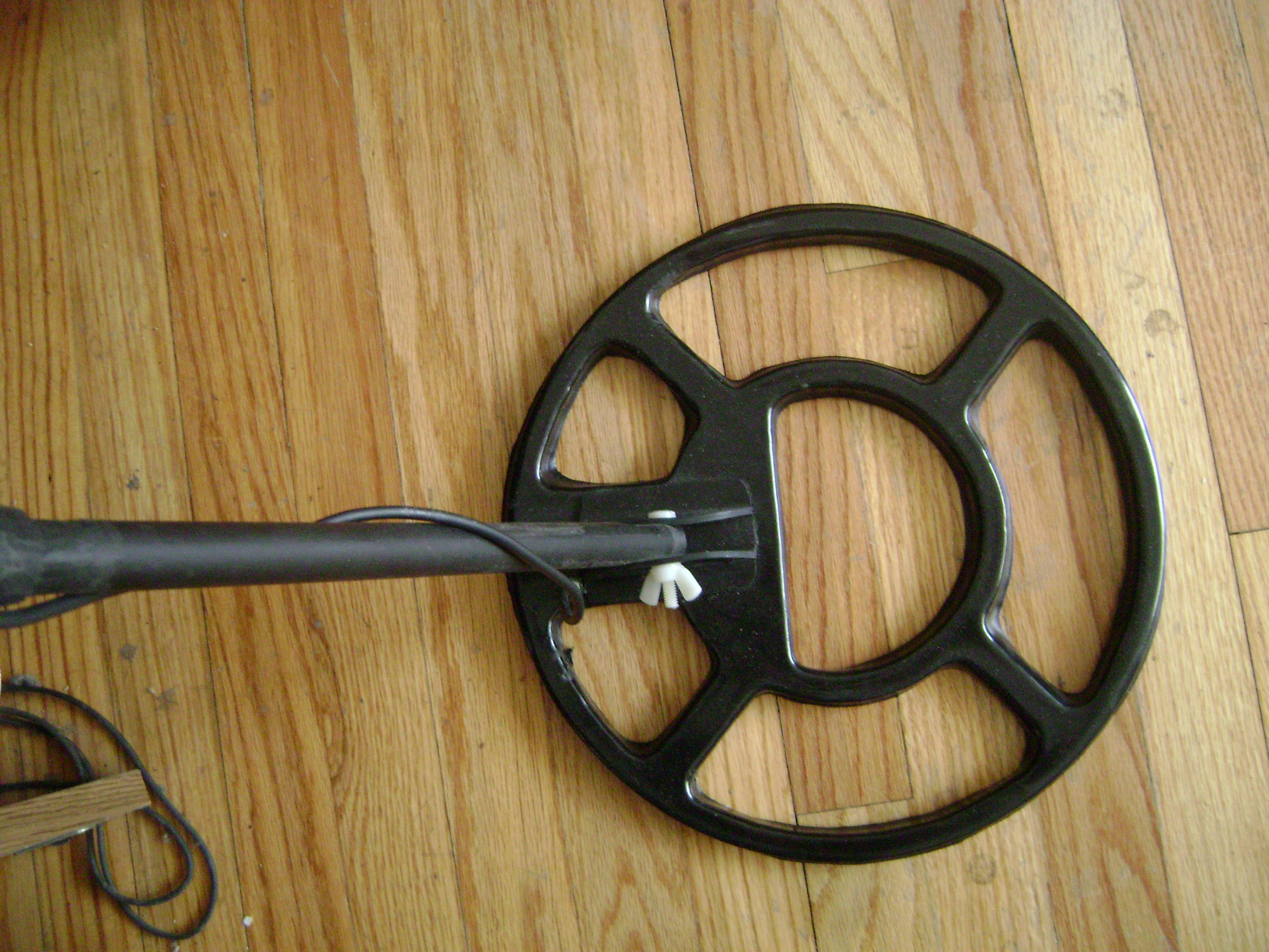

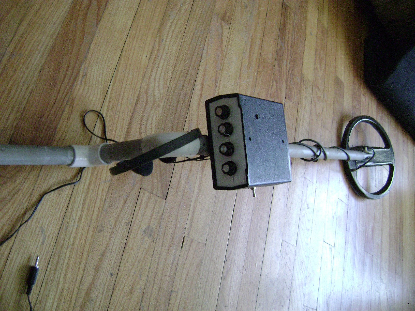

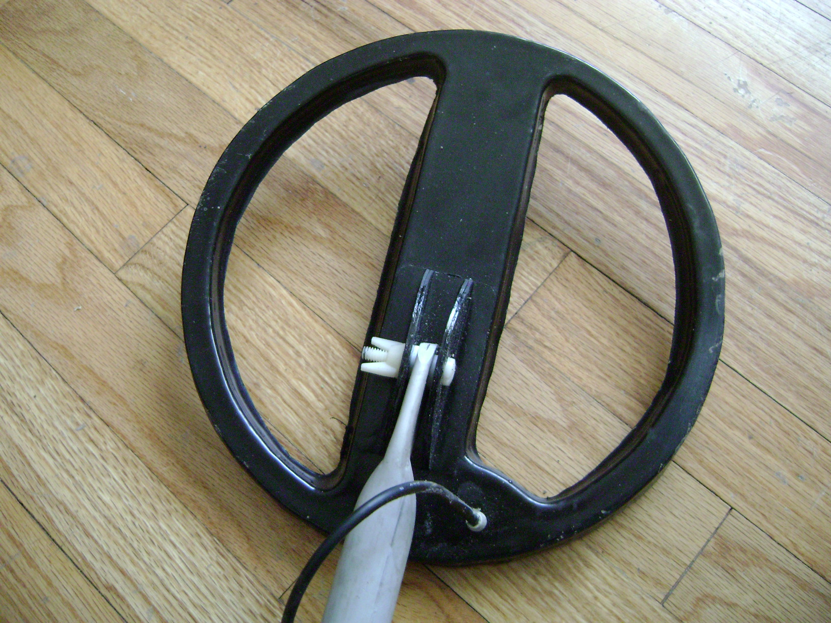

            Ok Don, so it sounds as if I get the TX coil close, i could probably adjust better with cap.
            Here are some pics of my TGSL, and my surf pi. These two mds worked out better than I expected Surf pi -11" on a nickel and better than that on the tgsl. I also built a DBP2010, which worked, but was a major disappointment. The first DD coil on the tgsl was a failure, I could get the coils to null good, but when I added the epoxy filler. the null was ruined! So I built a 12" concentric, following the coil instructions by Dave Emory. Everything was going great til I got to the bucking coil.ll I can say is if you have a way to wind the bucking coil on a spool that will slip over the receive coil, it will make your going easier. I had trouble getting a null adding and subtracting turns on the bucking coil. Finally I got the null close , and I tweeked the bucking coil so it nulled. I want to try another DD coil, cause I want to build another coil shell. Having the coil shells make the md a whole lot easier. Wil
