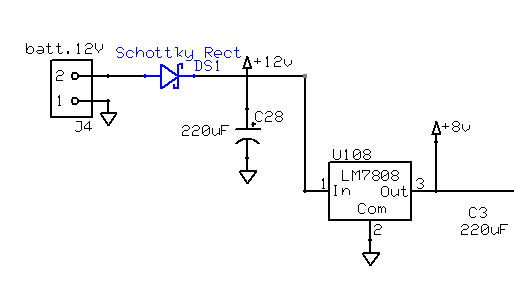

    • diode protection
      Given the big voltage drop between the 12V battery and 8V LM7808, it seems reasonable to add a permanent protection diode in the power circuit schematic for the TGSL. Schottky should give most battery life. Maybe keep lunamay out of trouble...
      -SB

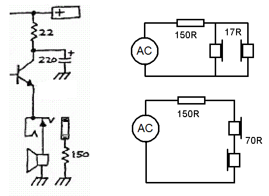

                          • wiring headphones
                            What does everyone think about wiring the headphone jack for TGSL for stereo headphones?
                            Do you wire phones in series and ignore shield connection, or wire in parallel and ground shield connection, or other?
                            I'm using a cheap set with about 35 ohms per ear piece.
                            I'm tempted to wire in series, ignoring shield, to reduce power drain -- they're plenty loud that way.

                              SB, Energy (and ear :-) saving is done by 150 ohm resistor as shown below. Save your ears; don't use phones without this resistor!
                              The 35 ohm resistance per ear piece is inherent not only for cheaper, but for all stereo headphones. If your phones have shielded cable, they are not cheap. The cheap phones use simple pair wire for each piece, even not enough twisted pair.
                              The serial connection of earpices produces antiphase sound pressure for ears. In this case your brain can not imagine where is the sound source. If this not create an uncomfortable feeling for you, use it.
                              If where no resistor 150 ohm, sound power (pressure) at seral connection decreases twice, but because of the logarithmic human hearing, the loudness (volume) decreases only by 3 dB.
                              However in this circuit, the serial connection can sound even more loud because of better impedance matching of 70 ohm load with 150 ohm signal source. Signal source operates as if it has impedance 150 ohm as shown.
