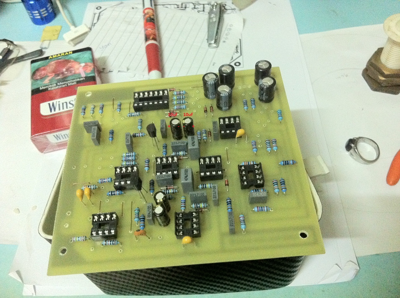

    • ok i will try use 4.7uf so i use 4 pcs 4.7uf like
      • can any one show me sample picture on board how to put that 4.7uf im relly dont know how

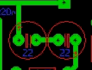

        • Well with 2 caps in series the final value is 1/2 so you need to use 2 10 uf caps to make a 5 uf cap.
          To make them bipolar you connect the negatives together like this;
          (These 22 uf's would give 11uf)
          • so the polarity is same ?
            is that look like this bro
            this is my board
