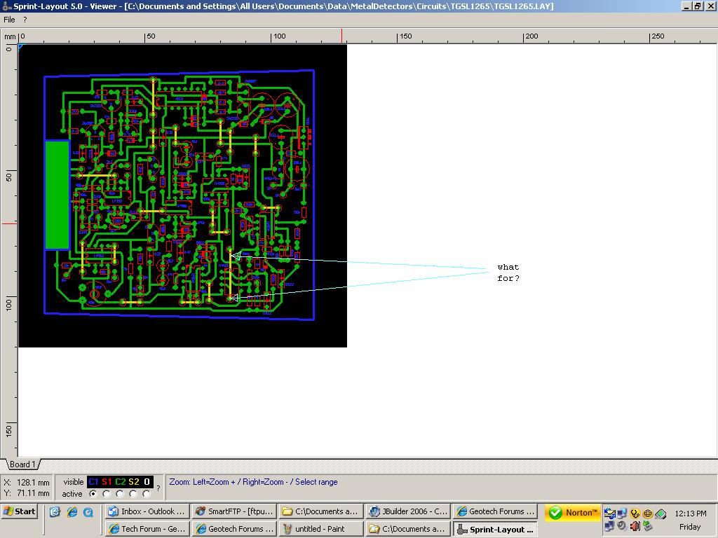

        • Thanks for pictures showing missing 1K placement, should help. Someday we'll get a complete PCB finally -- just kidding, we all appreciate your work extremely.
          Question -- what is the jumper wire under the LM393 for? (see image. Excuse me if this was answered before)

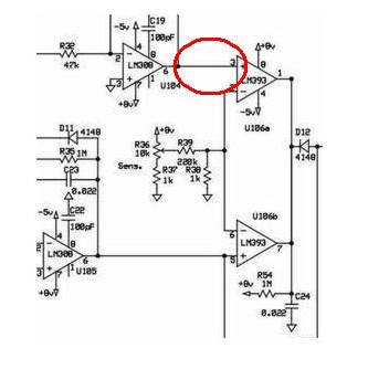

            • Simonbaker...!? It is route from LM308 to comparator..
              See schematic...
                      See schematic...
                      Ok, I understand. Then the green trace from pin 3 of the LM393 must run underneath the yellow jumper and is connected to the green circular trace at the end of the jumper. That is a little confusing to see at first.
                      Now, to make the PCB -- don't we need an image without the jumper wires? Or did you post it somewhere?
                      (I'm not too experienced with this)
                        Ok, I'm learning. I used the Sprint Layout instead of GIF and make the jumpers invisible, now I can see it clearly!
                        • Yup!
                          In print page you can choose layers to be printed or not.....easy!
