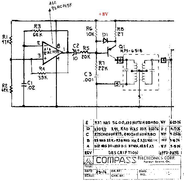

  • Regarding oscillator managed by IC, this is of old Compass year 1976, excellent detector.
      and also this added area exept 12,75.How much it is 1,5cm?2cm?
      it's 1.6cm I think... let me look at caliper...yes 1.6cm.
      Kind regards,
      Max
