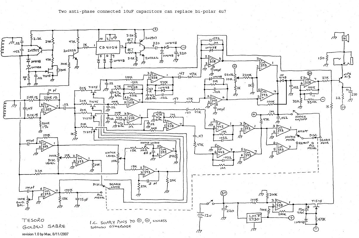

          Another important thing is 1M resistor...KT315 pointed me to it. After installing it
          parallel to diode i gained much better performances...If you didnt previously, now is time
          to solder it over 1N4148...look at my last schematic, you have everything there...

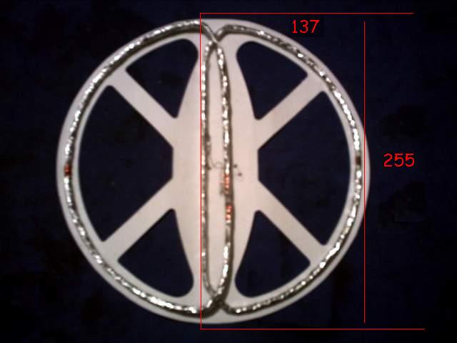

          Next is to make coil i described last here; 255x137mm;
          Wire gauge is 0.25mm (0.28mm with varnish)
          For TX - 100w = 21.2ohms = 5.61mH, when constrained it should read 5.99mH
          With this coil frequency should be 14.6KHz +/-200Hz
          For RX - 105w = 23.4ohms = 6.18mH, when constrained it should read 6.55mH
          These are exact datas of coil i made. Coil is working very good. 2cm coin at 36cm distance,
          but most imortant is fact, detector is calm and stabile, no false signals at all.
          Discrimination is PERFECT.

          Nelson, here is photo of coil i already described ....Regards!

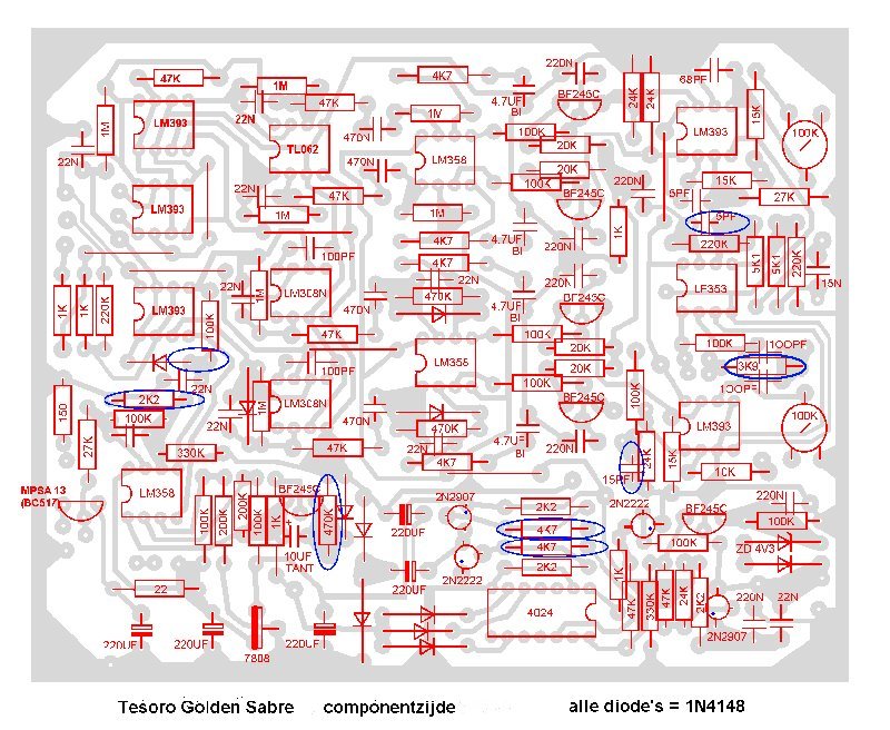

            First thank you Porkluvr for reply and for answering to some of my questions. Ill try to be specific as much as i can. Im building a Tesoro Golden Sabre from shematic that i found here on forum.
            Im interested in the walues of elements on that shematic, and walues of elements on PCB if you know what i mean by this, i sure hope so haha.
            Walue of 470ohm on shematic at tant.10mf on PCB is 470kohm. R3,3kohm on Shematic and on PCB is 3,9kohm, well im little cofused by that so if i explain you well plz some help here? Im also interested is -5V must be even if sonde is off, because when i turn off sonde -5V disapiere? And if there are some other diferences betwen Sheamtic and PCB plz let me know. And i apologise for poor speling but as i said my english is a little bad.
            Reagrds Dino
            • -5V on your detector?
              Originally posted by dino View Post
              Walue of 470ohm on shematic at tant.10mf on PCB is 470kohm. R3,3kohm on Shematic and on PCB is 3,9kohm, well im little cofused by that so if i explain you well plz some help here? Im also interested is -5V must be even if sonde is off, because when i turn off sonde -5V disapiere? Reagrds Dino
              Dino - you should read what Ivconic and Max have already talked about, AND, view the updates and corrections to the schematic and the PCB layout diagrams that have been posted! Start on page 26, and work backwards - or start at the beginning. I haven't built GS circuit (I spend waay too much time analyzing), but maybe I can help.
              The 470Ω is wrong and should be 470KΩ. This will set "time on" for the battery test at about five seconds, with a good battery.
              I can think of only one 3k3Ω on the GS, in the DISC circuit? This resistor determines the "zero Discrimination" (fully CCW DISC pot position) point and should 3k3Ω AFAIK. (As Far As I Know). If you used 3k9Ω, it should not stop your project from working, so worry about other more important things first.

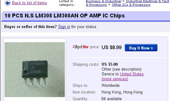

              • LM308
                You can buy on ebay. There is a great lot of LM308. Be sure of the payment method accepted by the buyer. 10 for US$ 9 + shipping cost US$ 5.
                http://cgi.ebay.com/10-PCS-N-S-LM308...QQcmdZViewItem
                • Originally posted by dino View Post
                  Reagrds Dino
                  here you can see the latest corrections I've made. Yes the 3k3 on schematic is 3k9 on PCB, the right value is 3k3, though if you use 3k9 circuit works too, as porkluvr stated.
                  About -5... actually is -6.2 .. -6.4 with original components. If you use different that use more current you have a decrease... but voltage converter in GSabre is more efficient than e.g. Bandido due to the higher frequency...f/2 means 7Khz and more, so it's not a problem e.g. having some little current waste of few mA more due to diff. components.
                  You'll lose -V rail if disconnect coil: normal. It's so cause you'll lose oscillations so f/2 frequency input signal at 4024.
                  Follow schematic values and will be fine with it.

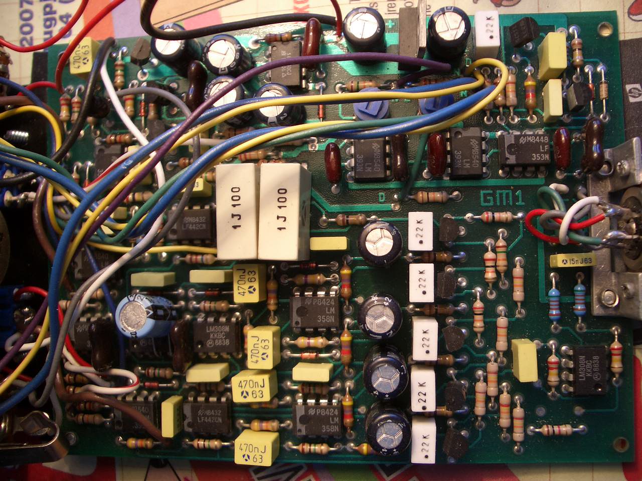

                          • king cobra. right side.
                              Hi kt315,
                              have you noticed that components are really similar/equals to tesoro Royal Sabre ones..?
                              Even TIS75!
                              Kind regards,
                              Max
